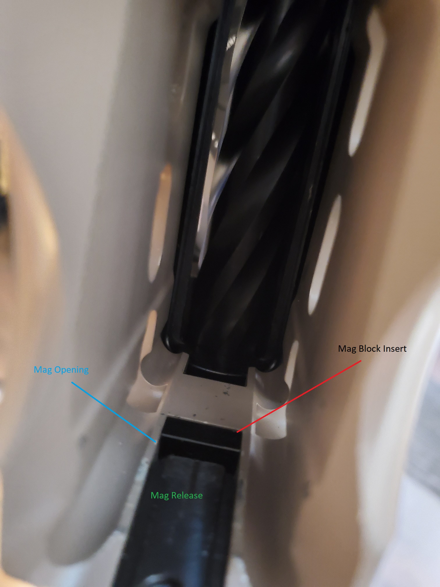

Regarding AICS and upward pressure:
  • All AW cut actions leave metal at the front of the mag opening to prevent the narrower AICS mag from over-inserting. With your current set up, when you apply pressure to the AICS mag, the back-end is unsupported and binds against the bolt. The action is stopping the AICS up front, but nothing is stopping it from the rear.
  • Some chassis/stocks will not have this issue as their mag catch opening is smaller and stops AICS mags from over-inserting.
  • For example, I run my Curtis in an MPA chassis. With an out-of-the-box MPA chassis, I experience the same issue- binding against the bolt when applying pressure on an AICS mag.
  • MPA sells a little insert that reduces the size of the mag catch opening. This blocks the mag catch and prevents the magazine from over inserting. With this insert in place, I can now apply full weight of the rifle against the AICS mag and no binding.
  • I've attached a pic to illustrate. (it's not the greatest pic but hopefully you get the idea)

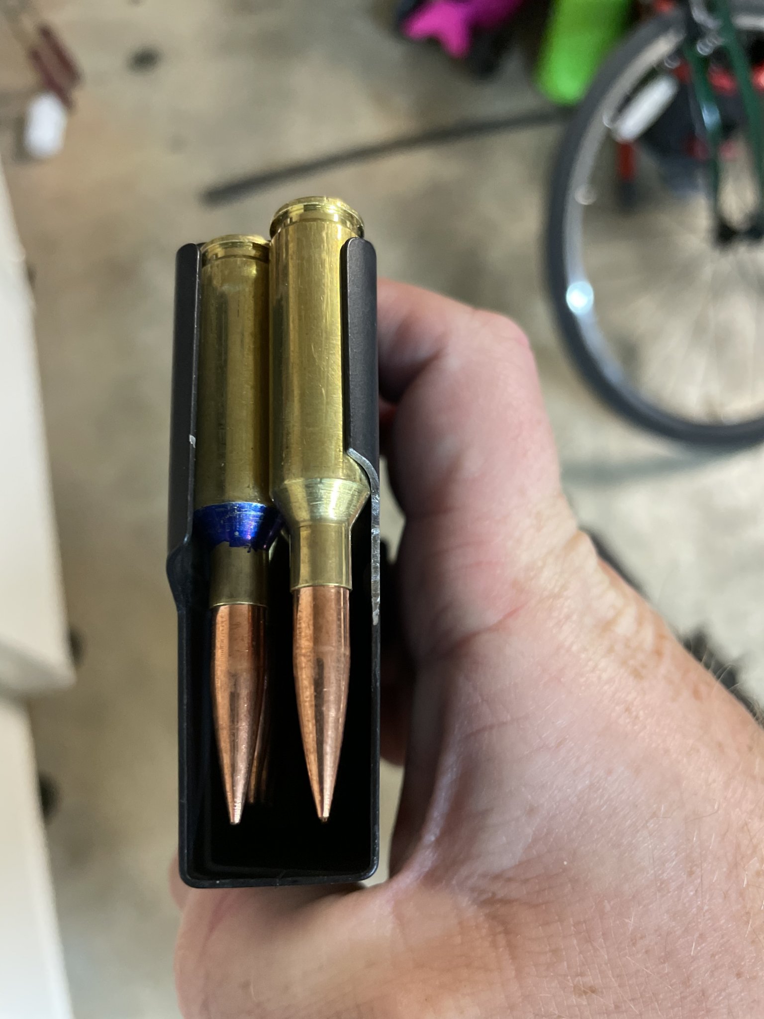

I know this is an old thread but I’m running into the same thing on a different action. This never happened on my deviants because the feed ramp is narrower and kicks the round out of the feed lips prior to the bullet hitting the side of the chamber counterbore.
I’m still working on solutions but essentially we need the round to disengage from the feed lips sooner. So there are 2 options... cut some of the left feed lip off or widen it out.
In the picture I trimmed about 1/4” off the left feed lip with a cutoff wheel and it is feeding that round reliably. This mag has a little too much taper toward the front on the feed lips and the rounds will not seat firmly in lips (they rock). So occasionally the bolt will slide over the top if the back pitches down. Need to get my feed lip tool back from a buddy so I can slightly tweak and get the rounds to make firm contact along the entire lip.
Hope this helps!
