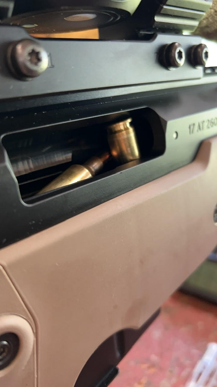

I'm running 6br on my AT using double stack AW mag + HRD 6mm spacer.
The mag runs fine for the first 5-7 rounds, but then it just keep screwing up like this for the last 3-5 rds :
not enough spring tension left for the last few rounds might have caused this feeding issue, I don't know..? Also, I'm using108 eldm and 105 berger hybrid for my 6br loads. I tried to lube the inside of the magazine but it didn't help. any idea how to fix this?

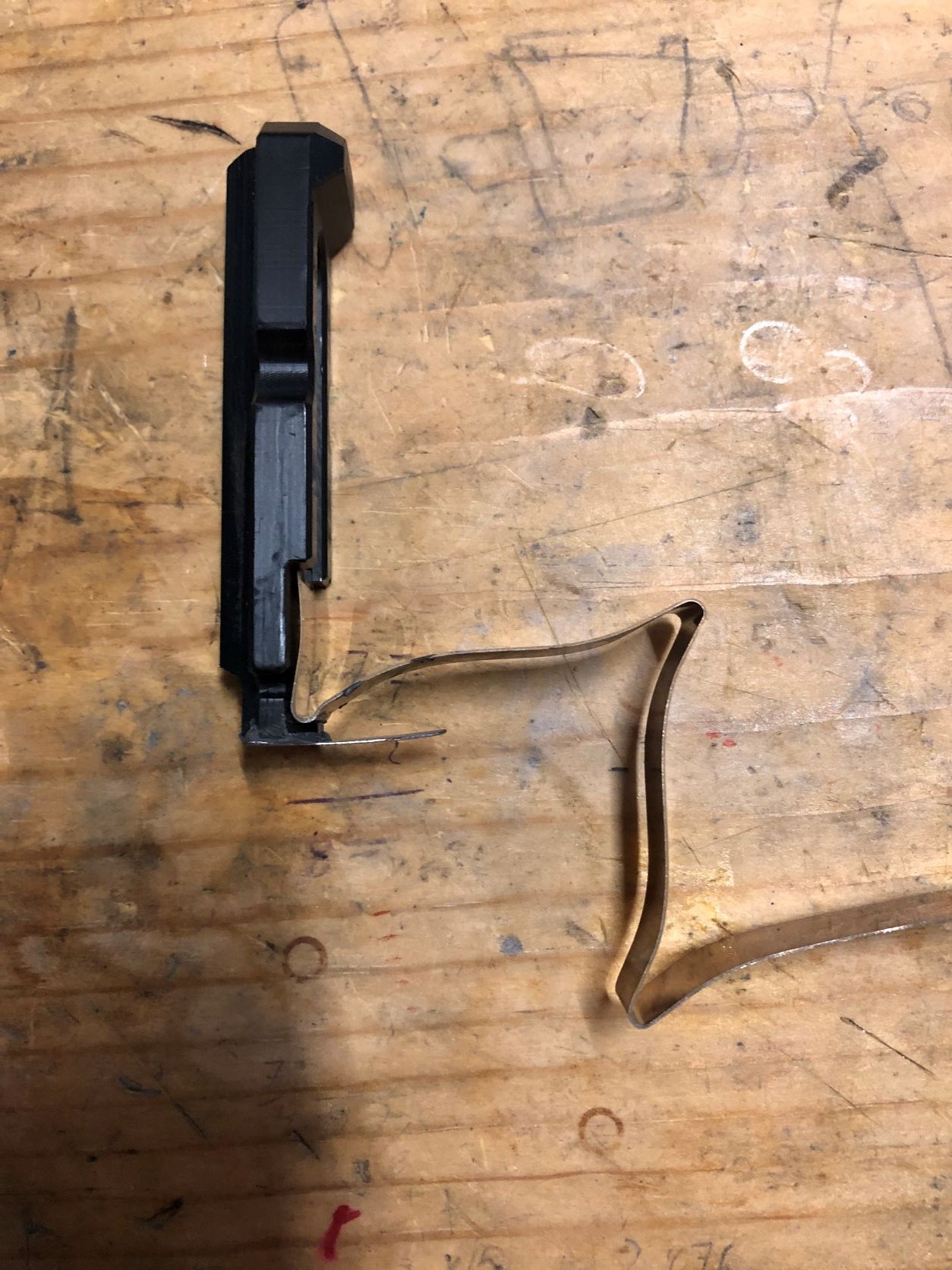

I had the same issue, I ended up JB welding a piece of sheet metal to the back of the follower to make an anti-tilt like an m4 mag. Tried the feed lips, pulling the springs - nothing else would stop the nosedive.

Any chance of pics on that??? How thick sheet metal and where exactly?

when I run the bolt fast, I do get the nosediving. It works fine if I move bolt slowly but I still don't want any incident during a match

I’ll grab a couple pictures later. It’s a real redneck engineering solution made from frustration, not my finest work.

It's a piece of .020" scrap metal. I think the first test was a beer can, but I didn't use enough JB to hold it in place during use. I ended up taking a bit off mag spacer channel with a file to make it fit and run smoothly. The funny shape is so you can tilt it between the feed lips to reinstall. Feeds 100%, no more nosedive.
