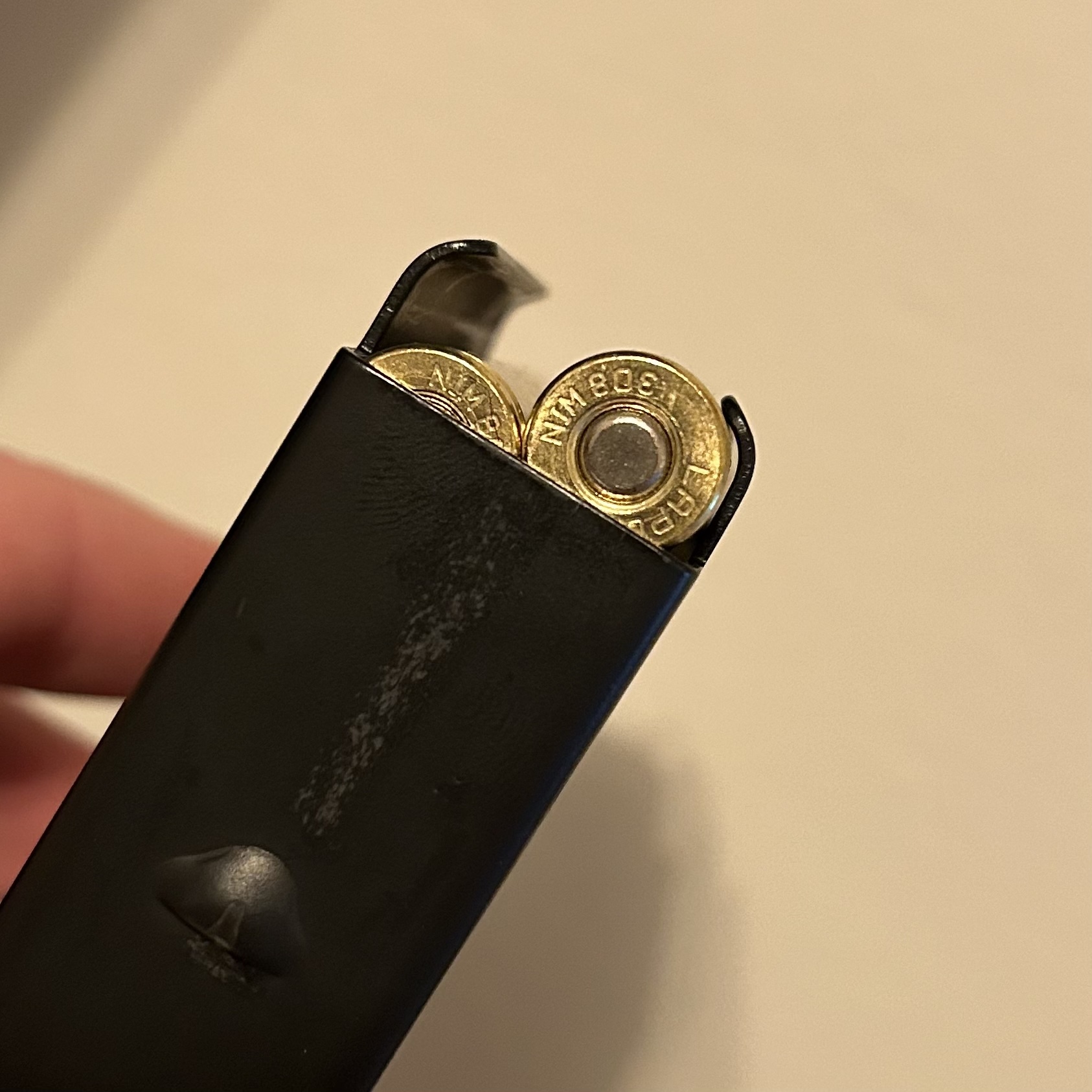

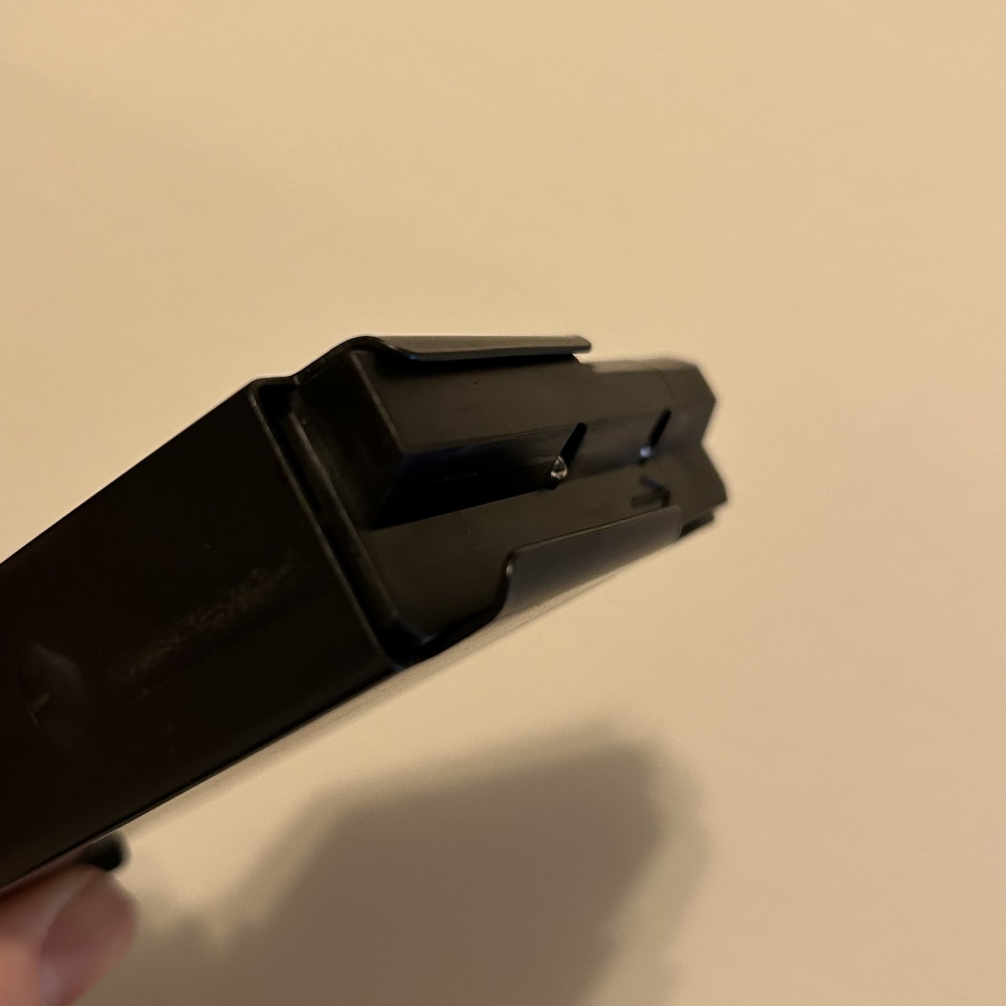

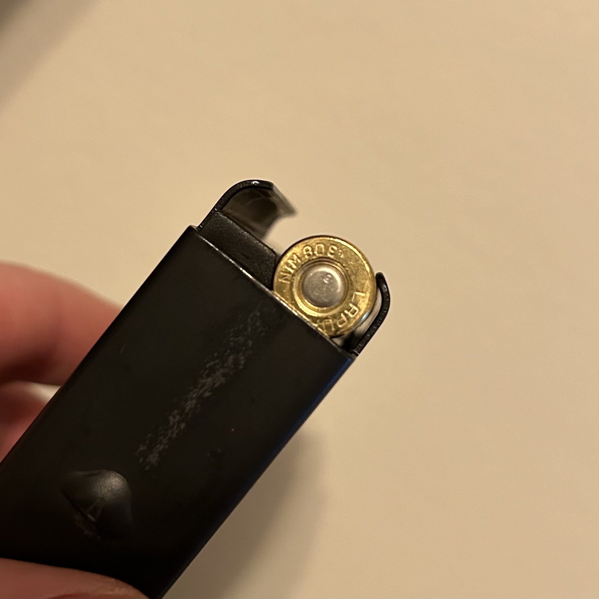

On further inspection, it's pretty obvious that the two pins holding on to the mag spring are protruding out of the follower, and the problem child round is actually not flush with the follower but instead sits on the pin and makes a different contact with the feed lips. There's a visible difference in the seating of the last round vs any of the rounds that don't make direct contact with that piece.
Both of my magazines display the same protruding pin, making me think it's by design and not a one of QC issue? Is this a known portion of the magazine that people tune?
Any advice on how to proceed with this would be greatly appreciated - I love the smoothness and overall compactness of AW and don't want to go back to AICS, but obviously the last round jam is unacceptable.
Wow, so I guess it is just a QC issue! Little shocking that both magazines would have the same problem, but I guess once a machine is out of spec...
2min with the Dremel and the pins have been shaved back and it seems my feeding issues are resolved (at least with snap caps, we'll see how it does in the field).
