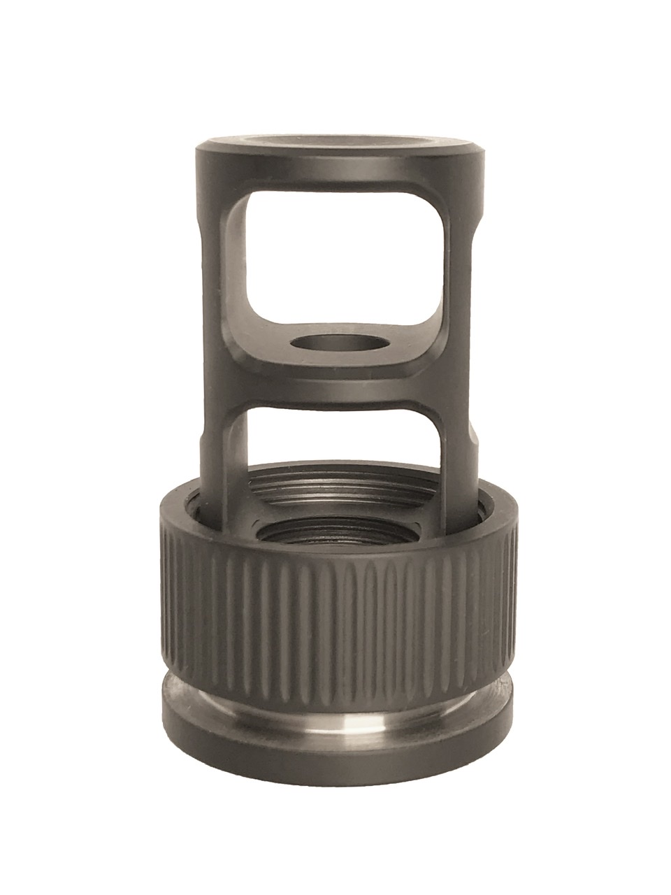

I have a AWC brake and would like to find a way to use my 1.375x24 threaded suppressors with it. Does anyone make a 1.375x24 adapter for use with the AWC PSR brake? It seems like there is ample room. Any opinions or experiences would be appreciated

All of my suppressors use either the Plan B mount or TBAC CB mount. I just like the concept of the AWC and the 1.375x24 fits over it. With an adapter It seems that it would work great

Whats the external thread pattern of the brake?
1.375-24 is like an industry standard now, there are tons of adapters for such.

I don’t know the external thread pattern. How could I measure that? I don’t see it specified anywhere on their website.

Thread gauges would be the easiest. Or, you could measure the major (outside point of the male thread), then you would have a diameter. Could guess at TPI by measuring what you have for threaded length, and counting the threads within the measured length. Then try common nuts. Im surprised they don't list the spec of the thread protector.
