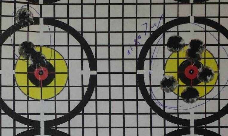

    Well I tried again yesterday with a couple different variations and nothing worked. It grouped at around 1 inch, like every other Damn charge I put through it.
    That's a 3 round and 6 round group. As seen from the 6 round group, no vertical or horizontal stringing that would signify a problem. Just plain old 1 moa random variation.
    I'm thinking it might be that this rifle just does not like this particular combo of parts. I bought some factory Hornady match ammo to try and some 285gr Hornady bullets. Loaded up an OCW window new bullets and will be running it today.

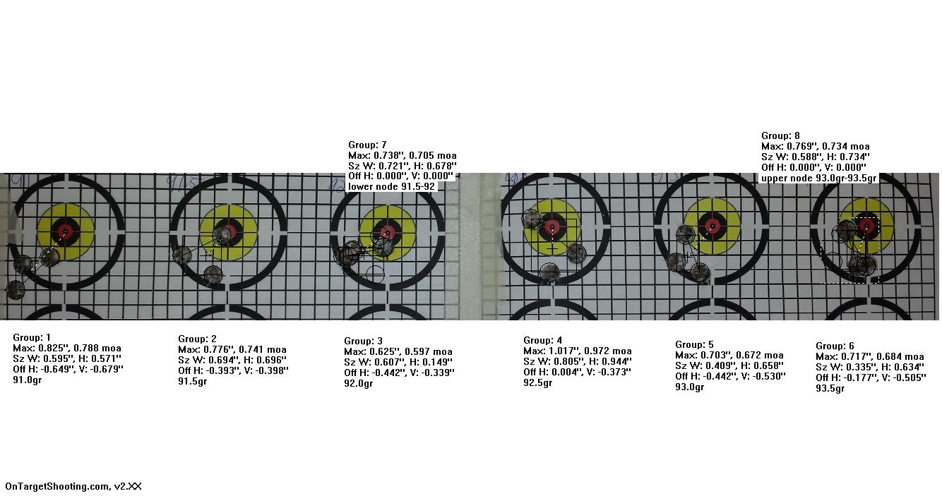

    Well I went to try out the 285's today and what a relief, success! I did a ladder from 91gr to 93.5gr and here are the results.
    To be honest, they all have about the same POI, so thats great news. It does seem like 92.5 is a scatter node though because the group really opened up, and the group right before it is one of the tightest (generally signs of a scatter node)
    The group 7 text is superimposing groups 2 and 3 together and group 8 is superimposing groups 5 and 6 together. Less than 3/4 a moa over the entire grain with 6 shots and thats before even playing with seating. I would call that not bad!
    So now I have to decide whether to go with 92.0gr or 93.5gr. Any suggestions? There didn't seem to be any kind of major pressure issues anywhere within the OCW range. 92gr was about 2870fps and 93.5 was about 2915fps. This particular chrono reads them a little faster than others though (generally knock off 20-30fps).The 93.5 had better velocity spreads though.

    I have not narrowed down nodes using .1 grain as of yet followed by seating depth.
    Chrony results:
    91.8 ~ 2755 (2760, 2760, 2743, 2754)
    94.0 ~ 2855 (2855, 2855, missed)
    94.3 ~ 2874 (2892, 2873, 2873)
    05.02.14
    Temp: 64F
    DALT: 1016-1119
    Alt: 515'
    Pressure: 29.19
    HUM: 38.4
    DPOIN: 40.0-40.2
    WETB: 52.0
    MOST CLOUDY
    I am hoping it is decent weather so I can hit range this weekend to continue Load Development. Rained hard last two scheduled range days.
    Other two loads:
    300 SMK and 300 OTM
    Retumbo
    215M
    Lapua Brass
