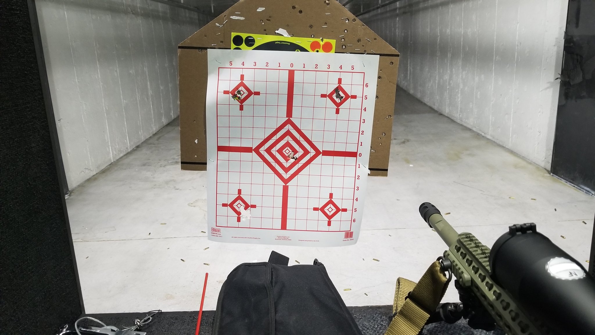

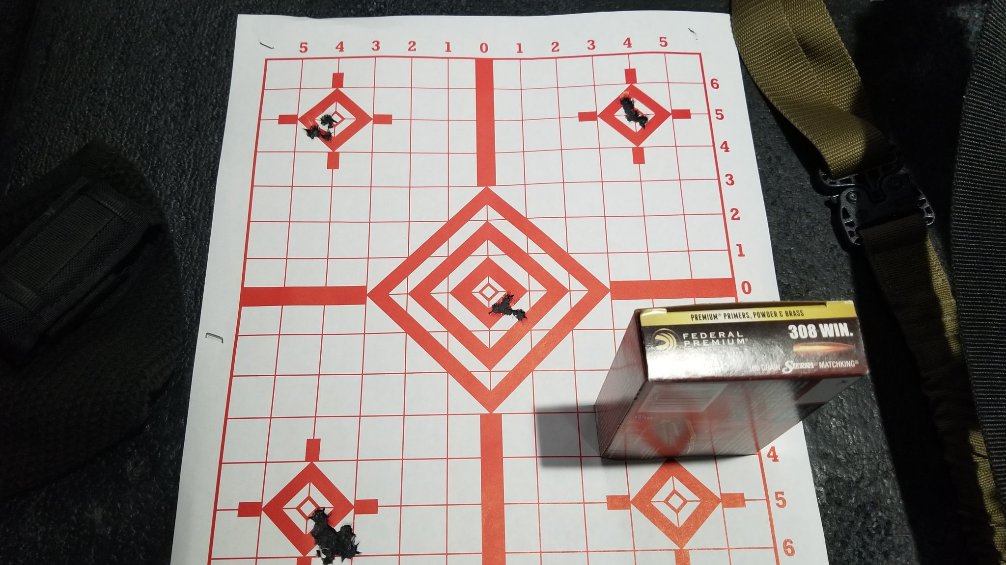

Here's an AXSA running 1/2 MOA with FGMM 185gr on four 5 rnd groups.

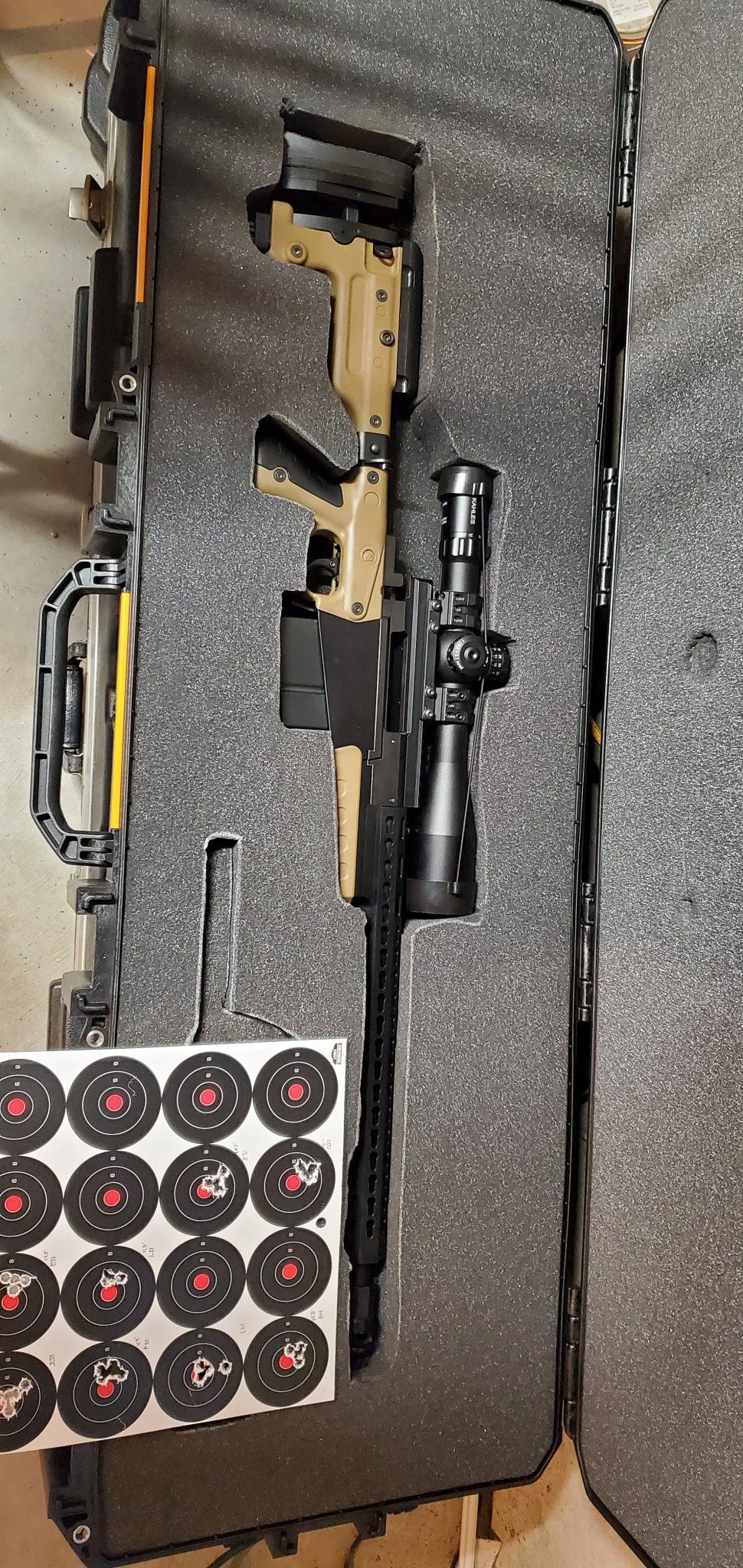

I'm not sure what you guy's are doing, except maybe you're just getting into shooting ?‍♂️, but only after 4 shots on a brand new barrel, my AT was smoking out 1/4-5/16 groups, with factory Hornady 168-178 match. And that day I was in a hurry to get it on paper so I could take my momma out to dinner....and that was at 200. AI's are bar none, top tier, crazy accurate factory rifles
Start shooting more ?‍♂️

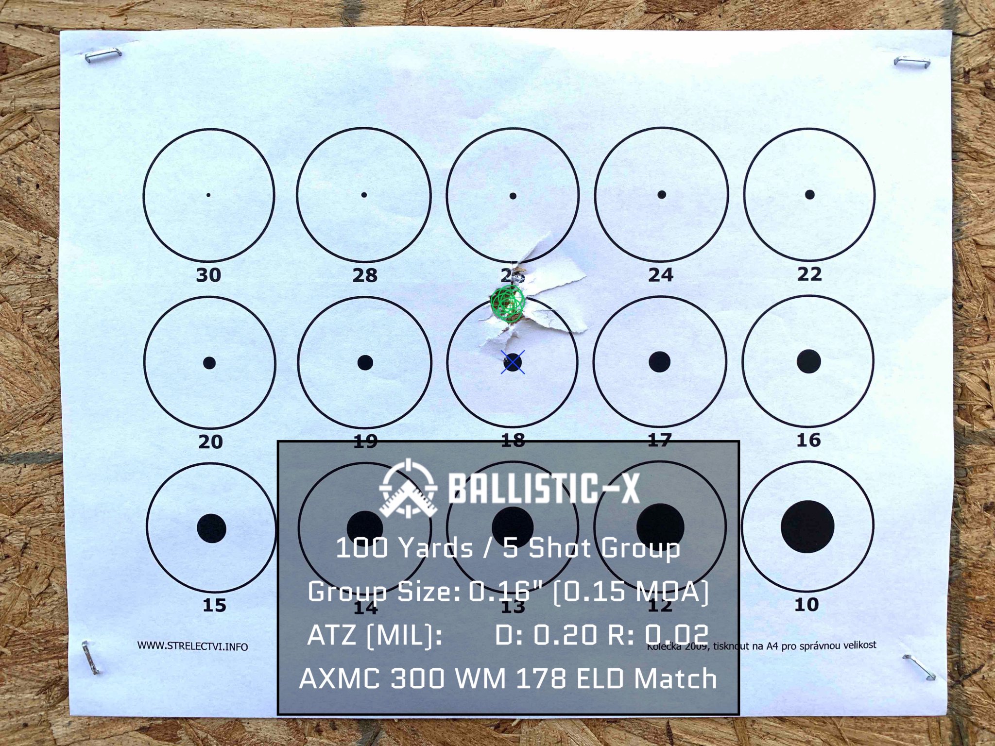

This is the first five rounds I fired from my .300WM barrel, which had 400 rounds on it when I got it. I was shooting Hornady 178 gr. ELD Match at 100 yards. Not only is that the best group I’ve ever shot with my AXMC, but that point of impact represents the offset from my .308 Win. zero. I was amazed. It’s still the best shooting barrel I have. I very rarely shoot groups, and I don’t shoot .300 WM very often, so I don’t know what the average group size would be at 100. At distance, it’s usually sub-half minute, and if it’s not, I know it’s not the rifle. I said all that to say this; I would get a known competent shooter, with magnum experience, to evaluate the rifle.

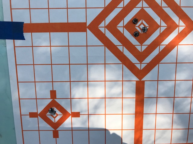

1) I wouldn't shoot for groups using a monopod, especially on a magnum. Switch to a good rear bag.
2) Recoil management makes a big difference with a magnum (see #1 above). I shoot an AXMC 338NM a lot, and if I get lazy on recoil management it will show up in group size. I can tell by how the rifle reacts and where the crosshairs go during recoil whether or not I'm at
fault. In the pic below, I was rechecking zero with a known-performance handload. Six shots, back to back. The first three at the center bull did not meet the proven performance level of this load, but I could tell I was not managing recoil well even though the zero was pretty good. So, I completely rebuilt my position on the bench, slowed down, and concentrated on fixing my fundamentals. The next three shots at the lower left bull show the difference. 0.657" vs 0.115".
Disclaimer: Yes, I know they aren't 5-shot groups. I was only checking zero, not load testing (it's a known and tested load). But the point isn't to demonstrate or brag on the rifle's performance here, but rather to show the difference that identifying and fixing your faults can make. The problem here was definitely not the rifle or the load. I shoot 338s extensively but anyone can get lazy or have an off day. Experience with the rifle allowed me to feel and see that I was letting the rifle exploit my weakness in position. You have a new rifle that you aren't as familiar with, so it may be more difficult to identify until you get more time behind it. Plus, I think the monopod is an added challenge that you don't need to be trying to overcome when you're trying to establish load performance right now. It is likely skidding/chattering on the bench surface during recoil (if you're on a bench), and regardless it doesn't have the lateral stability of having the toe of the stock bedded down into a good, solid bag. Try a good rear bag instead, and concentrate on fundamentals of recoil management, being brutally honest with yourself in your assessment of what you see happening through the scope throughout the recoil impulse. If still in doubt, as already suggested, let someone else with good magnum experience give it a whack.
