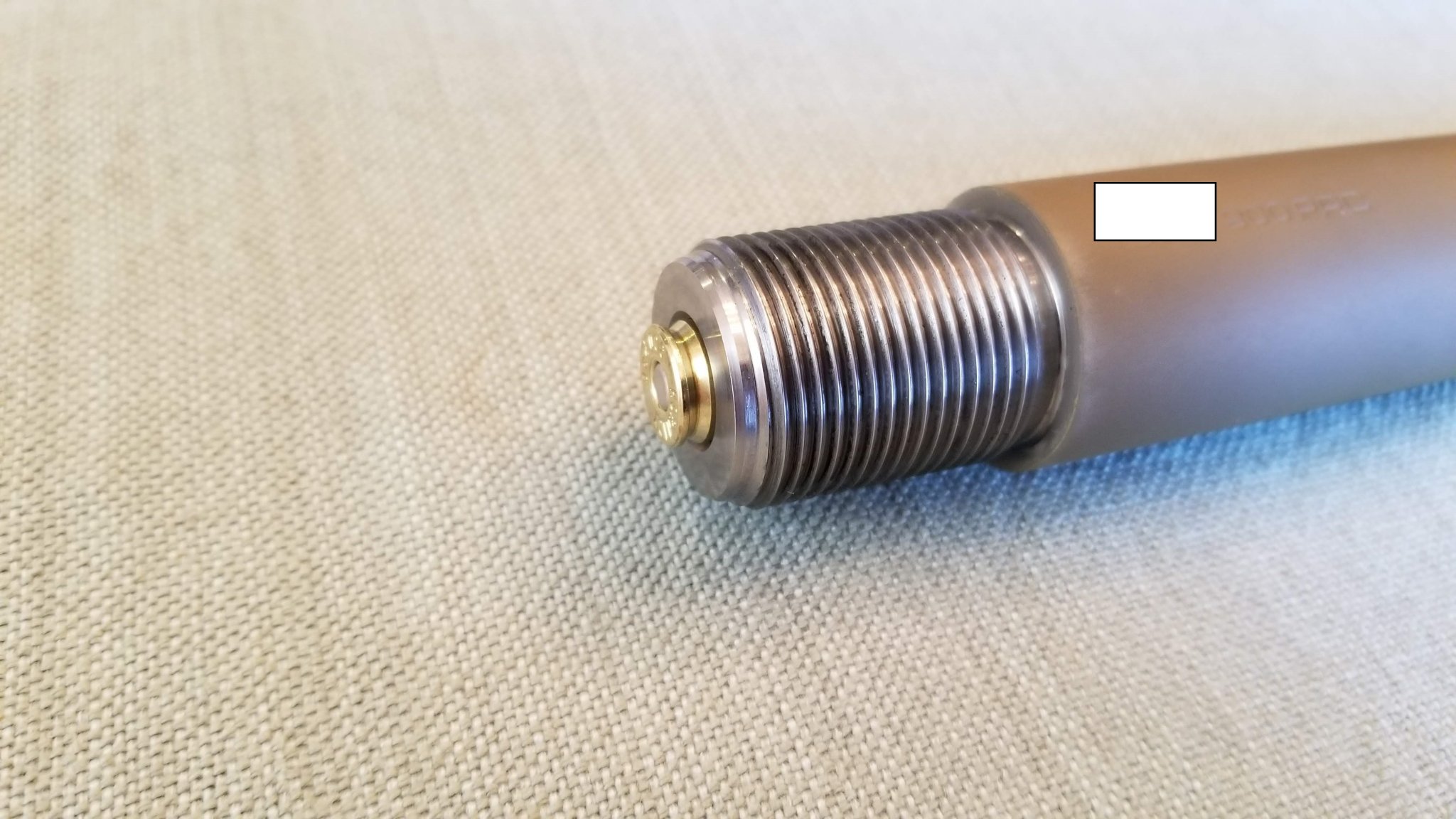

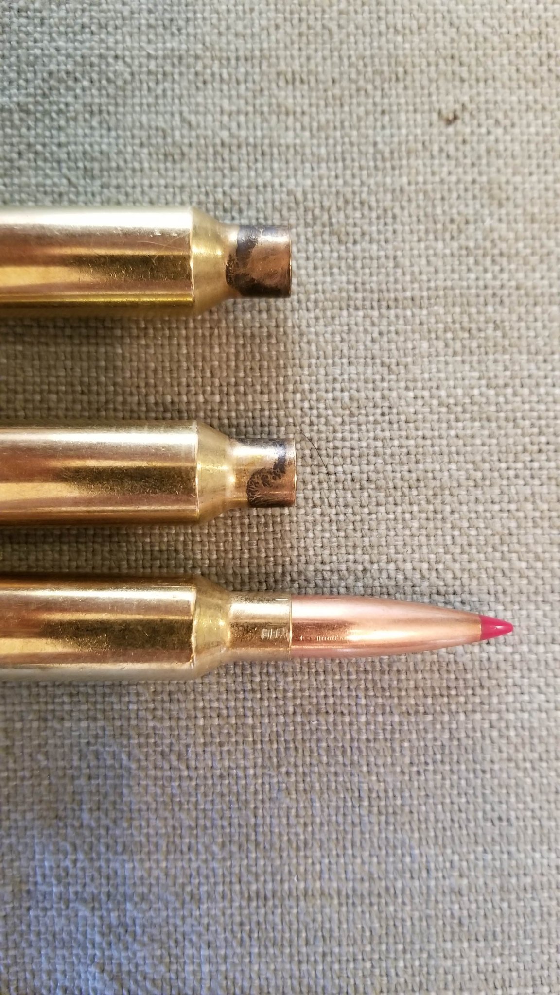

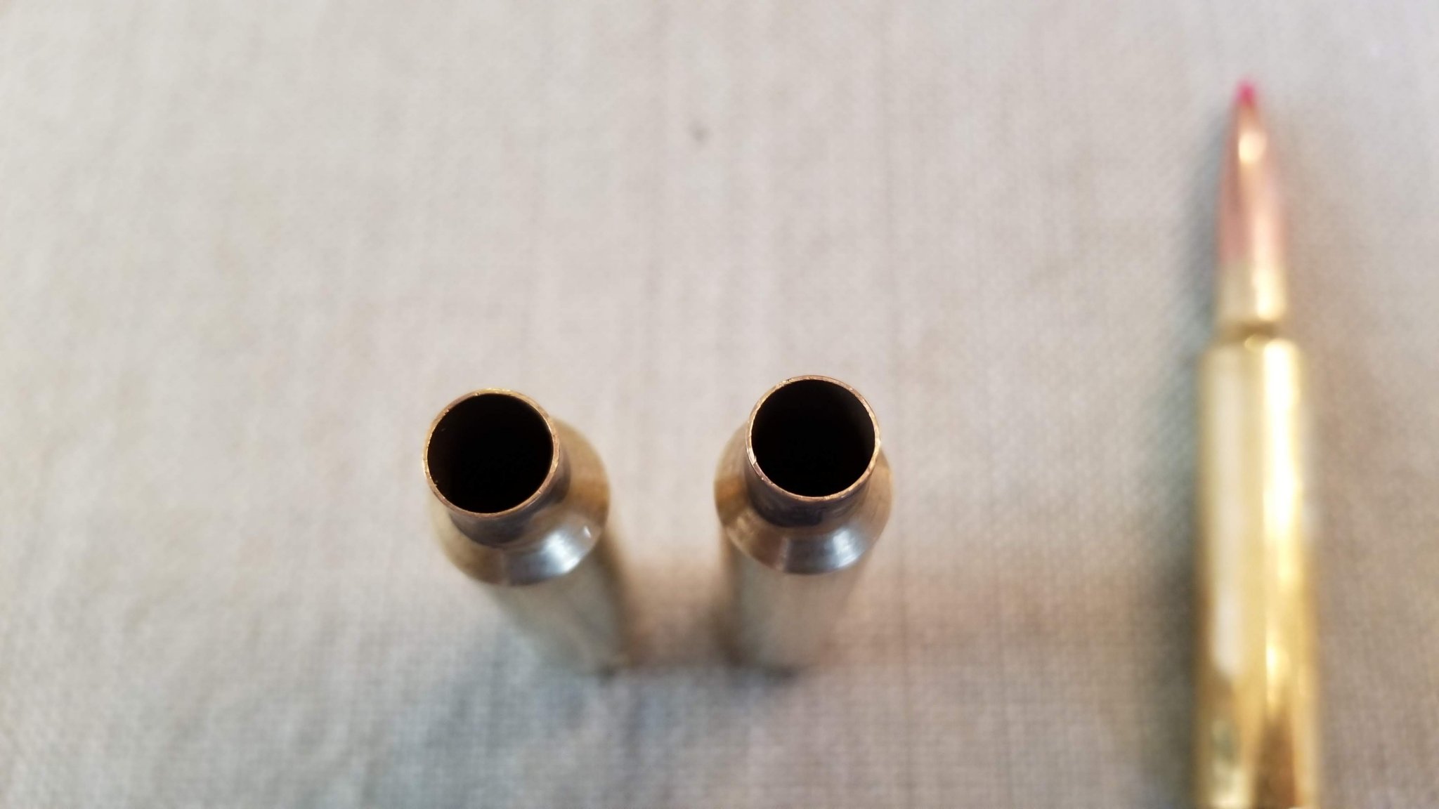

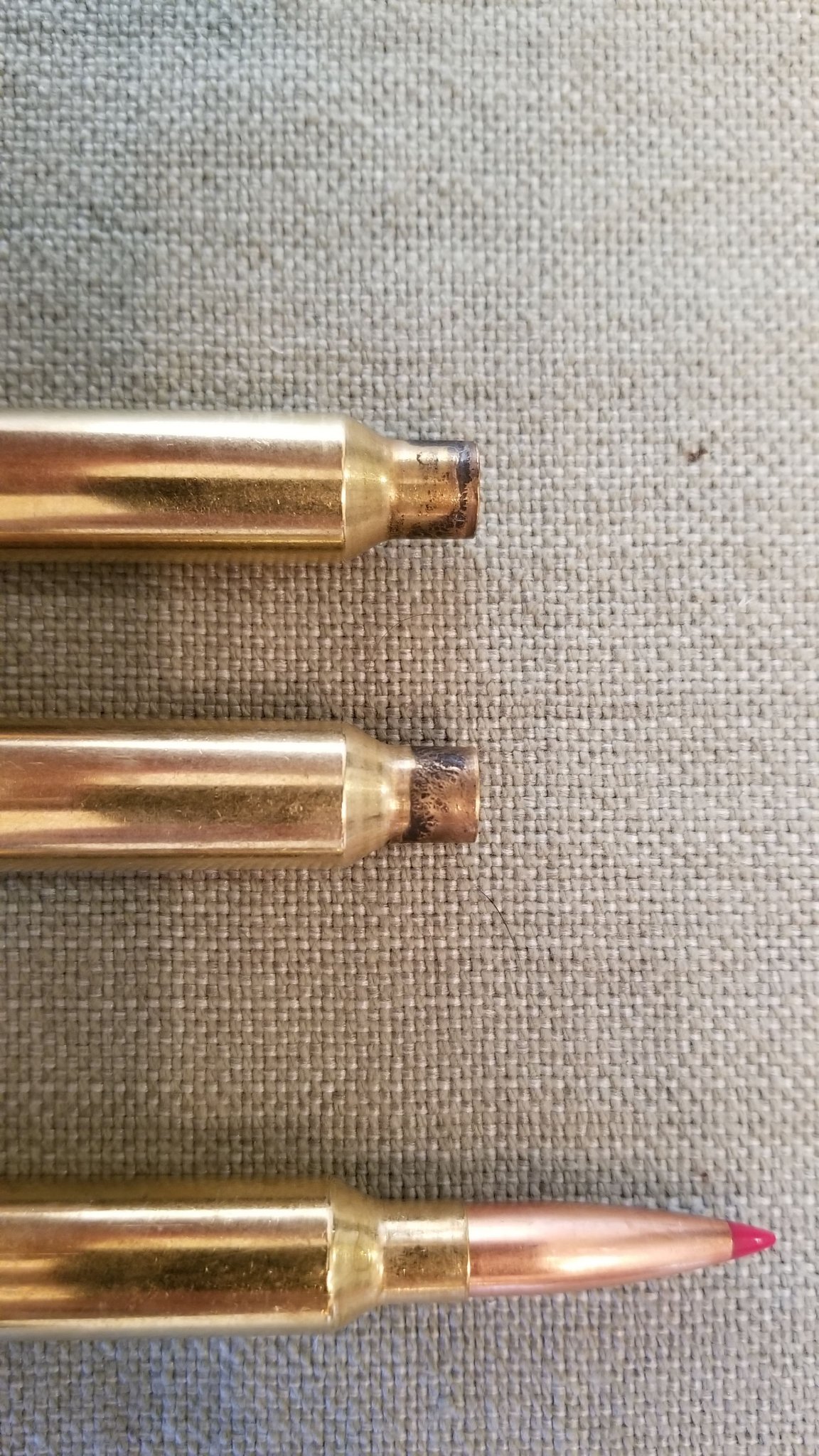

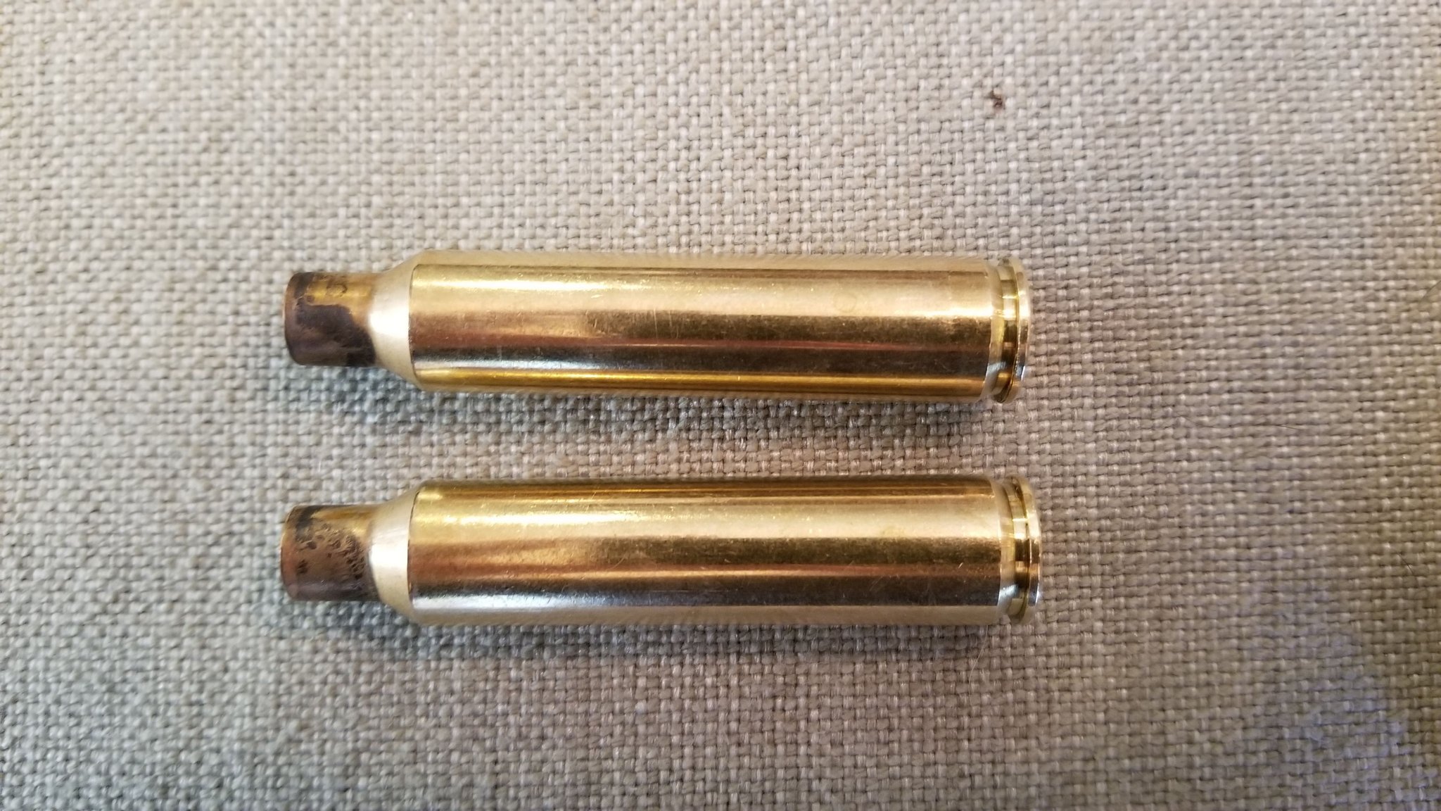

Got a custom 300 PRC barrel built for my AXMC. finally got around to taking it out today to shoot. it was extremely tight when trying to chamber a round. I hard to push down hard to get the bolt down. I had a well known experienced ELR shooter look at it, and we put two rounds through it but have some interesting marks on the brass. doesnt seem unsafe to shoot, but i think i will have accuracy/velocity problems. When the barrel is out the round seems like it fits in very nice. Any guesses on the problem? I plan on taking it to a smith this week.

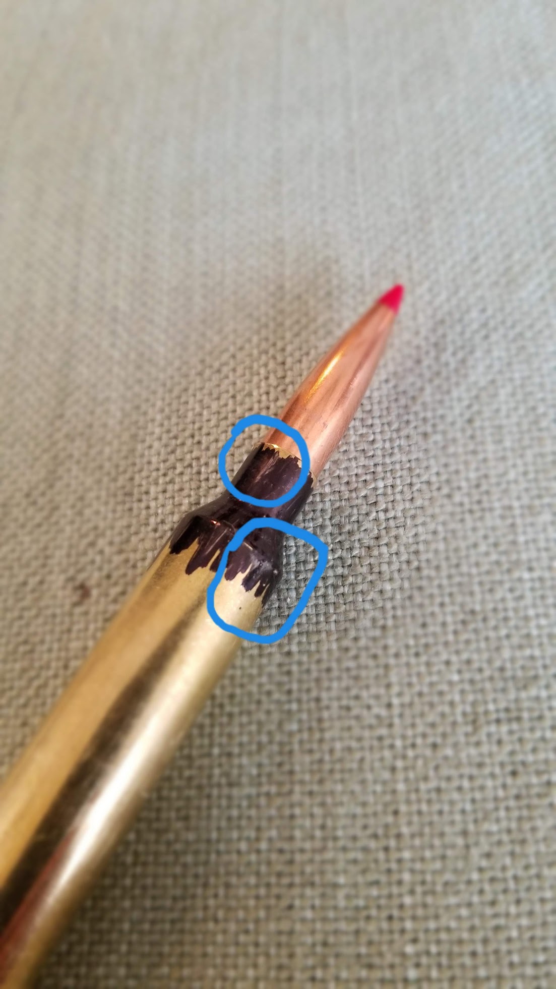

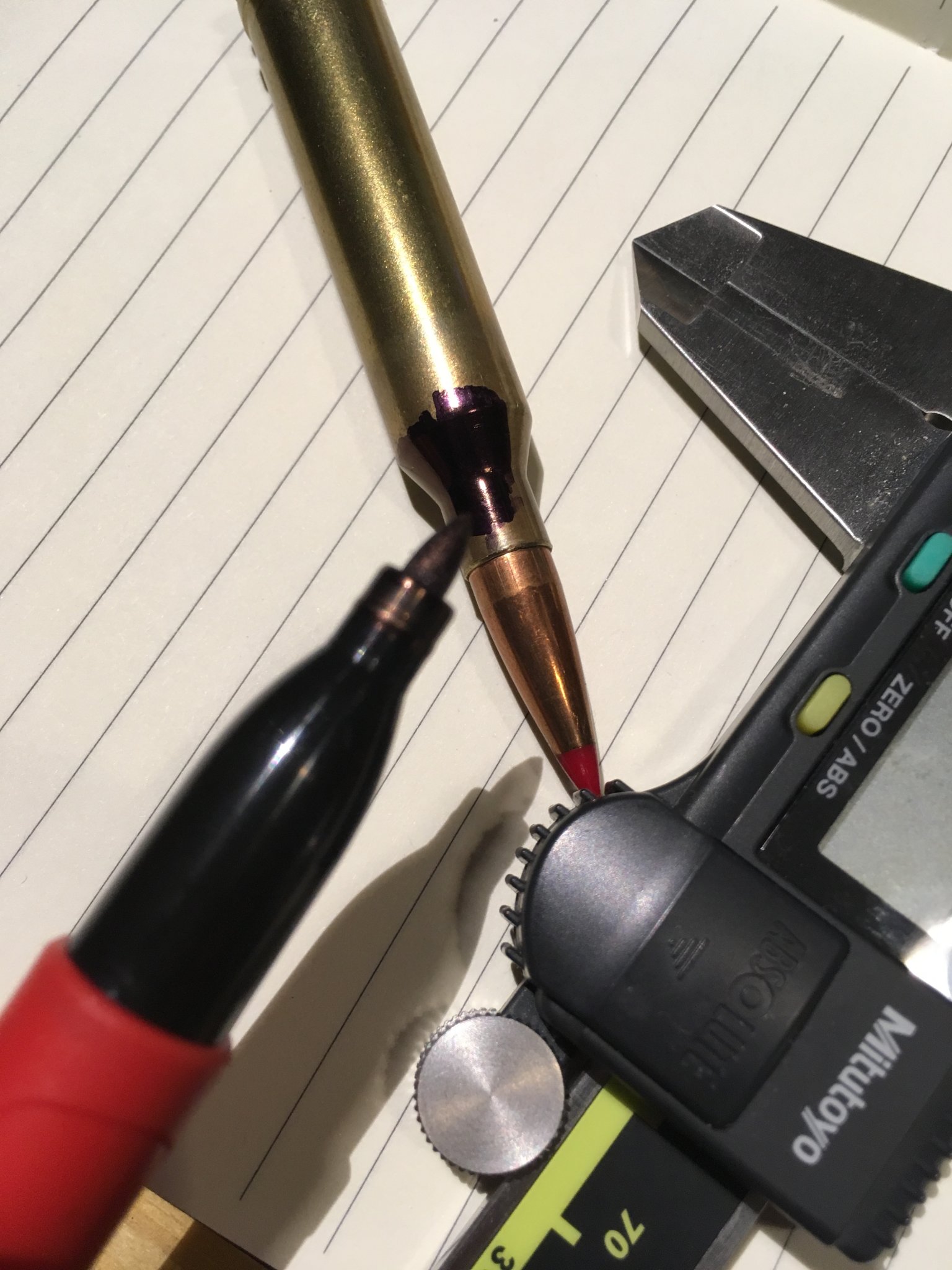

Color up a tight fitting piece of brass (Sharpie), close the bolt on it and then look for the witness mark on the brass after extraction. This could tell you if it is minimum headspaced and you are just dealing with wide variances in hornady brass. If you are using factory loads , color the bullet too; if there is a witness mark on the bullet, then you have another problem.

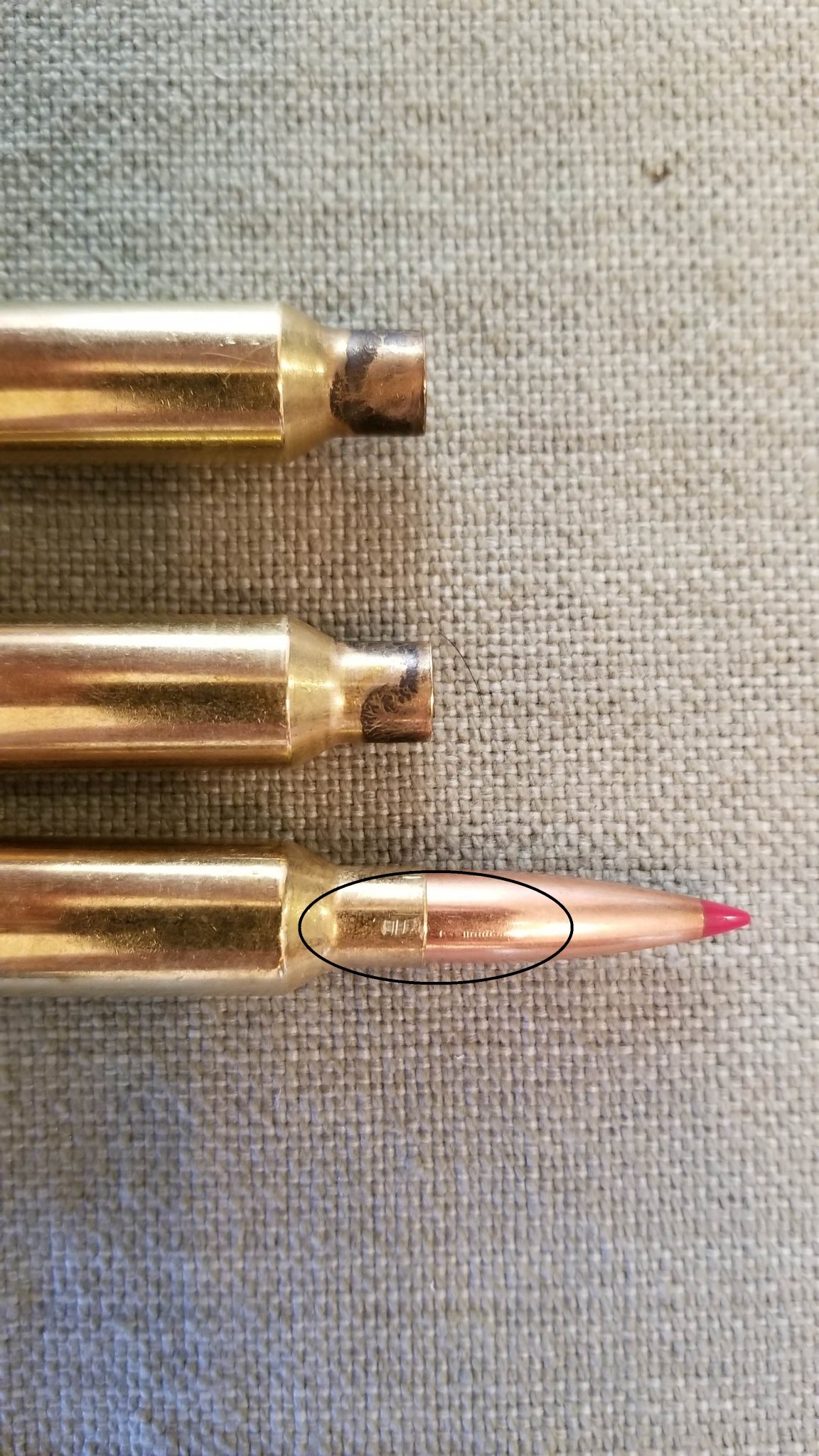

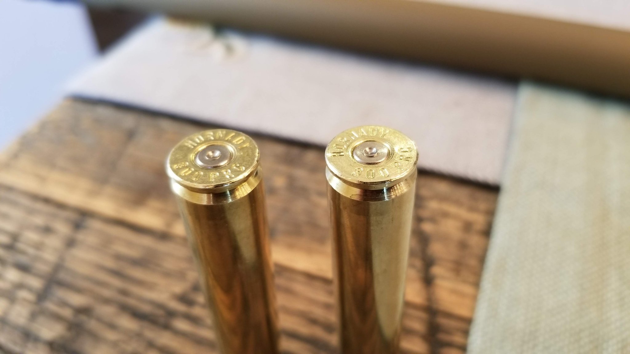

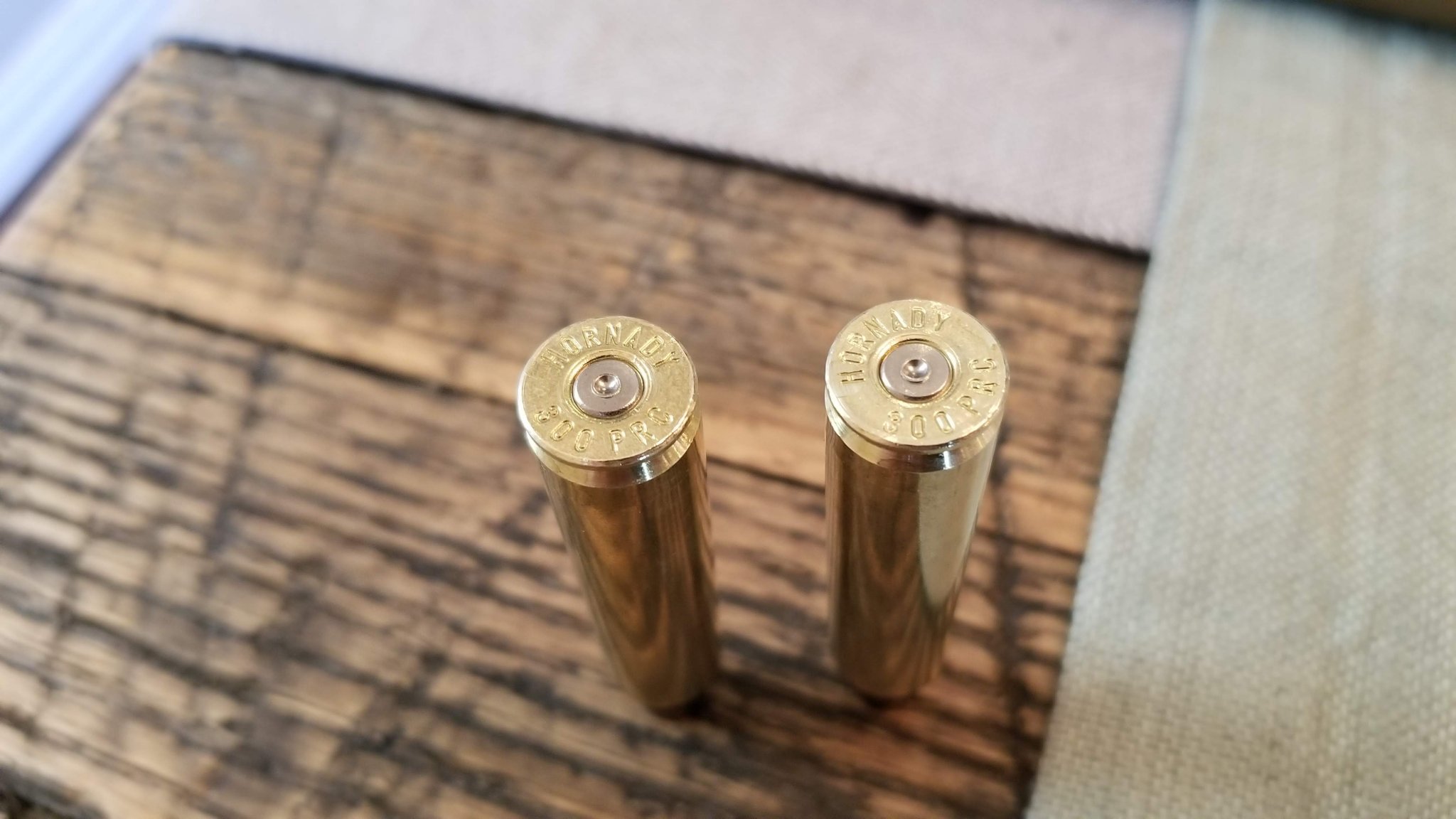

these witness marks?
Wish we could help there by watching the video but it doesn’t really mean much, unfortunately.
Top two images: nothing to be alarmed about. It’s simply the gas coming around the necks of the case. What you wouldn’t want to see is that gas going down the shoulder.
Bottom image: That just looks like a feed ramp mark, or a random blemish from the factory. It’s not radial so it’s not from caming over.
You should try the suggestions that I made, as well as f>b25 and let us know the results. Got to start somewhere! I doubt the OAL on factory ammo is too long but you never know.

It’s probably just headspace. Prior to chambering my barrel, I measured a bunch of virgin PRC brass. Every single piece was longer than the go gauge by .0015-.002. In a minimum chamber, they just don’t fit. I chambered my barrel accordingly.
If you have a depth mic, measure from the face of the action to the bolt face. Now measure the length of your tenon(should be 1.499-1.5”), and subtract that from the face to bolt face measurement. That figure will be the max protrusion your case can stick out of the barrel. Then chamber a fresh round in the uninstalled barrel and measure for protrusion. If any of this is confusing to you, don’t bother with it. Let the gunsmith who did the barrel fix it.
Note the Sharpie mark. When the shoulder is marked, chamber and look for places where the ink is removed (witness marks). You may have to do more than the shoulder, but I would start there

It looks tight on the shoulder., but from the pic I don't think it's conclusive. The neck mark is likely just feed ramp contact under the pressure of the ejector, not an issue (cf AIAW's comment) You could unscrew your barrel a 1/4 turn or less and then try to chamber. If there is no camming pressure, then it confirms you have a chamber that doesn't like your brass. It is not necessarily your smith's fault, but you'll likely find satisfaction with him before you do with hornady. Keep us posted-good luck
