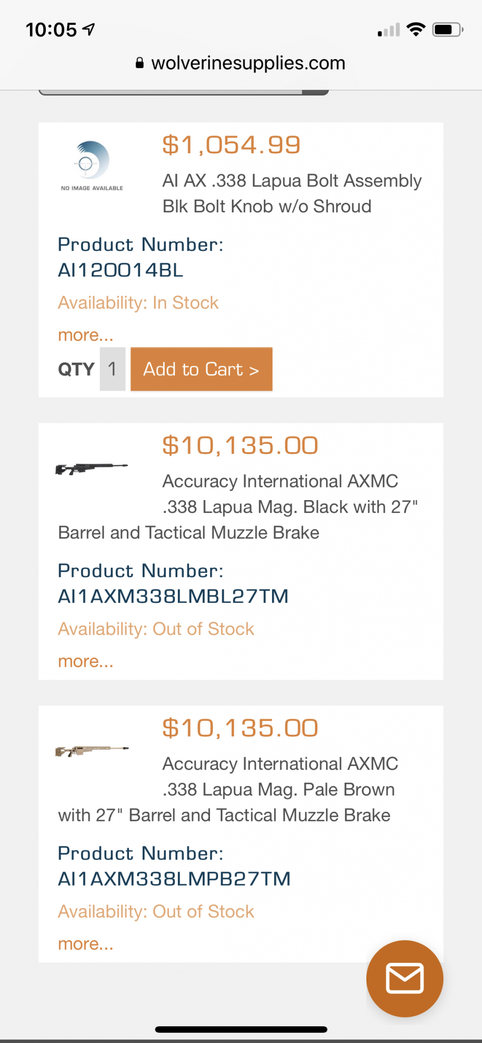

Hard to say, I’ve hunted in Canada a bunch, and every time I go there I stop in at the gun shops. Shocking how expensive stuff is. If he comes back and says a bolt from AI is $1500+ I won’t bat an eyelash. Last time I was there, I think vortex 2 razors were right around $4k Canadian, to give you an idea. This was in Manitoba.
Here’s a AI vendor in Manitoba.
Looks like 338 and 300 wm are same cost. E60AA4AC-48C3-4396-B7B5-D09EFB29B850.pngE60AA4AC-48C3-4396-B7B5-D09EFB29B850.png

From a price standpoint, get the .338LM and then just get the barrel, that would be your cheapest route to go with if all you want to do is .300NM
Now if you have any interest in shooting .300 WM then it might be worth getting the one with the .300WM setup and buying both the barrel & the bolt body for the .300NM
