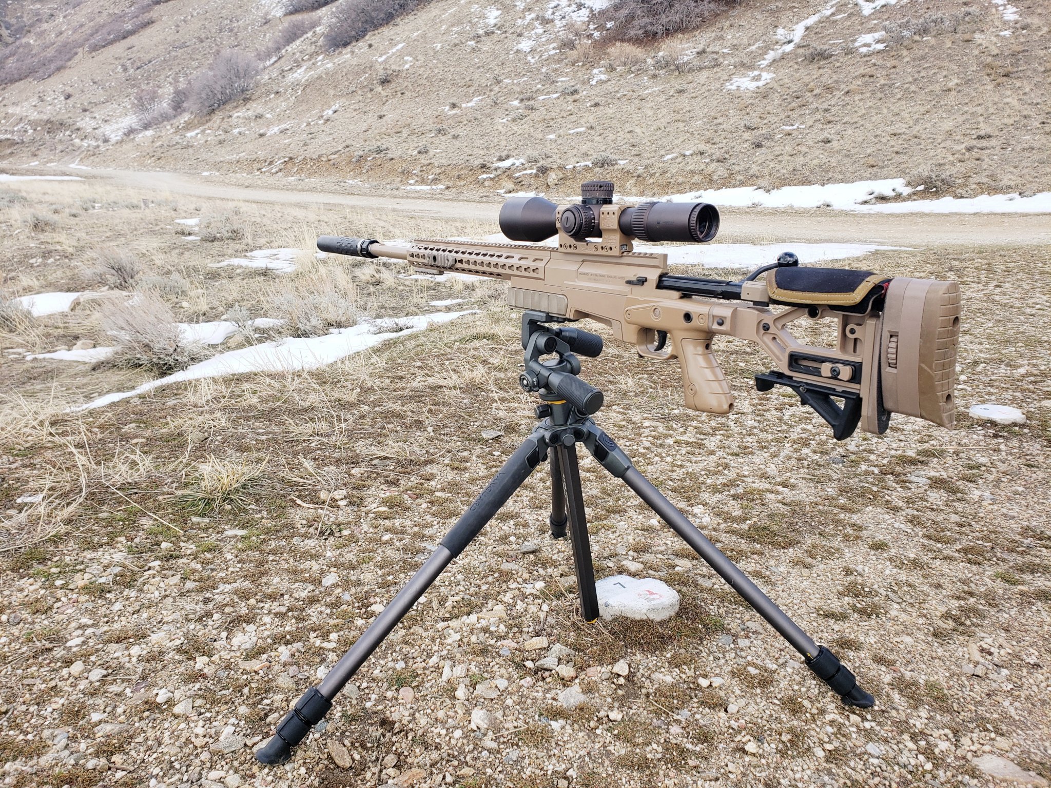

Put a Vortex Gen II 4.5x27 and it will make the weight! :ROFLMAO::ROFLMAO::ROFLMAO:
Hey don't talk smack about my rig guys lol....
