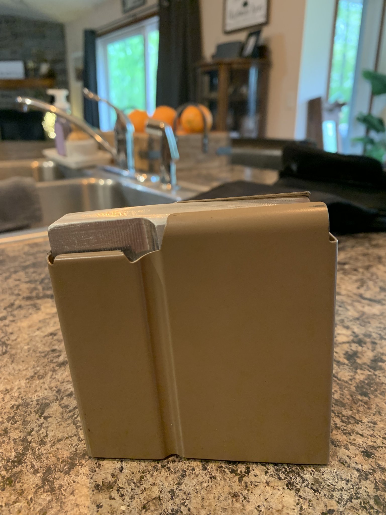

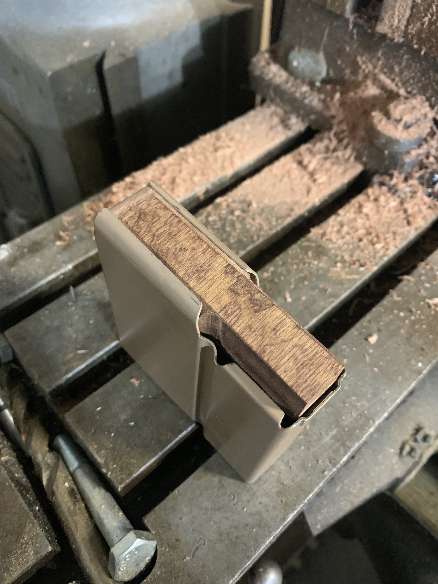

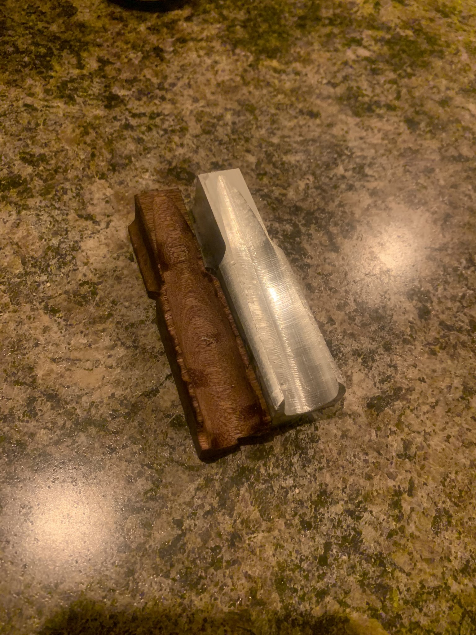

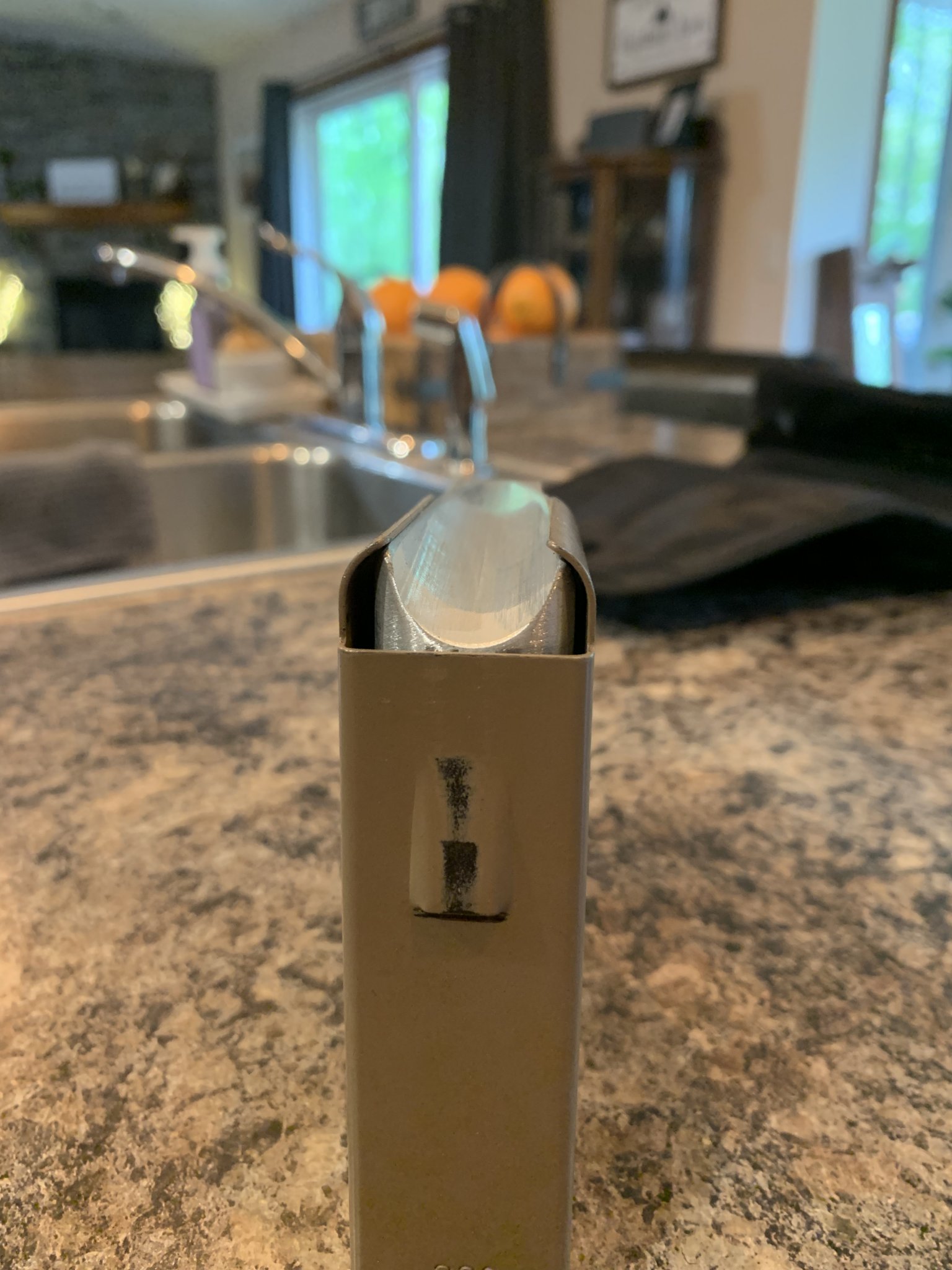

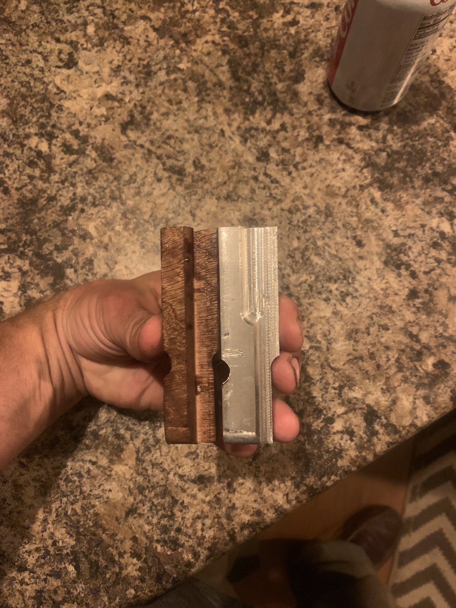

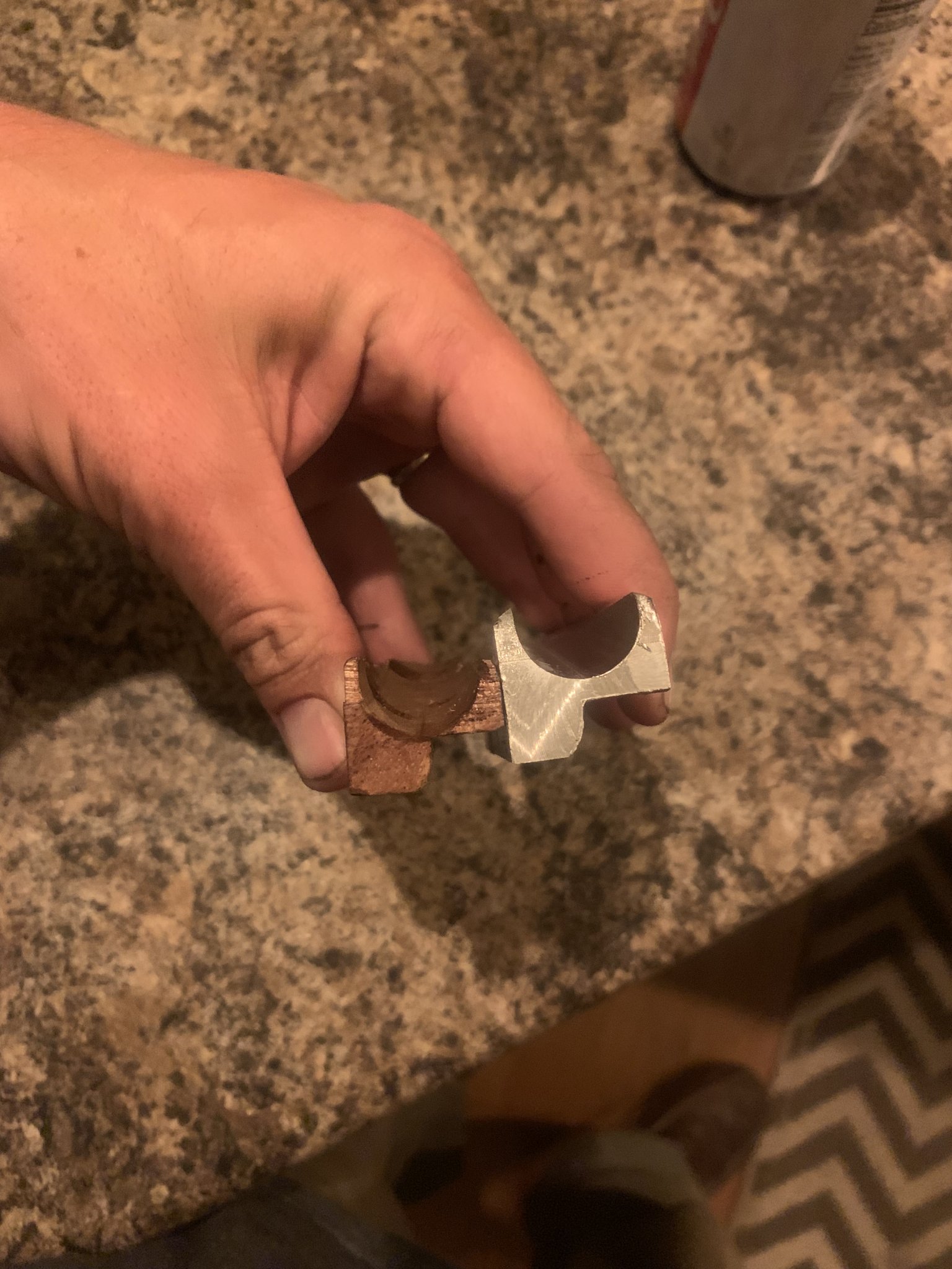

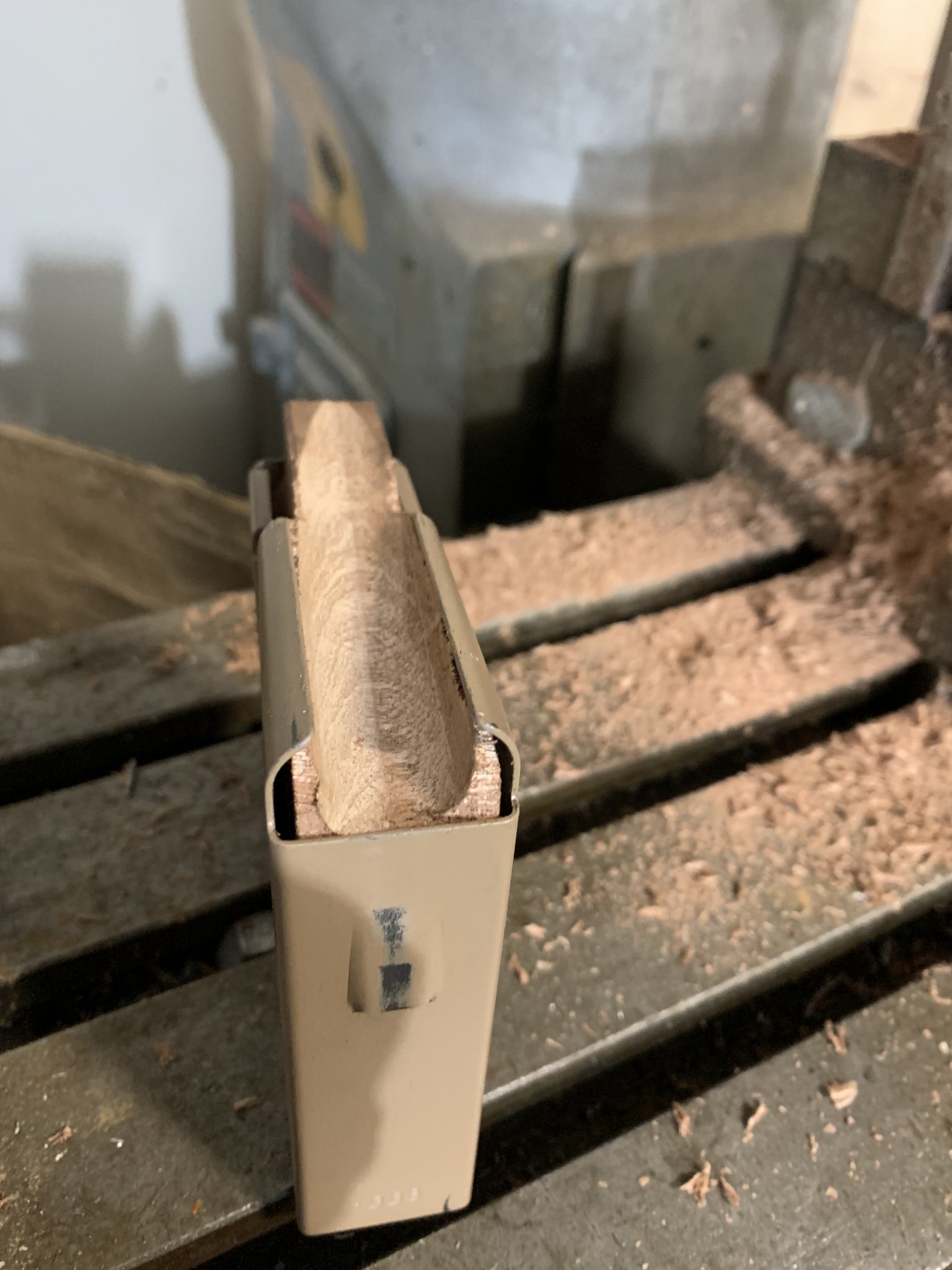

    So I had a member @Nik H say he wanted a single shot follower for a axmc. Apperntly, they don’t offer one. I mocked one up out of wood and got it about how I wanted and decided to make one out of aluminum. I’ll ship it off and see how well it works. A little rough on the finish but you’ll get the idea.
    I don’t really plan on making them. Mostly posted here for other guys looking to make one or have one made. It’s to insert into the top of the mag; so when the bolt goes over the front of it, it’s pushed down and out of the way. It’s set up to have the point of the bullet more towards the center of the chamber to allow the best feeding.

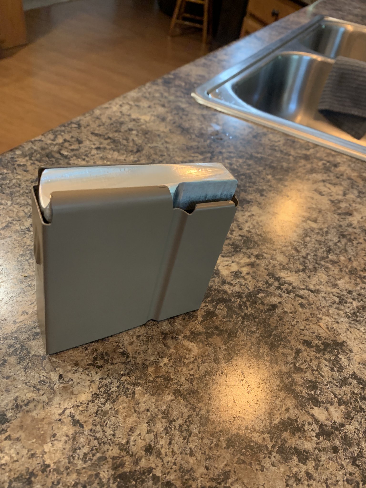

    Anarchy Outdoors sells a really nice single shot sled for the AICS. If I (or someone else) had a design for the AW or AXMC it could be printed in small quantities by the same shop that does the thumb rest and cheek piece. I honestly still don’t think there’s much of a market, but I don’t know that designing a full printed AW sled would be all that difficult.
    My only use for it would be the rare stage where every round has to be fired one at a time, like the shoot-one-round then run and get one round type stages. If I had one I’d just keep it in my pack for that rare occasion.
    I haven’t had good luck with @BLKWLFK9 ‘s trick. I had an old AW mag that was worn in like that (no bolt stop on empty) and I would still get the occasional round that would jam into the barrel face upon cycling the bolt.

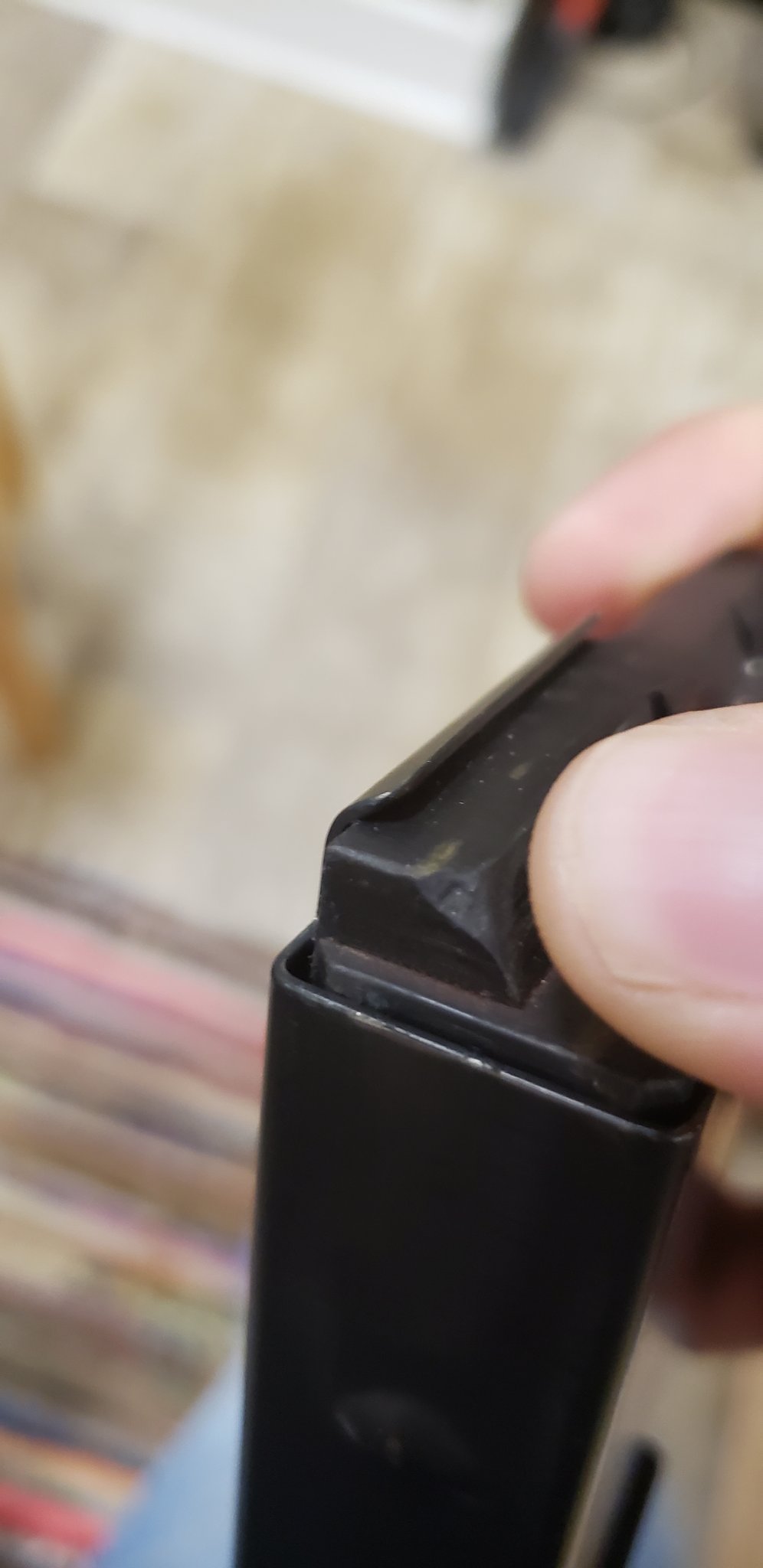

    I like @Geno C. ’s design of the drop-in follower as opposed to an entire new magazine. Really cool. If people really wanted these for the MC and Geno didn’t want to machine a bunch, I’m sure I could measure one he has machined and model it up and 3D print them. PETG isn’t as good as the Nylon 11 from Anarchy, but it’s certainly durable enough for a part that essentially takes no abuse.
    If it works out for @Nik H ask him to send it to you. There’s no way someone would want to pay for my time to make one. I’m slow and running a manual Bridgeport.

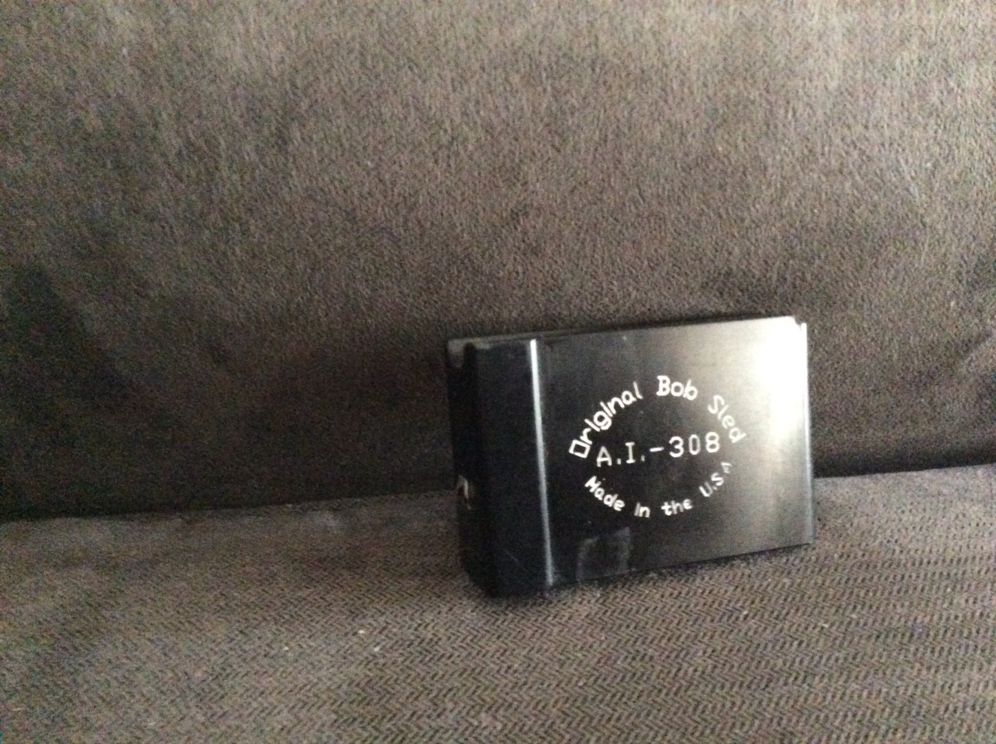

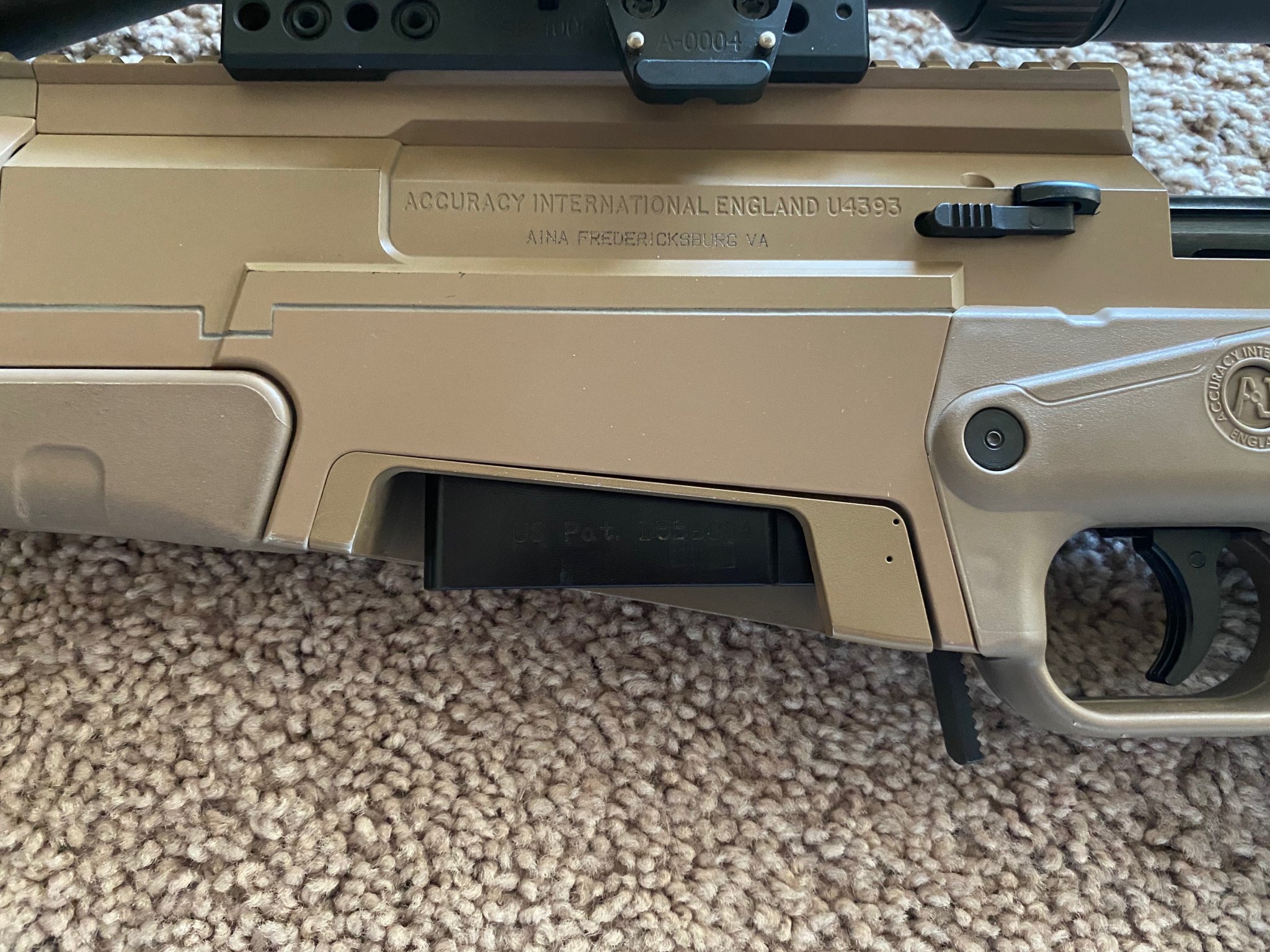

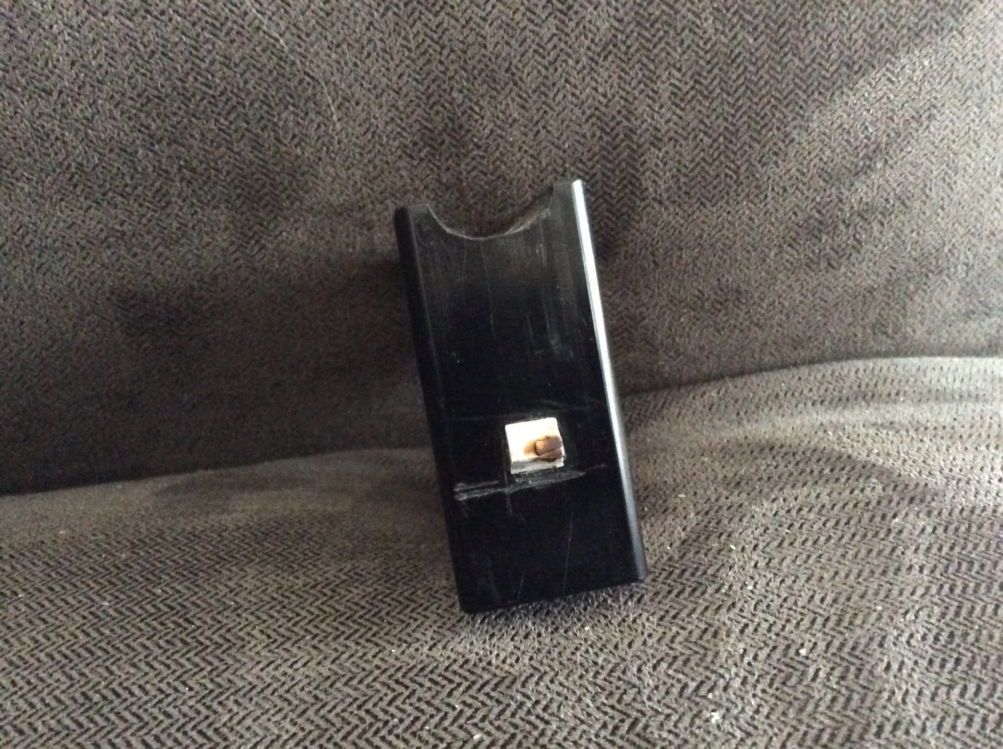

    You guys know that bobsled makes an insert. Mine fits my AXMC I just had to take a little off the metal insert
    It works just fine. I could see where they might not say it works because the adapter sits up in the back and the case will run over it but I tried it several different ways. I’ll put it this way. as long as you went trying to hammer on the bolt I would never see it be an issue. But if you are single loading i hope you are not running the bolt that hard.
    I have no doubt that it would work fine IF I had a magazine adapter like you do...I don't since AI doesn't make one for Left handed rifles...get it? It wouldn't work in your rifle either without the adapter
    Reason I want it is to allow me to shoot solids that won't fit in a magazine
    Sorry I tried to help. i Understand it’s left handed. when I posted it. You had not replied yet
    i also was just trying to see if you were trying to run it because of no mag adapter for your S/A round and was just trying to be decent

    I've been printing and selling Savage single shot sleds after I couldn't find one that satisfied me. I wouldn't mind taking a shot at making one, but don't have any axmc stuff. If this is something you guys would want I would take a shot at replicating the wood version or using schematics if available.
