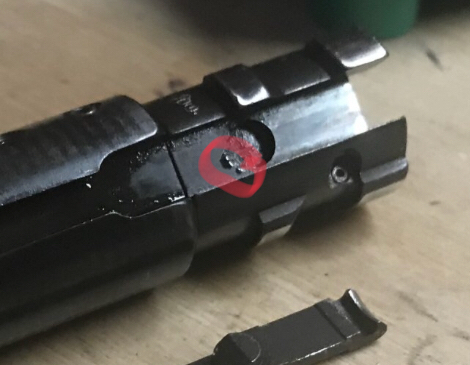

    Having a problem with my AXMC. Rifle has shot fine up until this last weekend. I shot a match where it rained very hard through part of the day and the terrain we were on was very sandy. About 1/2 to 3/4 of the way through the match i had a couple live rounds that would not extract unless fired. After the match a gave the rifle a thorough cleaning because of the rain and sand but when running a function check i discovered that it will not extract anything. I haven't tried firing it for saftey reasons but it will not extract any shells, loaded or unloaded. i didn't notice any pressure signs on my brass, dope was dead on as suppose to be. spent brass looks like it always does.
    I've attached 2 pic's of my bolt, not use to this type of extractor as i'm more familiar with Remington 700 bolts but i'm not sure what's wrong and appreciate any help or suggestions.

    It looks like it’s in the right place.
    To remove it, the extractor (where it grabs the case Trim) needs to be pushed radially outward to clear a little nipple that’s out of view, then it pulls straight out of its track. I use a small flat blade screwdriver for this. Really easy. May be something underneath it that’s holding it up some. Possible a piece broke off of it, and it’s skipping over the rim. To reassemble, push it straight back in its track.
    Don’t know this guys but he removes the extractor in this vid.
    The ejector and extractor are both freely moving but after messing with it just now it seems the extractor is sliding back and fourth a little bit so not sure if something cam loose underneath. i will attempt to take it apart and look like the video here.
    There’s nothing underneath it. It will shimmy back and forth a bit also, which isn’t a problem. Change lots of brass recently, or perhaps a new sizing die, or a change to the setting on the existing die?

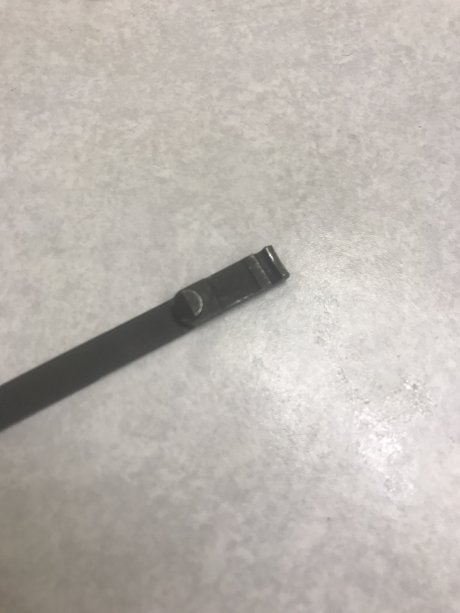

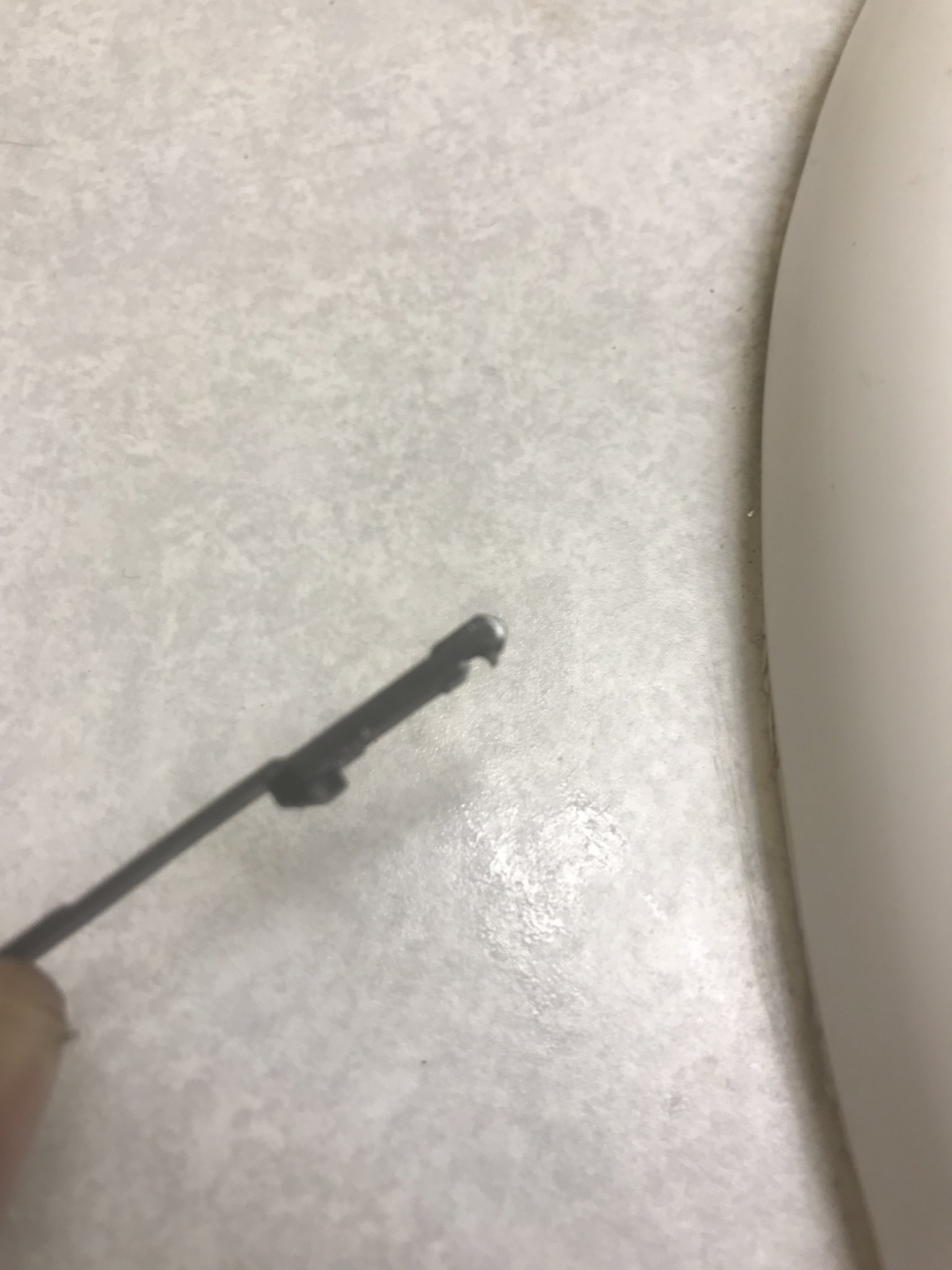

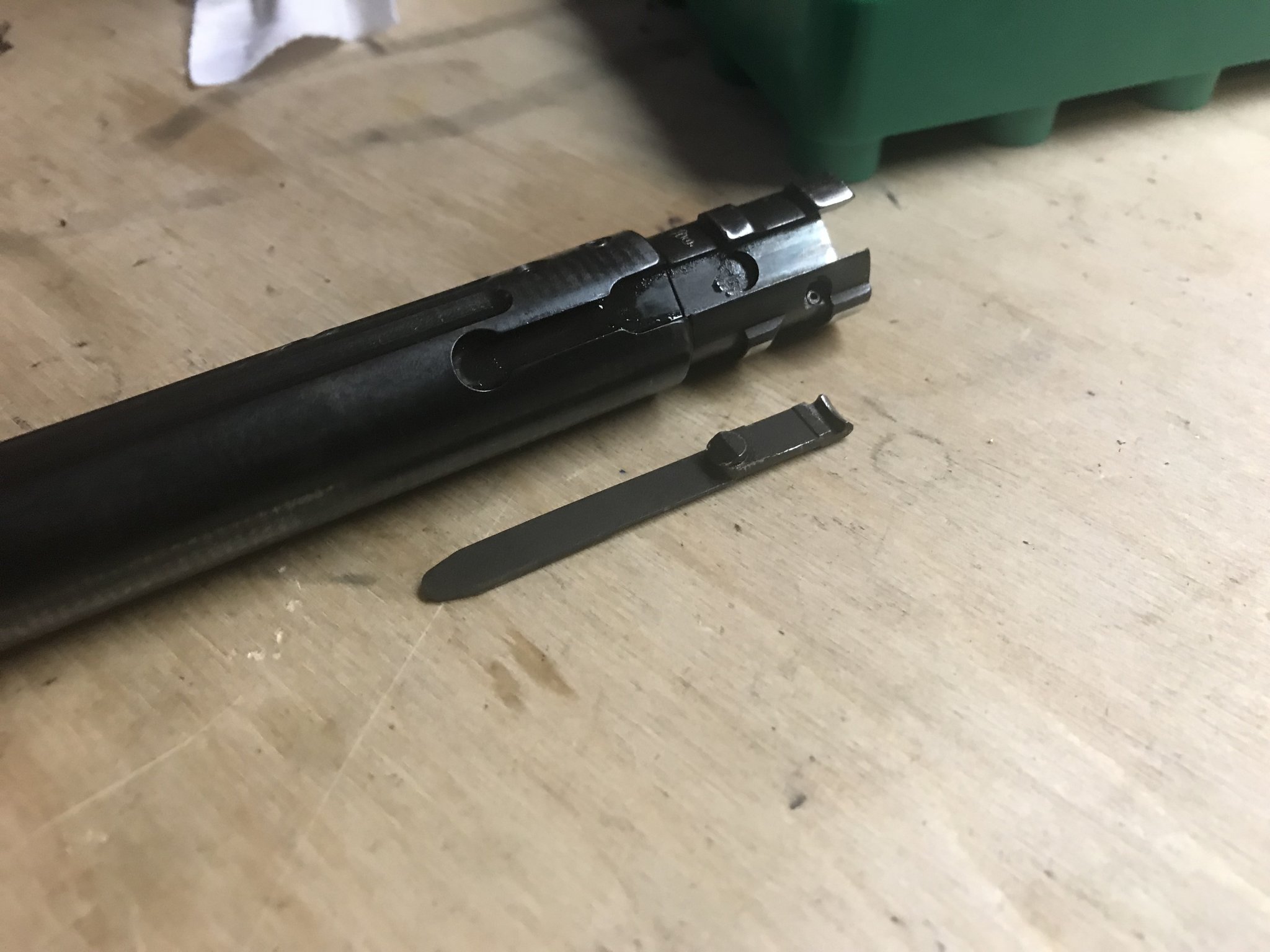

    i'm not sure what's going on. i didn't realize the extractor could come out that easy so i just took it out. here are some pics. it's not catching on the rim of the brass anymore. nothing in my loading process has changed and it was working for the first half of the match,

    how old is your rifle? Have you tried extracting unfired rounds before this? looks like the win mag bolt face?
    I had this issue with my 308 bolt and it turned out that the extractor groove was out of spec and I had to send it in to get a new bolt. Does it look like the back of the brass you can't extract is being machined some by the extractor? Mine was doing this and the problem was that the extractor would be pushed back by the case unless you were manipulating it very fast. Once you fired the round it would cause the extractor to "hop" over the case and properly extract.
    Could be 2 things. Extractor could be too short on the overall length or the groove it sits in could be machined too long allowing too much back and forth movement. There should be some movement from the way it goes together though.
    Rifle was bought new from EuroOptic back in march (2018) Rifle worked flawlessly up until this last match. It seems that the extractor is moving enough to where it will not catch on the brass. not sure if the extractor is now slightly bent, maybe from pressure? i never noticed it moving before but now that i've been checking it, it seems to slide back and forth quite a bit. i've tried closing the bolt hard and fast and still nothing. during the match, when the round was fired it would then extract.

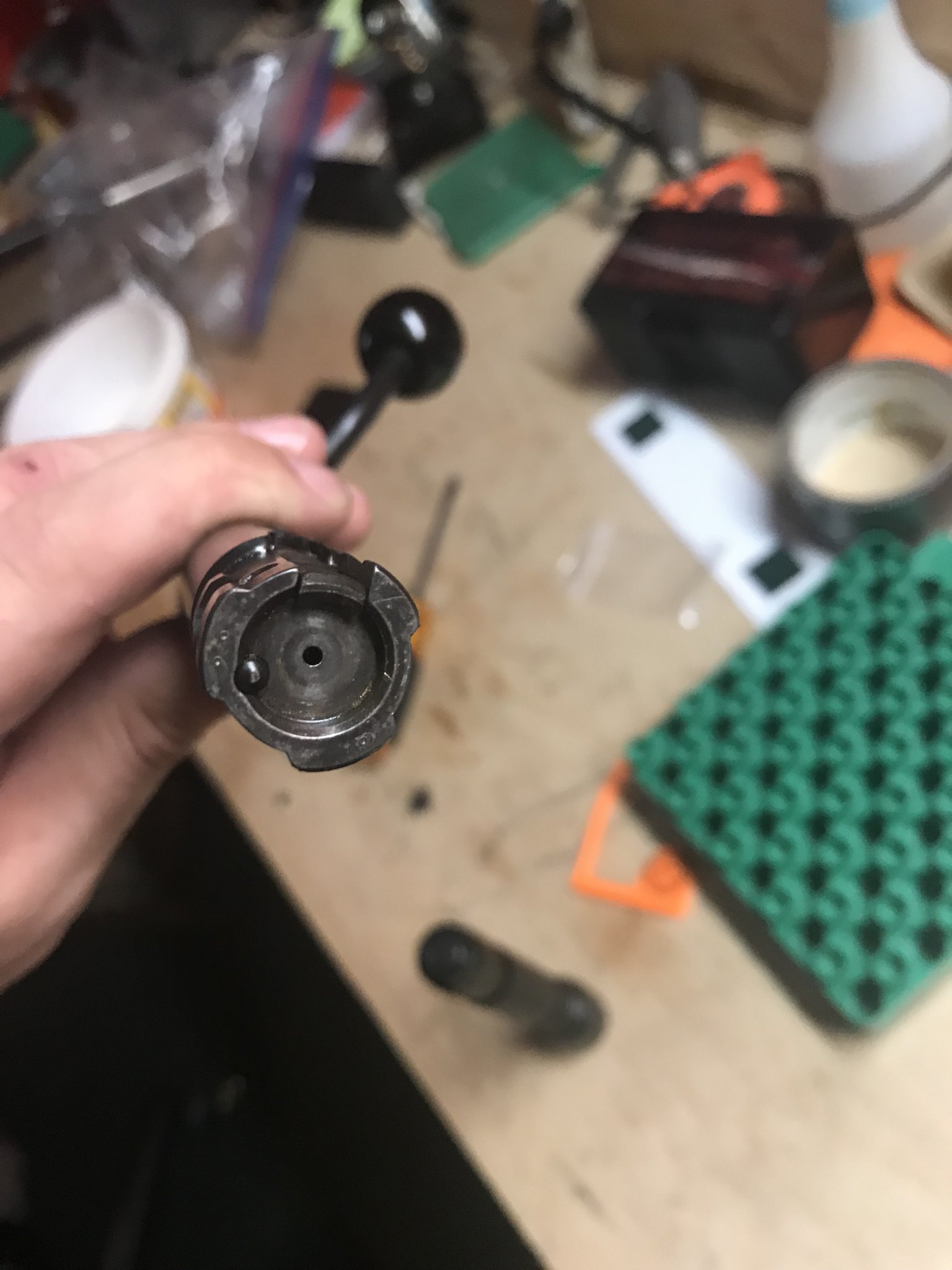

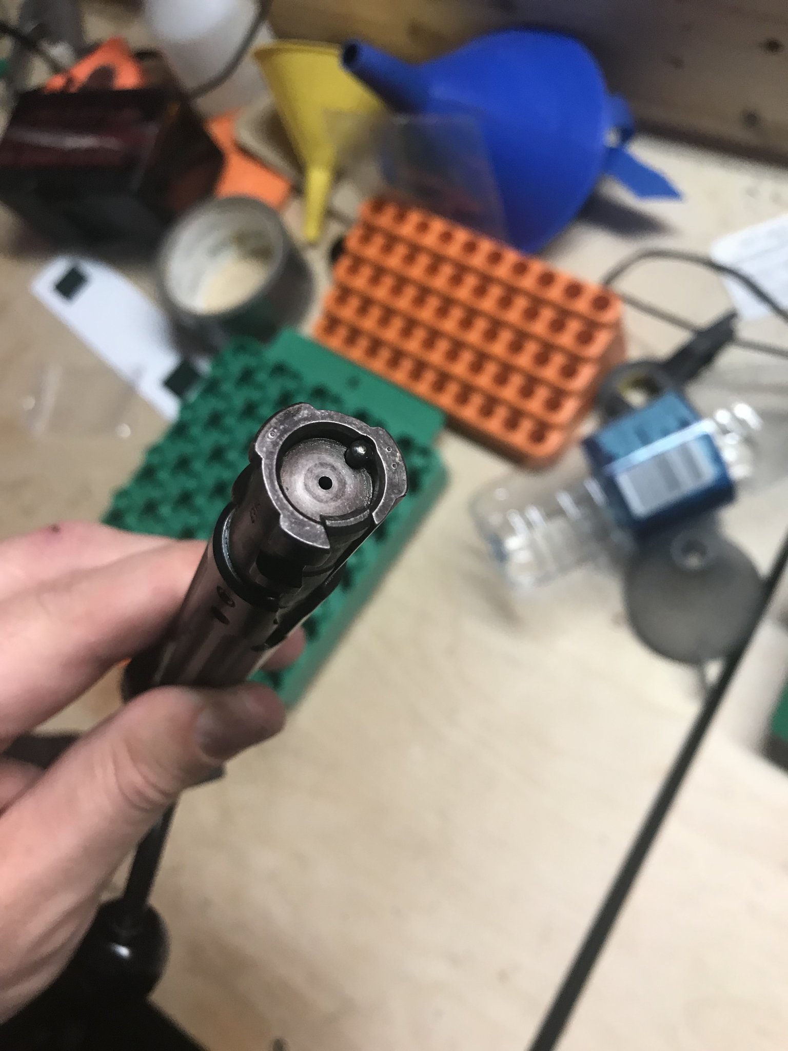

    In looking at the bolt out of the rifle the extractor hook is almost down to the boltface. It doesn’t look like there’s even enough room to capture the round. My other two bolts do not look like this.
    I believe there was a problem with the groove the extractor fits in being out of spec on some bolts. It appears that may have been what was wrong with mine.
