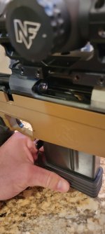

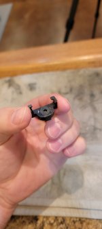

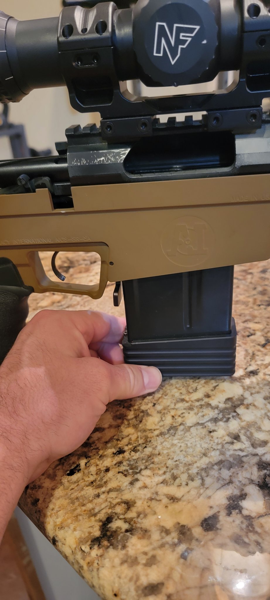

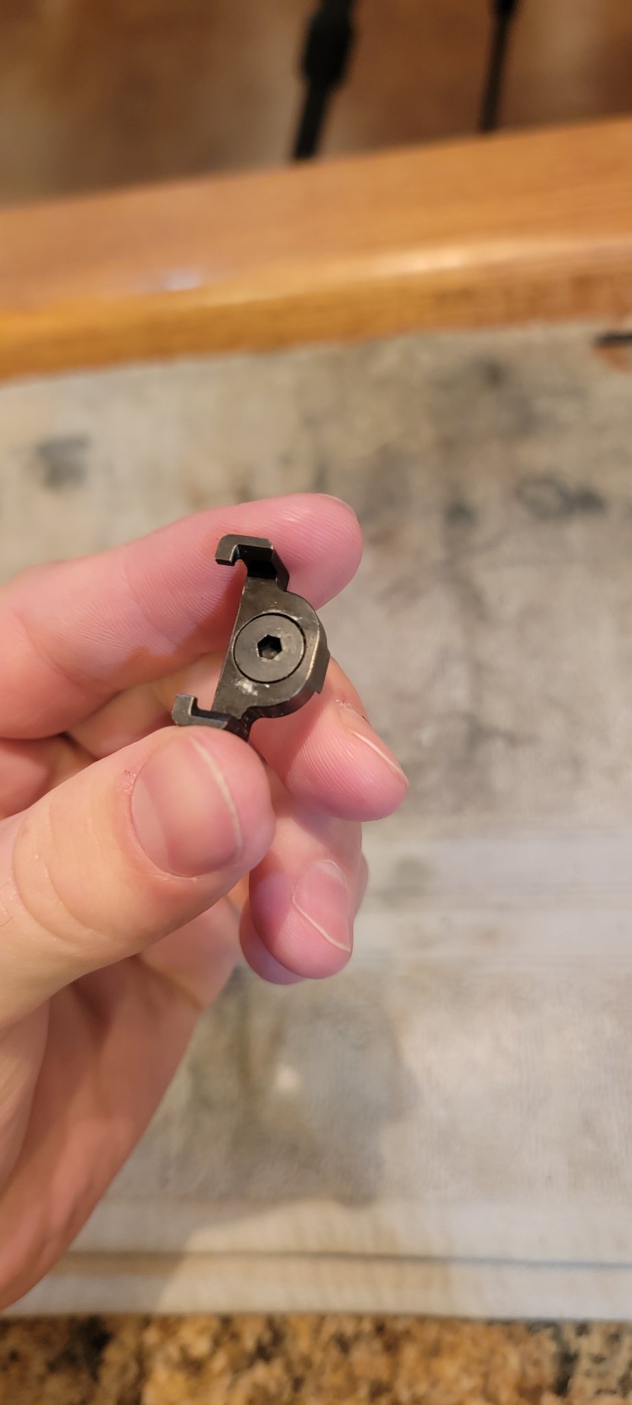

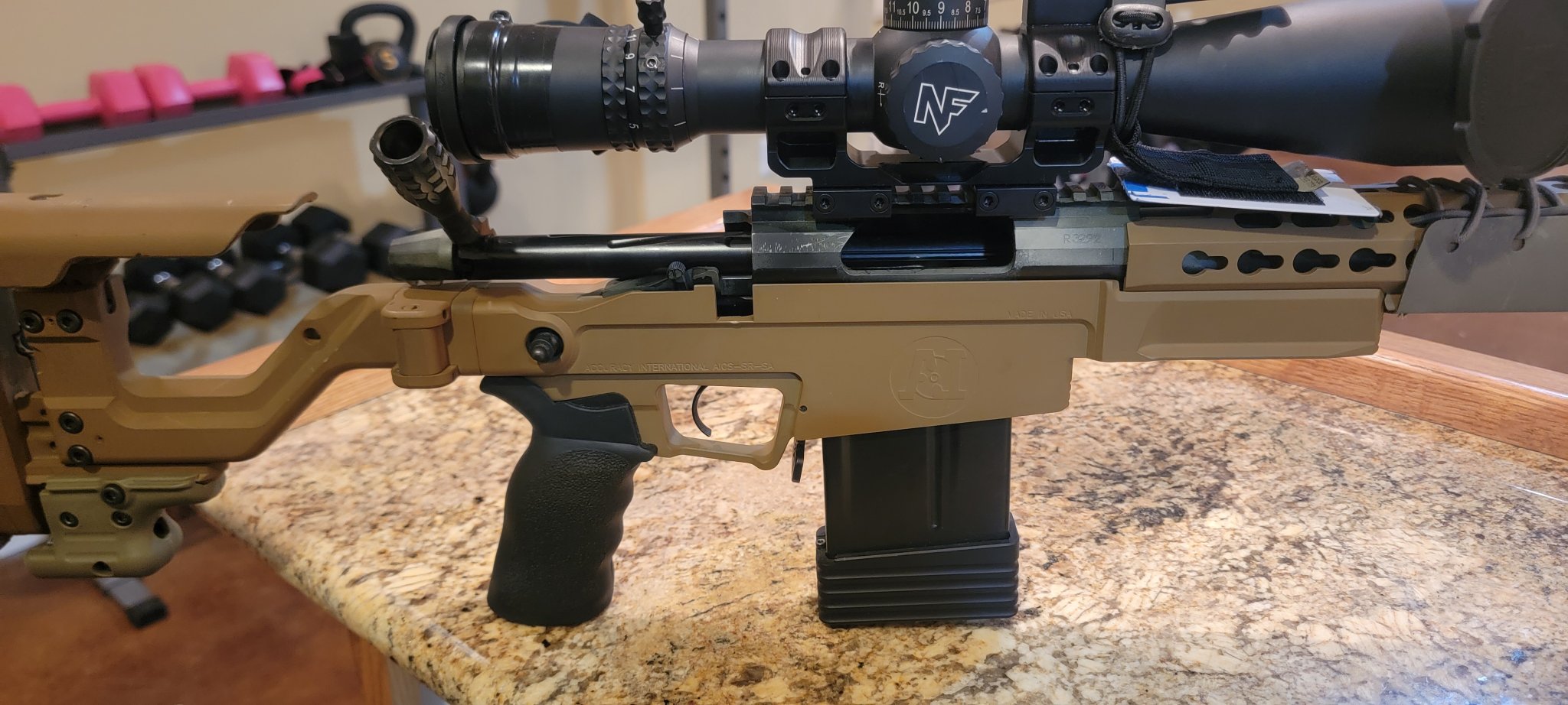

Just picked up this awesome AXSR chassis for my Impact BA. I've learned to expect fitment issues with these trigger hangers so here's my question:
The chassis has a "magazine stop" if that's what it is called. I removed it because the front of the trigger hanger interferes with it. My single stack mags feed flawlessly - no issues at all. However, without the "mag stop", a little upward pressure on the mags place the feed lips in front of the bolt and it cannot forward travel. Not a big issue, but I am asking if AW double stack mags and their different feed lip geometry would allow the bolt to pass over?
I've had some custom builds where upward mag pressure touches but does not impede forward motion of the bolt, and one or two that did, so this is not new to me. I had AW mags a long time ago, but my 6.5cm rounds kept springing out into the dirt so I switched to single stack ever since.
