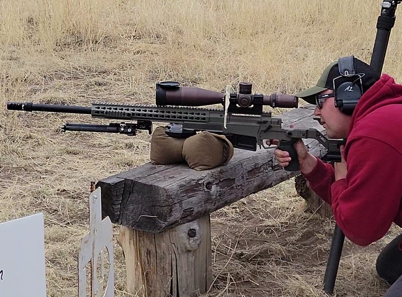

The AXSR is an awesome prone rifle and for shooting past 1k yds. As someone who shot 2 years of PRS with a 6.5 creedmoor barrel and also have shot 4 local matches with my 300 PRC barrel. The chassis is the biggest issue. That big hump on there to support the larger barrel and handguard will be the bane of your positional shooting experience because it puts your center of gravity really high. I almost always ran a gamer plate to mitigate this, but it only helps so much. The bolt and travel isn't a big deal in my opinion, you can learn around it and the .308 mags run great. Maybe the best of any mags I own.
I love my AXSR and wont be selling it, but it will straight up hold you back in PRS if that is your ultimate goal.
Pic below is from King of Coal Canyon probably 2 years back.

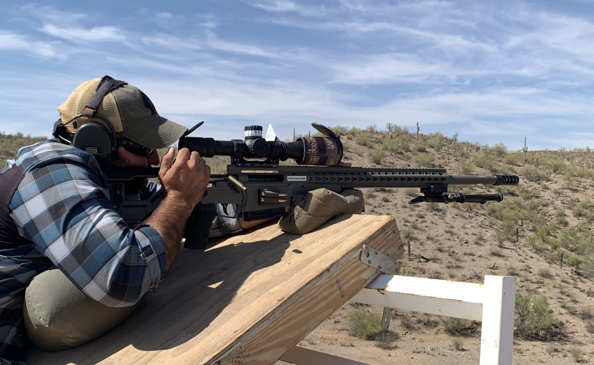

Will you be limited by having a long action over a short, absolutely not. Not even in support side stages. Will you be limited by having a “800 pound bolt lift that the internet claims as terrible?” Absolutely not. My friggin 8yr old can run the bolt…that and with over 5,000rds through it, it’s pretty damn smooth. Can you shoot 1/2” groups at 100yds positionally off a PSGC with it? Absolutely. Does that hump require you to be on your game positionally? Yes. Disadvantage? Rarely and really only with certain props. Mine balances perfectly on the hump without any weights or anything other than a bipod.
The AT-X is nice because you don’t have that hump, which can be an issue to overcome in tight ports or gates. But on a barricade, barrel, rock/boulder, vertical post, chain, stairs, truck bed, roof peak, there isn’t an issue. Place bag, place rifle, shoot.
