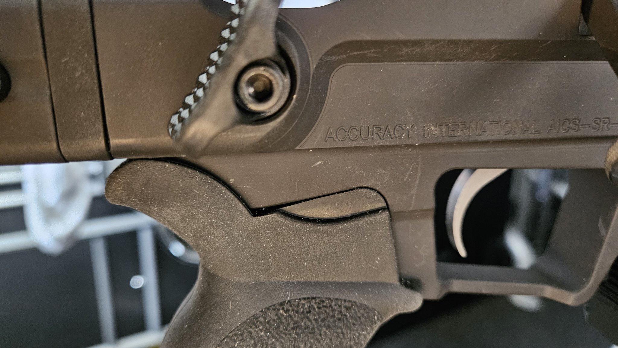

Has anyone been able to rig a thumb rest on an AXSR? I switched mine to fold to the right and currently the locking lug is in perfect position to use as a thumb rest but the folding hinge gets a lil in the way.
Wondering if any of the aftermarket rest’s wolf work or if anyone has rigged one on.

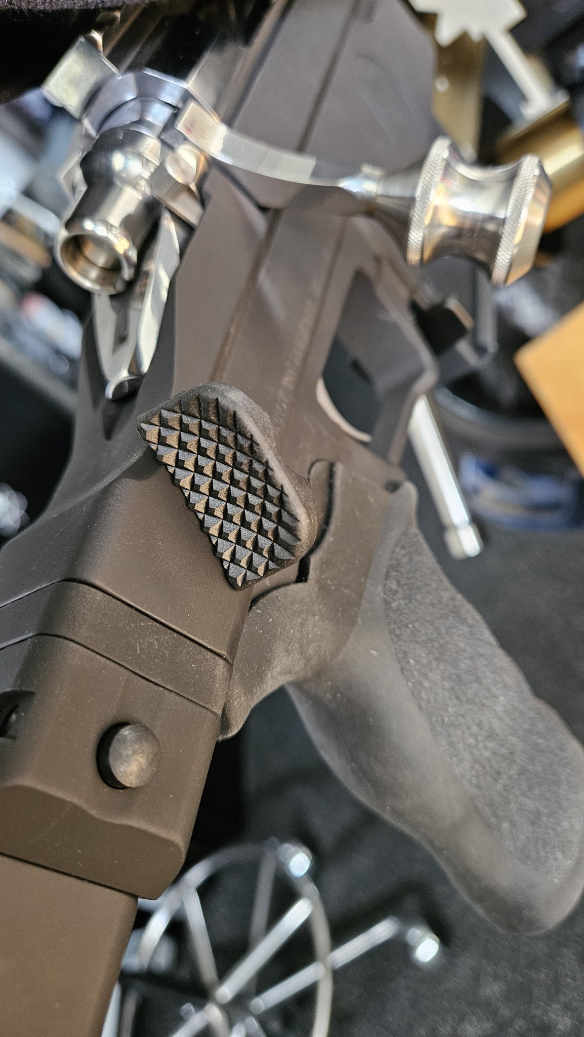

The XLR one works really well. Easy enough to install, and feels really, really good. Looks appropriate, too.
Enjoy!

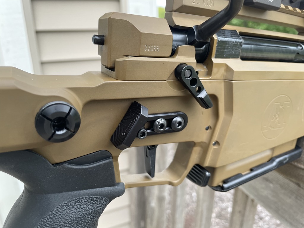

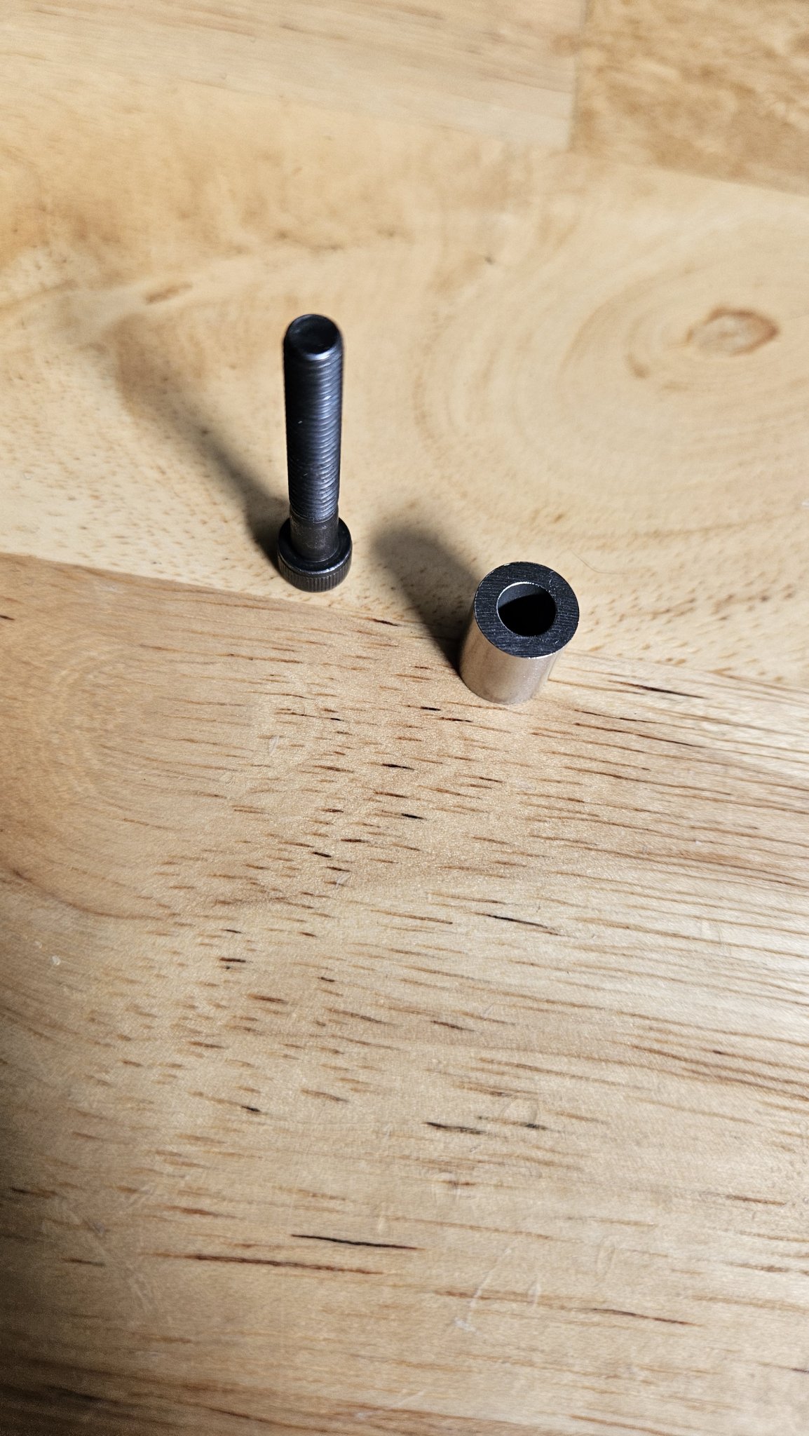

Trying this out for a bit and wanted to share... 10/32x1.25" socket screw and a spacer to attach an MDT thumbshelf. Hinge was flipped to the other side which I like better for cleaning. Feels like a good/comfortable position so far, doesn't look that bad, and just takes a few bucks at the hardware store without drilling and tapping. It does sacrifice the qd cup but most folks probably don't use that one anyways. I believe this would work on the chassis (my case) or the rifle.
