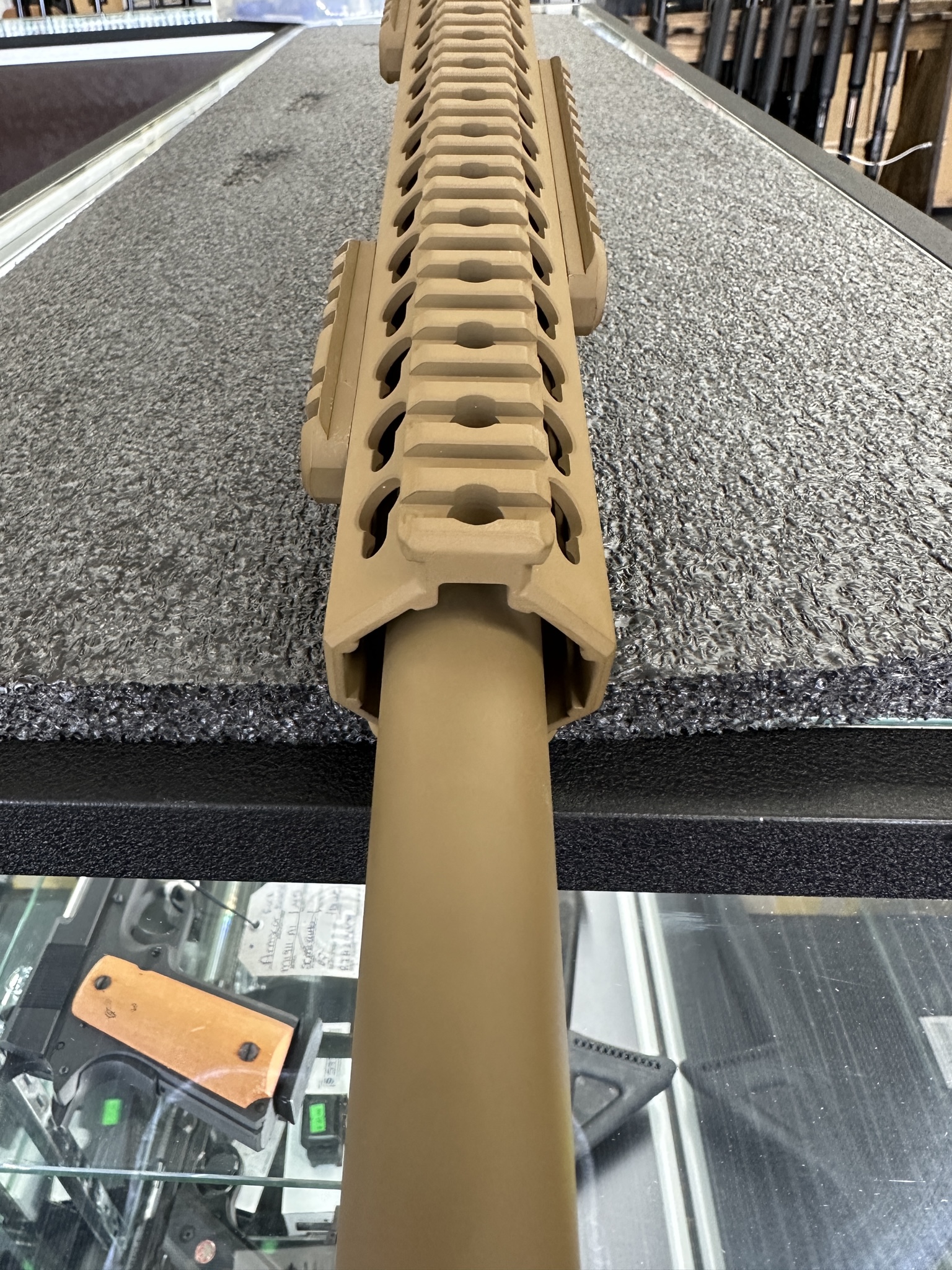

This is a brand new AXSR, I took these pictures at my local gun shop.
Is it acceptable for the barrel and chassis no be misaligned to such extent?
I imagine it’s not normal, but want to hear your opinion. Should one expect perfect symmetry from AI these days? With the barrel and the rail not in line perfectly can this even be considered to be a tool of accuracy?

Tried that, the barrel was on correctly and the screw was at the correct tension.
I took the barrel out and tightened back up, same offset in alignment.
This isn’t a barrel issue. The action and chassis mate together on a flat plane, so if the action screws aren’t torqued with the barreled action centered it can be off center in relation to the handguard. Mine was this way out of the box too.
The optic, action and barrel are all still on the same plane so it’s not functionally detrimental.
Just crack the action screws loose, center and re-tighten. Easy peasy.

And @SuperBoot is correct, if you loosen the 4 front action screws you can make sure it is centered and tighten. Worked on mine.

At least it’s not bonded. I’ve seen this with brand new AXMCs too. Not usually as noticeable with the factory barrels. Screw in a heavier profile and its quite noticeable. For the money, I agree, they should be dead centre, especially left/right.

Why can’t the end user center it? Every time you take the barrel shroud off you’ll have to center it. Every time you take the action out of the chassis you’ll have to center it. It’s not an issue.

It’s not a QC issue. It takes a second to align at the end user level. You have to do this every time you take the barrel shroud off. Stop being a petty Karen.

Yeah that’s cool if you can easily centre it by loosening some screws and repositioning. What I was getting at was I’ve seen this with the bonded rifles too. Not as easy with the bonded rifles.

Youre a big fan but you dont Know how this works? Ever zeroed a turret on a scope? Ever adjusted tension on a qd lever?
this is the same thing. There is a little wiggle room in the barrel shroud channel. You loosen 2 screws on the chassis and it moves side to side. Center it on the barrel and tighten the screws. It takes a couple of seconds. What is so hard???
It would be best if they had an alignment jig at the factory for installation. Also AXSR is assembled in 'Merica not England. The action is imported from England but the chassis is made in the US, barrels chambered in the US and final assembly and QC is US.
And it should be the alignment of the action to the chassis which needs tweaking. The handguard bolts to the chassis in a V-channel so it should self align with adjustment not being practical.
You should do a test with the barrel off center or centered with the clip on.

That’s exactly the plan. My intent is to test the factory barrel then aftermarket barrel before attempting any adjustments. Test both barrels with NV and Thermal clip on see if there is a lateral shift.

Just undo the front 4 action screws, center, and retorque. I had to do this on mine. It is basically cosmetic since the action rail and barrel always maintain alignment. Had no issues with a clip on before or after I did this, but it was just bugging me cosmetically. Was easy to do since the AXSR isn’t bonded.
