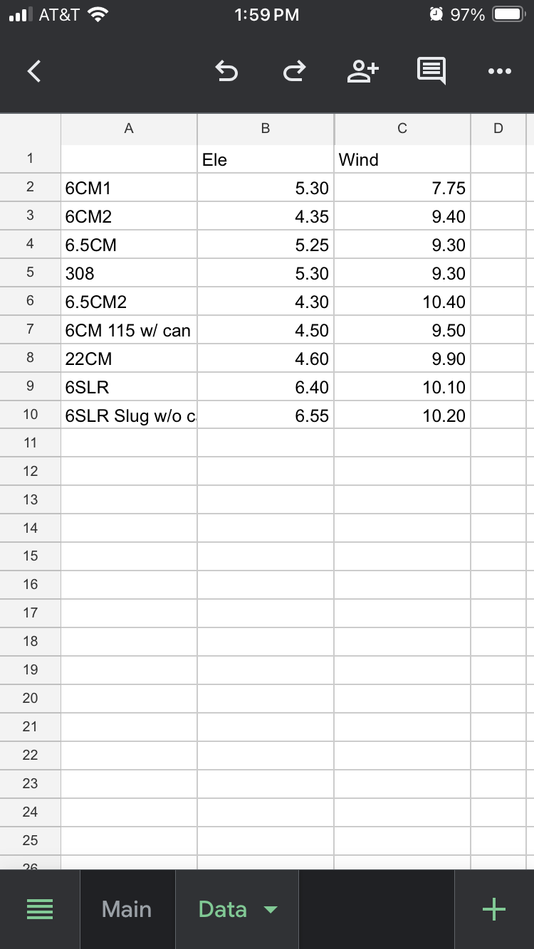

Here’s my AT from some point in the past when I had a bunch of barrels in rotation
+2 mils of elevation and +2.5 mils of windage @ 100 yd
Numbers are in mils, so you’d have to do the math to convert the differences to inches if you wanted…
was solid repeatable though…once I had them documented I’d throw different barrels on between matches, reset the zero on my turret, and go shoot.
