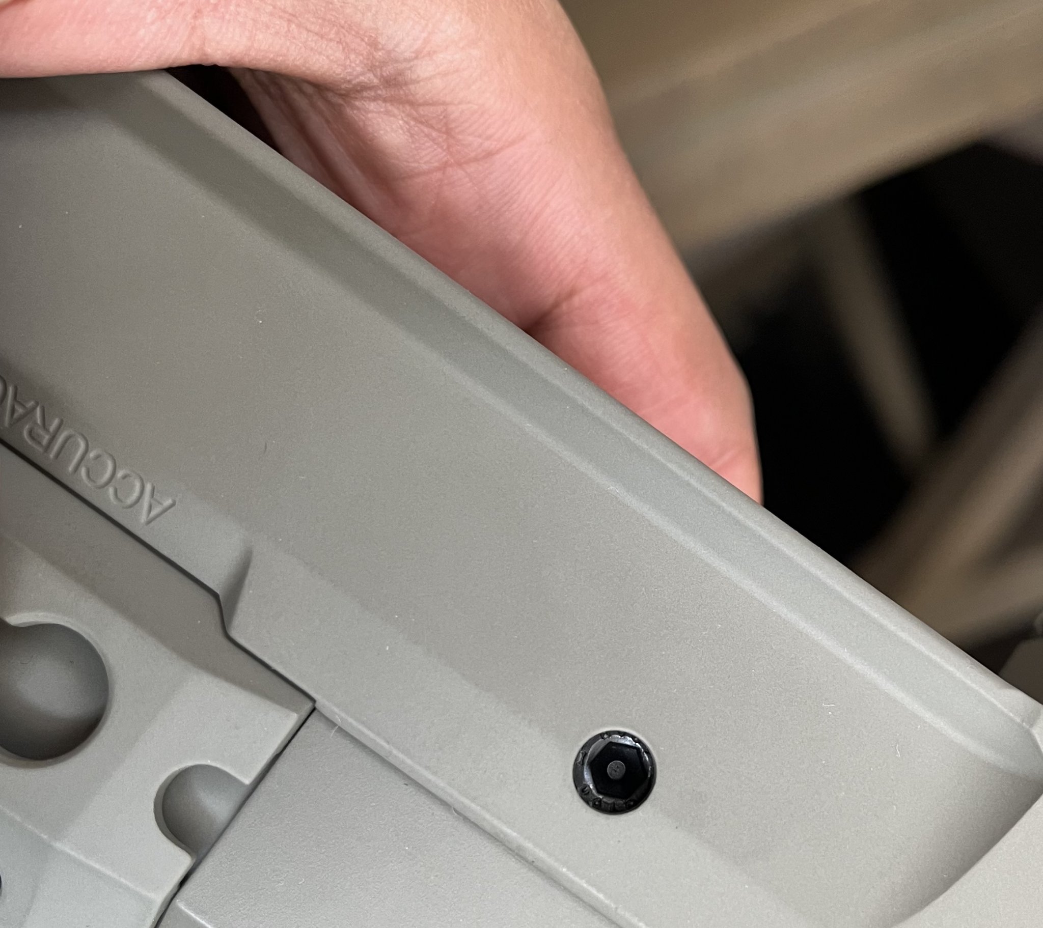

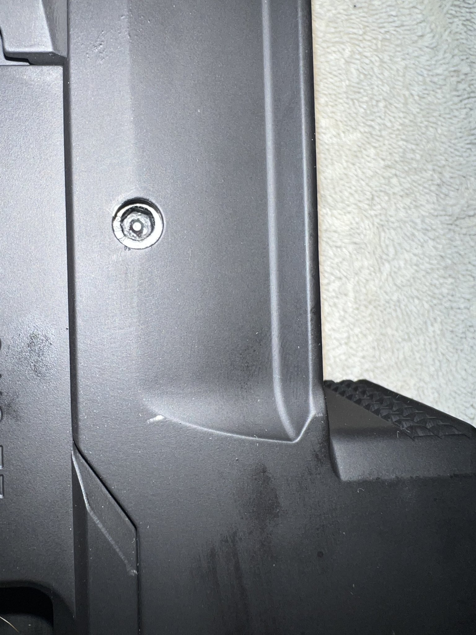

Just got this delivered the other day and when I went to change the barrel today I saw this.... This look OK to anyone? Kinda defeats the multi-caliber thing huh?
It's roughed up but can you get a 4mm hex bit in there and loosen it up? If so that should make replacing it easier. I'd look into taking it down and send the action to AINA to replace that bolt.
Now I see why it was "like" new
@Browny I guess it wasn't my lucky day. No dings or scratches but we can trade :)
Well this gives me pause on ordering from Eurooptics…. Was thinking about getting an AXSR myself and just emailed them last night…
I don't see how you could fault them for not noticing a tamper resistant screw in there. The OP obviously didn't notice either. Its not as though they take all the rifles at EuroOptic and start changing barrels around.
Taking it online before giving them chance to fix it, is bad form. No body is going to notice that until they try to stick an allen wrench in it.

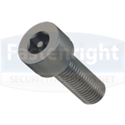

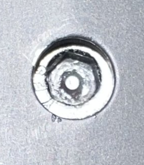

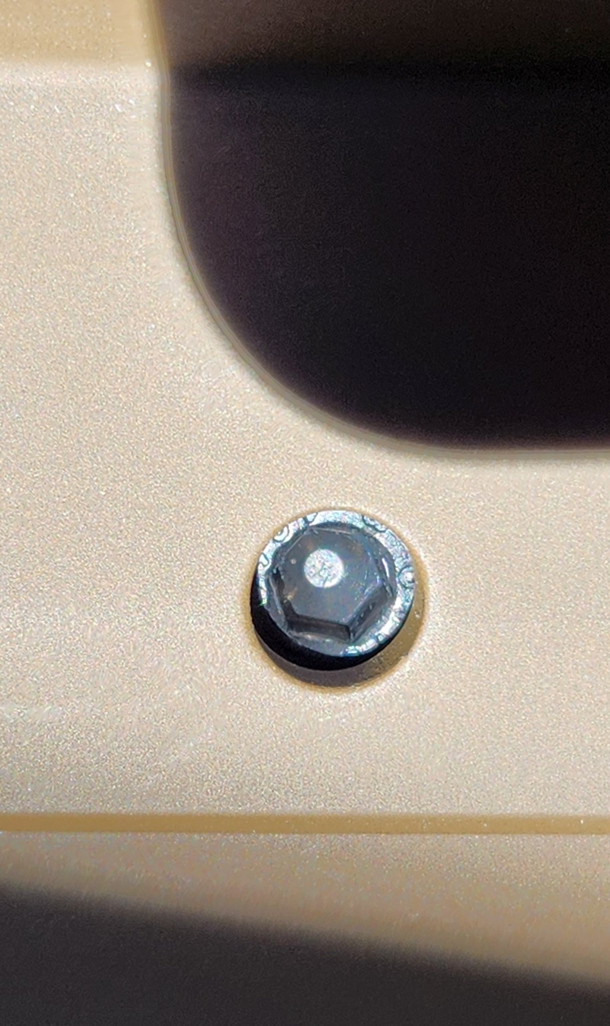

Is it just the illusion of an tamper proof head? They all have a little dot in the bottom but are NOT tamper proof.. Here's a pic of one I just took this am off to the side just a little. If the camera is straight on, then it can look that way. OP can you not put a 5/32 Allen in there? From your pic it looks like the edges of the head aren't stripped and have solid angles (no rounding), just a little discoloration in the bottom of the head.
I reached out to them as well. Haven't heard back yet, but its the weekend... I get it.
My post had more to do with the one from a few days ago about someone in a similar situation asking about QC issues from Eurooptic, obviously I'm not the only one.
Reactions: Chargerguy
Sorry to hear about this. My AXSR came from AINA in the condition I mentioned. I don’t think I can fault EO for that. As their rep mentioned the rifle was received on May 23 or something, and never displayed etc. before being sent out early June.

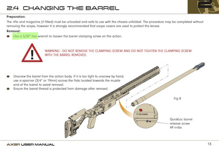

If this is cosmetic I wouldn’t put too much thought into it. Try sticking that 4mm in there and see if it seats properly. Yes, I know it hurts at this price point…but as @MOUNTIC said AINA should take care of you. It shouldn’t be this way…but it is. For reference here is what mine looks like:
In my case I found that focusing on the several thousands of dollars increase in property taxes, inflation etc. made me completely forget about the marks on the acra rail 😂 oh, and not to mention shooting it. I am somewhat jealous that you got that deal, in the correct caliber…so I may take you up on that trade.
Lastly, in my experience sending something out for repair usually means it comes back with two more diseases that need curing. If you can get that screw out ask AINA to send you another one.

Why would AI is use tamper resistant bolts…for bolts that are supposed to be unbolted?

Or how about actually try the correct 4mm hex in the first place? (not coming down on ya, just reinforcing)

But hey, maybe there is a tamper resistant hex in there…maybe AI ran out of correct bolts and scavenged one out of their bathroom stall fixtures…but somehow I doubt it?

I’m just trying to figure out what the problem actually was.
To clarify, are you saying you recieved it this way from Euro Optic?
Correct, shipped like this
What you’ve written implies you think there’s a temper resistant fastener in there, not that you couldn’t get it out???
You also didn’t correct anyone that thought it was a temper resistant bolt.
And if you were unable to remove said bolt (vs tamper resistant), how would posting a pic with an installed intact hex bolt illustrate this fact?
I mean, you’re going to have to apply some decent force to that bolt to remove it, but I guess if you’ve tried…I dunno.
Calling the retailer and posting pic on an internet forum before actually attempting the above is the definition of a first world problem…on steroids.
Or perhaps the wrong size or cheap Allen wrench. The faster doesn't look stripped. It could be the Allen key stripped.
Reactions: carbonbased
I didn’t mention tamper resistant, someone else did. I only mentioned that the screw that is used to change the barrel wouldn’t work. I used the provided hex and them some of mine to no avail.
Still haven’t heard back from EO after opening a case.
I agree. Three corners of the hex are visible and all appear sharp down in the bottom of the recess. Cant see the other 3. I hesitated on pointing that out before because I don't have it in hand to know, but sure likes there's plenty there to seat the wrench into.
On the AXMC, if you remove that bolt, you run the risk of losing the internal washer down beneath the action. The action has to be de-bonded to get it out. Since the AXSR isn't bonded, it would seem to be as simple as just requesting a new screw from AINA (probably provided for free), but then we wouldn't have this thread for all the drama.
This is good info. The bolt on my axmc le is starting to get pretty worn. I was going to remove it and look for a replacement. Guess I shouldn't do that.
You might can do it if you lay it on its side and are very careful so the washer doesn't move, not sure. I'd talk to the guys at Mile High or AINA HQ.
