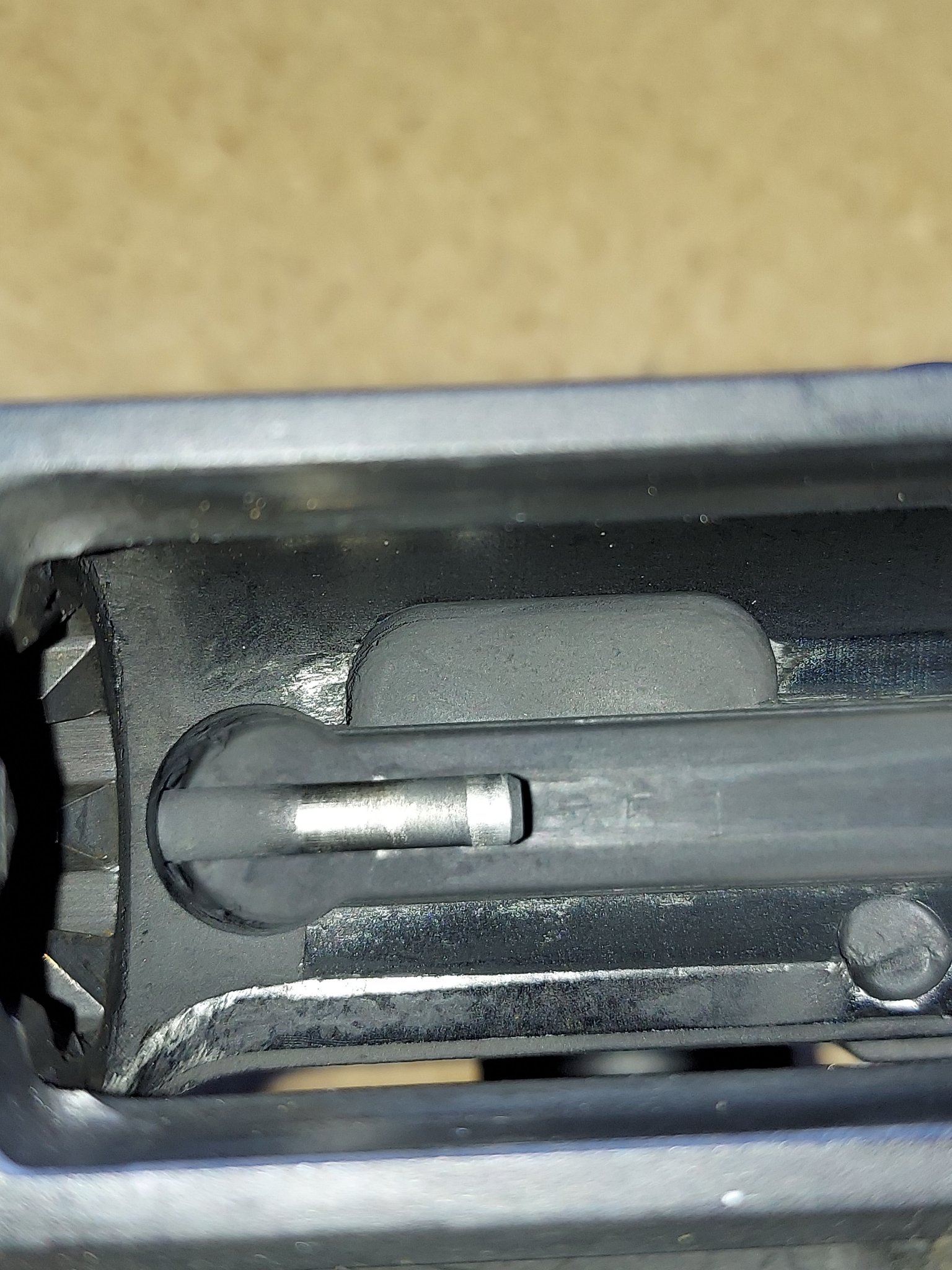

Your gas tube flange is worn on one side, which means it has been clipping the carrier key until worn down, which means the BCG doesn’t get enough gas. That creates an ever narrower window for the system to run with, which could explain your symptoms.
Replace the gas tube and ensure it is installed with concentric alignment to the carrier key.
I’ve seen several rifles with this issue and cycling problems ensue every time.
You can see how the OD of the flange on the left side of the tube (top in your pic) is almost worn down to match the OD of the gas tube.
When you say "SR25 tube", what length is it?

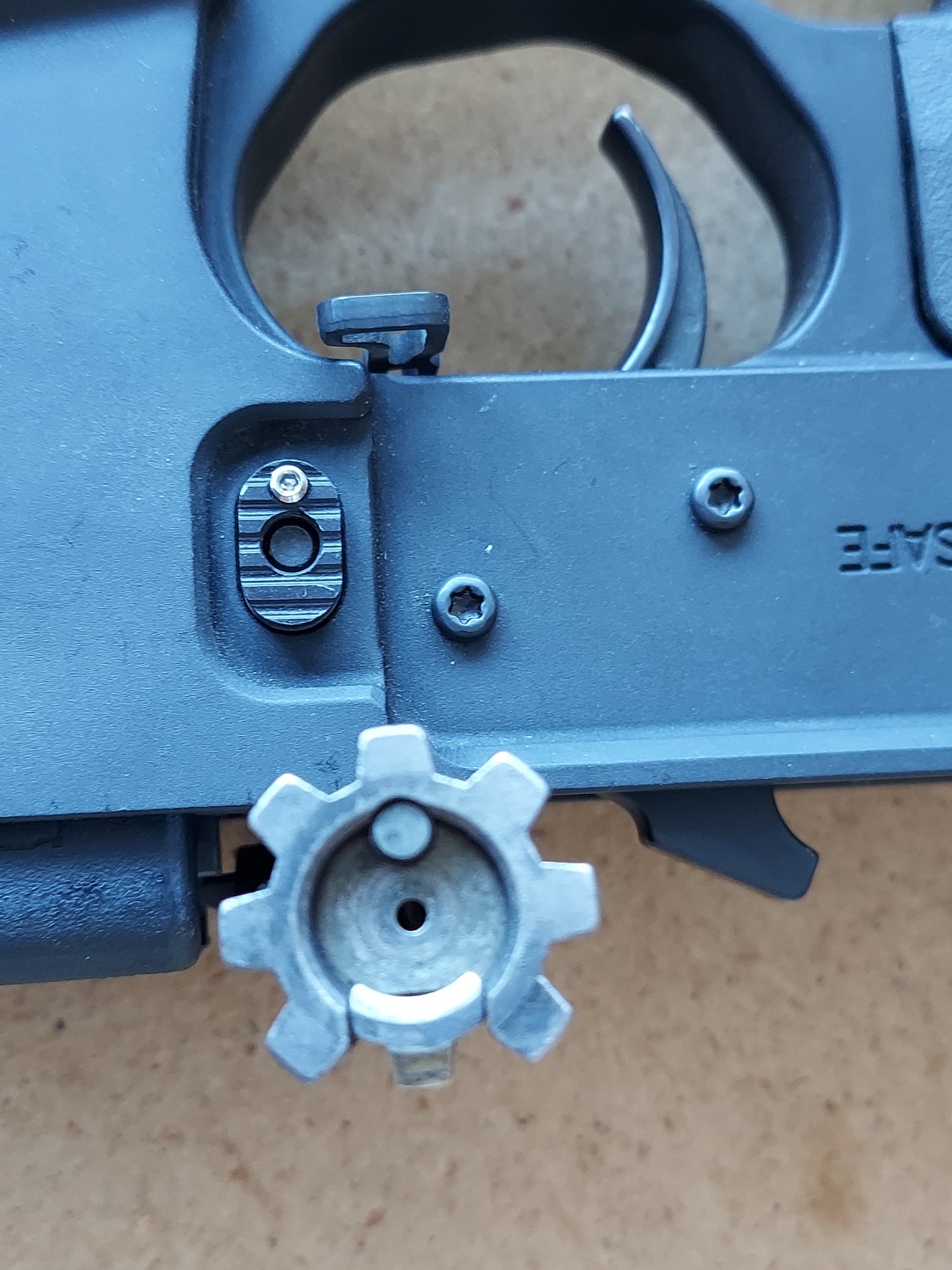

Glad the new bolt resolved your issue, but a couple important things stand out in this pic.
1 - All the wear surfaces look bone dry and impacted with crud. You don't have to clean it every time you shoot it of course, but do put some oil on it. Oil the tip of the gas tube as well; that'll help prevent the wear you can see there. Are you one of those people who intentionally run their ARs without lube, or is this just a lack of maintenance?
2 - Those wear surfaces and the edges of the ejection port have a ton of wear on them. Probably mostly due to point #1 above; oiling your rifle makes it last longer. When you see bright aluminum instead of the black anodizing, you're wearing through the hard anodized layer into the soft aluminum underneath; this is very bad and your receiver is on a very limited life span at that point. Just based on the pic it looks like you've already worn through 90% of that receiver's life, presumably caused by running it dry if the picture is accurate.
It also looks like you've been prying open the BCG with a screwdriver through the ejection port? Be careful about creating burrs and chewing up the receiver that way.
