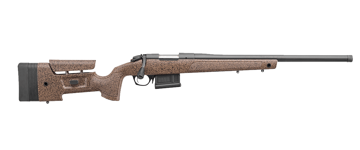

This may seem like a basic question with an answer that is obvious to a lot of you but I have a question about the B14 HMR stock. The design of the B14 HMR stock seems a bit unconventional (to me anyway) and I was wondering where you place your rear bag/support (see below image). There is a flat portion of the stock (parallel to the ground) with a sling stud in it (which you'd obviously remove if placing the rear bag here) and an skinnier angled portion (not parallel to the ground).
It would make sense to put your bag under the parallel portion because it will allow your gun to recoil straight back, but your face is going to be over the portion which is angled with respect to the ground (there's and adjustment for comb height here). I've heard you should have your cheek weld over the bag to avoid creating a turning moment about the rear support.
If you put your bag under the angled portion, the angle between the front and rear of the gun will change as it slides back under recoil. You also run the risk of the back of the semi-pistol grip hitting your bag under recoil which could obviously spoil your shot.
What do you guys recommend here and does anyone know why the stock is designed this way? It seems a bit odd but I could easily be missing something.
This may seem like a basic question that is obvious to a lot of you but I have a question about the B14 HMR stock. The design of the B14 HMR stock is a bit unconventional and I was wondering where you place your rear bag/support (see below image). There is a flat portion of the stock (parallel to the ground) with a sling stud in it (which you'd obviously remove if placing the rear bag here) and an skinnier angled portion (not parallel to the ground).

That angled cut out is what many call a butt hook and its made to put the bag in and do exactly what you described it as doing. Its so you can rapidly effect the elevation with the bag placement.

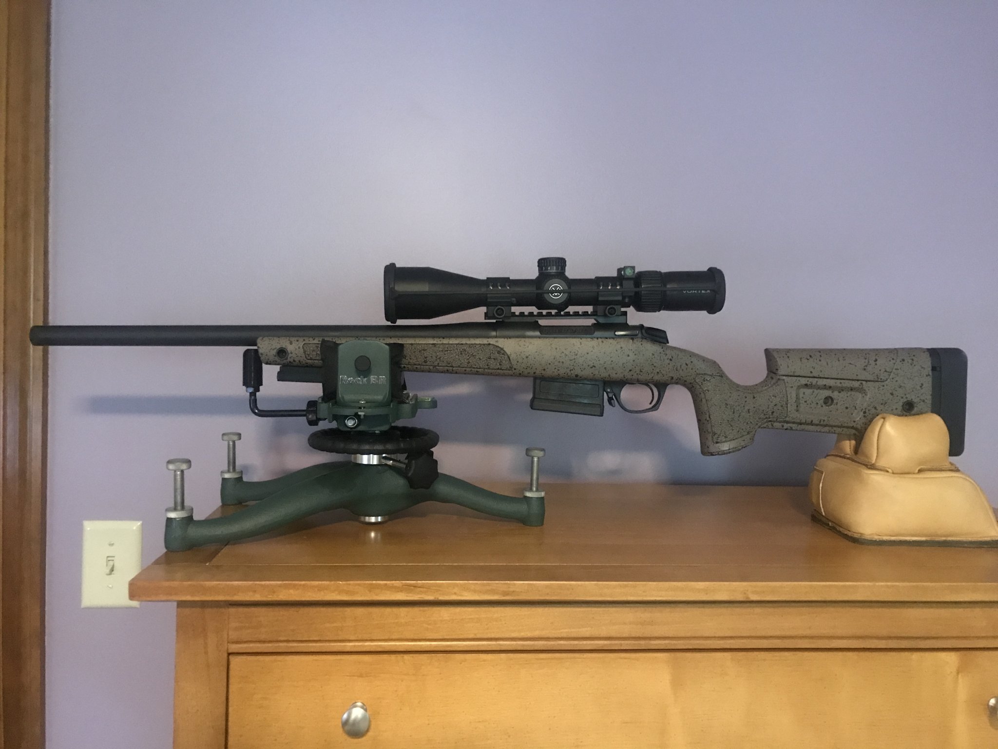

Yeah, that's what I've been doing as well (see setup below). Obviously using the parallel rearmost portion you need to either be able to adjust the front elevation or the rear bag height. Maybe the angled portion is there to give you the option to adjust rear elevation based on where the gun rests on the bag but you'd need a pretty small bag to avoid the semi-pistol grip hitting the bag.

I actually typically find myself wanting more height off the ground/bench, and parking the bag in the butt hook leaves me fighting more to get height at the rear. Not sure if I’m weird in that regard or what, but I like that using the rear flat surface gives me another 1/2-1” of rear height without needing to get weird/creative with the rear bag as much.
