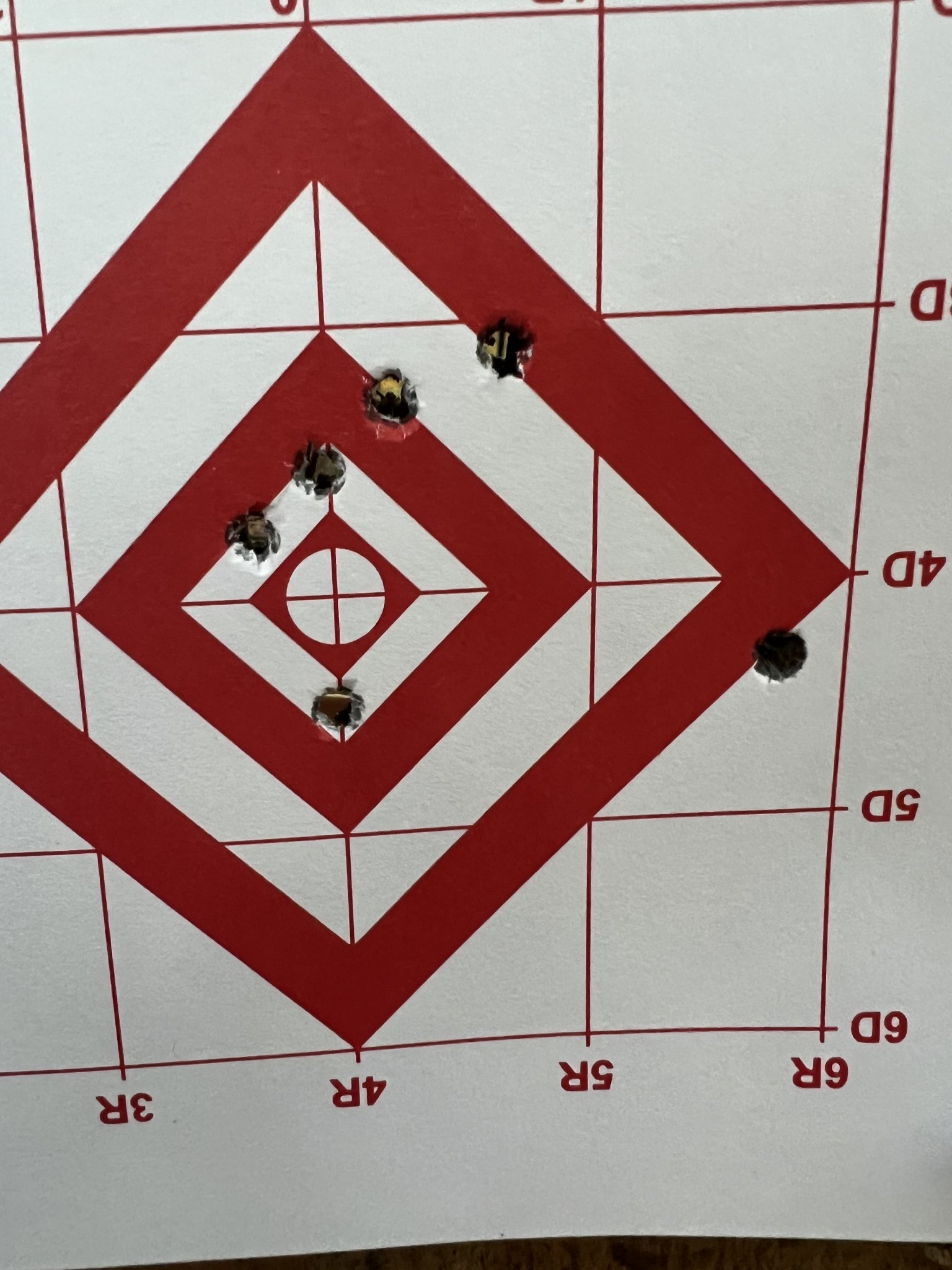

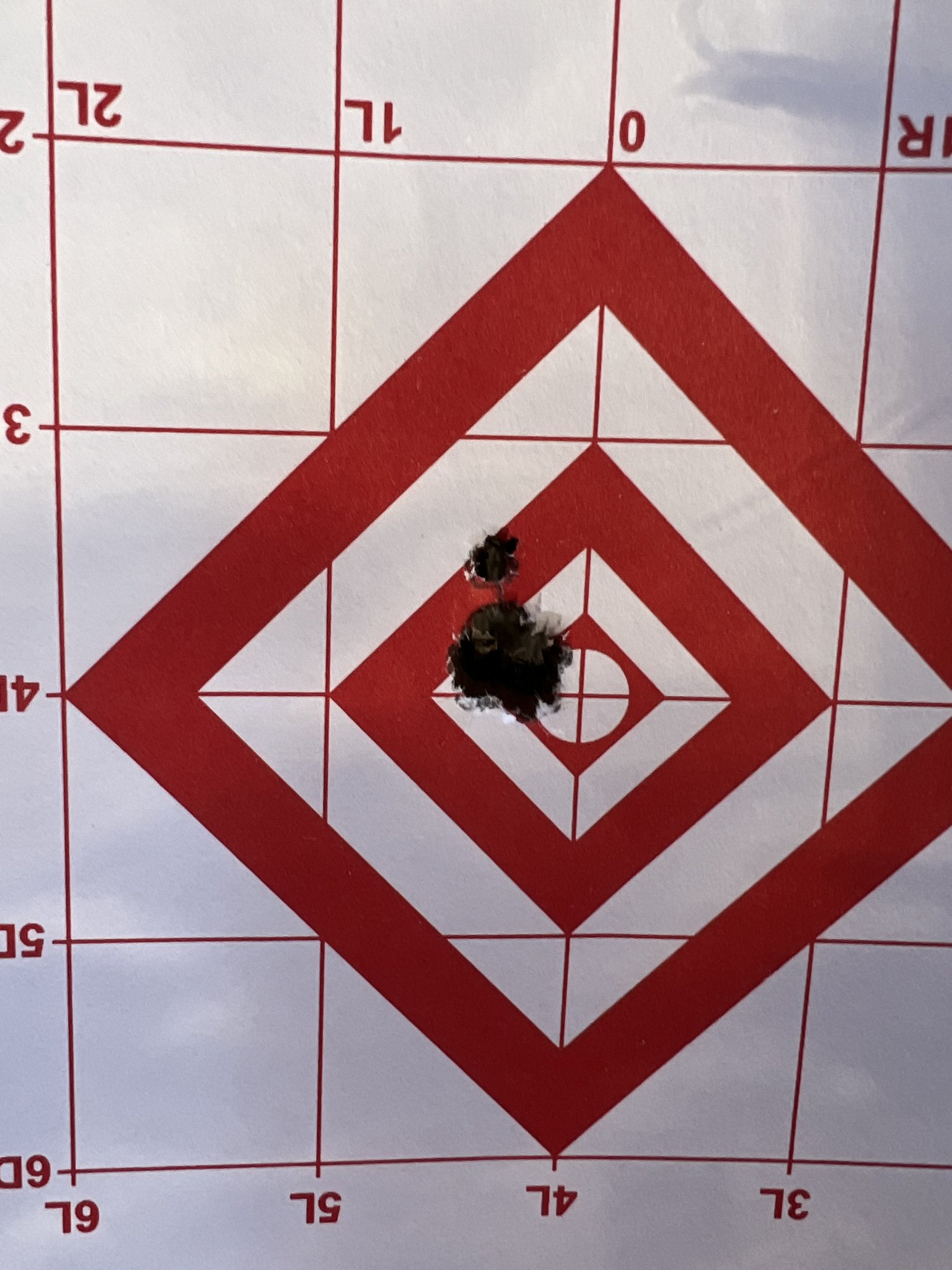

So any b14r experts out there.
Ammo Sk standard+
The small group is 15 shots from 50. The big group is 5 shots from 100.
Did this multiple times. Samar results.

The vertical is well within what SK Std + can do, usually is better but it happens, even your 50 yard group shows it unless you know you pulled that one high. The horizontal looks like 3-4 MPH of wind to me. Perhaps your pushing with your cheek and not realizing it.
Try a smaller target like the intersections of the grids if you can make those out at 100.

These groups look drastically different until I ran them through ballistic x and realized the 50yd group was just over 1 MOA (1.041) and the 100yd group was a little over 1.5 MOA (1.549). Not as much difference as you would initially think. I'm with the other guys, this probably isn't your 100yd go to ammo. Try some different ammo. I experienced this situation with my first Bergara, frustrated at the not so impressive groups. Then I tried SKLRM. Whew! It made a huge difference.
Reactions: Dstoenner
The rule of thumb on 22 LR is, what ever your group is at a given distance, if you double it the group will grow by 3x not 2x as centerfire would.
The 50 yard group was about 1/2 inch and the 100 group is 1.5. Both groups are more vertical than horizontal so if there was wind it looks to be pretty consistent.
The post above gives the real numbers and jives with the rule of thumb.

You have fliers in both groups.
How many rounds of that ammo since your last cleaning?
Do you test with a chronograph to know what is you and what is ammo?
Have you tested at any other distance or on any other styles of targets?
Have you attempted any action screw torque testing?
Which B14-R model do you have, and is the thread protector snug?
There are so many things to consider…..
Chrono the ammo. Those are pretty typical results with SK+ in my experience. I mainly shoot SK LRM but use SK+ for seasoning and practice. Take into account that at 100 yards the difference on POI for an ammunition extreme spread of 30 fps is plus or minus 0.1 MIL at 100 yards. I can almost guarentee you that SK+ will be greater, so that taken into consideration you're actually pretty good at right around MOA. Typically I would use SK+ in positional practice at 100 yards with a 2 inch circle hanging target.
