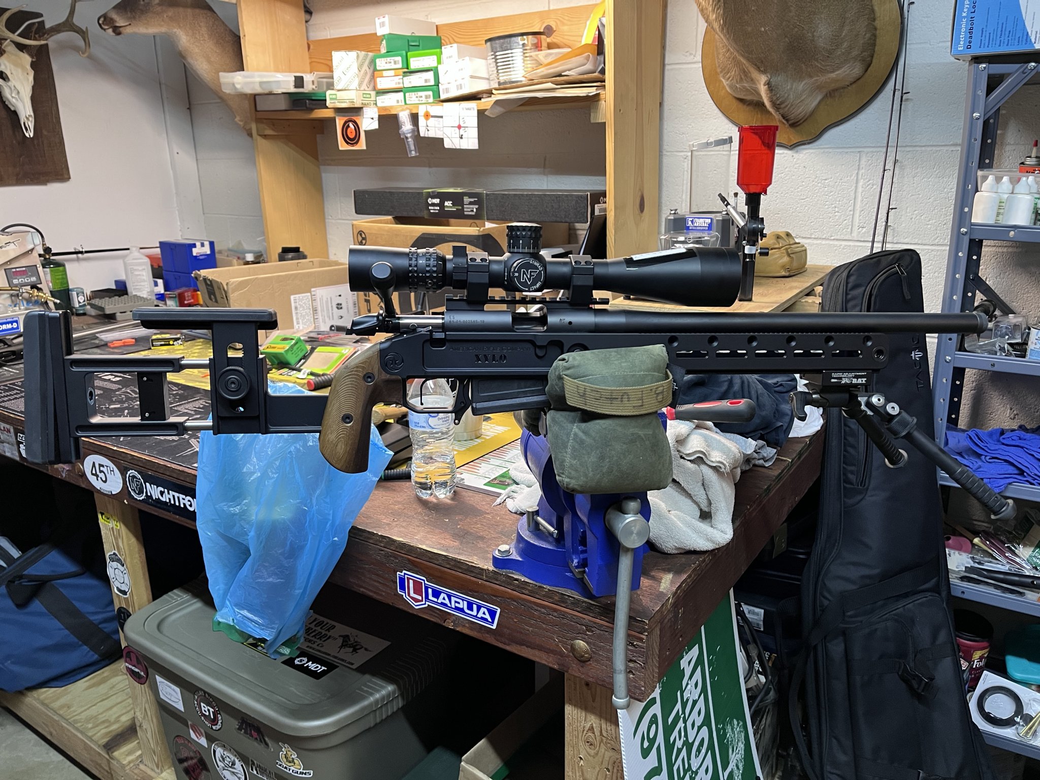

Well I decided to give mine a shot. The mag would not latch into the mag release before it bottomed out on the action. I could hold the mag in against the action and it would feed so I decided to alter the release. I took the release off and filed a little off the top until the mag would seat and lock in. Took me a few times to get it right but it now works with both my mags.
The chassis is a little back heavy but I took off the bag rider and it almost balances out perfectly.
I ran 50 rounds through it with no malfunctions.
View attachment 7828276Well I decided to give mine a shot. The mag would not latch into the mag release before it bottomed out on the action. I could hold the mag in against the action and it would feed so I decided to alter the release. I took the release off and filed a little off the top until the mag would seat and lock in. Took me a few times to get it right but it now works with both my mags.
Did you have any issues with the recoil lug clamp?
