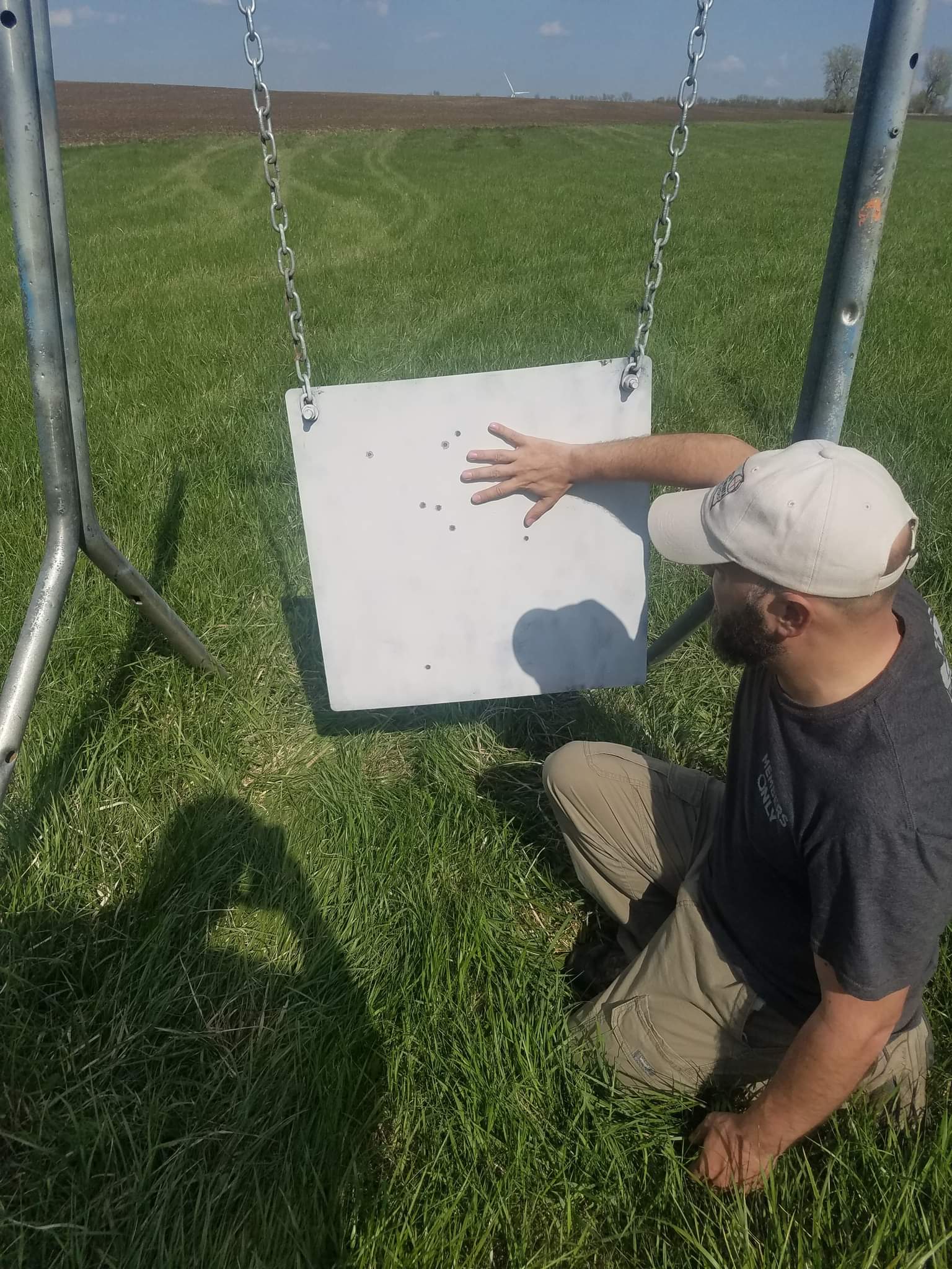

Just before heading to NRL22 Championship late May. Bergara carbon B14R.
Fired 10 and lost the first two due to elevation being slightly off. Wind was 4-8mph 3/4 value. The way low one was shot #4. Not sure what happened there. Fate I guess. 😁
The rest were there by my hand with my aim being near that impact my pointer finger is pointing at. I should have painted an aiming point or water line but was in a hurry.
I've shot out that far before at matches but for the most part I don't have the ammo to waste shooting beyond 300yds.
Not saying its super great...its the only documented group beyond 200yds I got. Probably 10" if you don't include the super low one.
