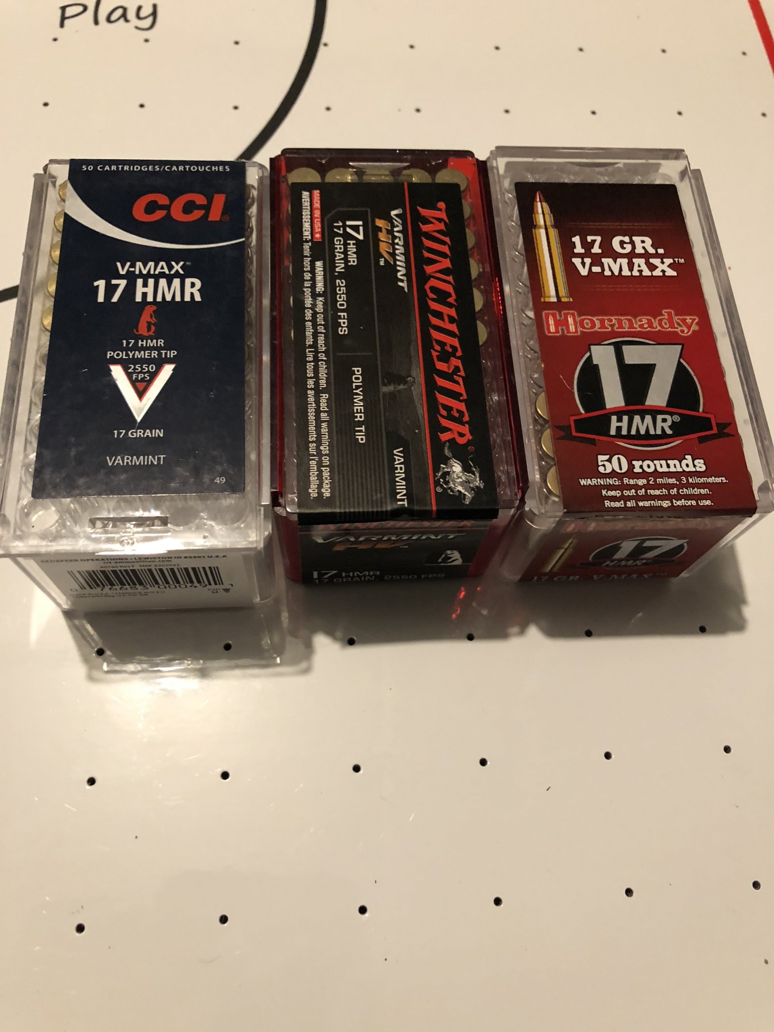

So I just acquired this Savage B17 HVSS with a Vortex 2x7 scope. Maiden range trip didn’t produce what I was hoping for after reading all the rave accuracy results people have with .17hmr. Pics below of the best 35 yard groups form the 3 Ammo’s that I tried. I plan on trying a few more different loads next trip out. I also mounted a Nikon 3x9x40 on it to help really zero in. Is there anything else I may be able to do in helping the accuracy as far as the rifle is concerned? The rifle was new and now has 75 rounds through it.
