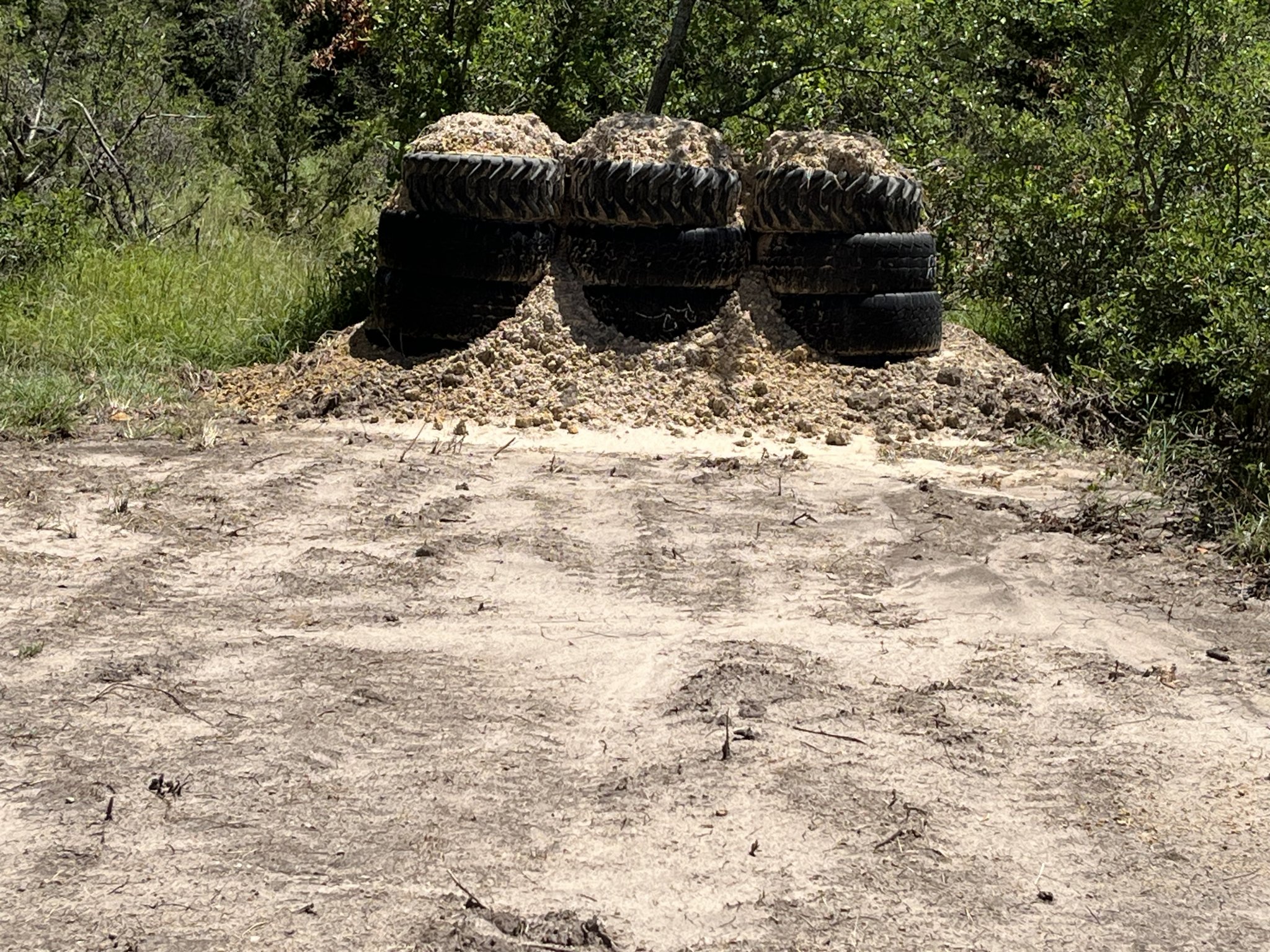

When I had my own place( sold it 7 yrs ago ) I had a bunch of off road tires , I stacked them three wide and thee deep and filled with dirt , then covered with more dirt , that was my 600yrd backstop worked purty good , till the cows started playing king of the hill on it , still held up for the last 4 yrs I was there.

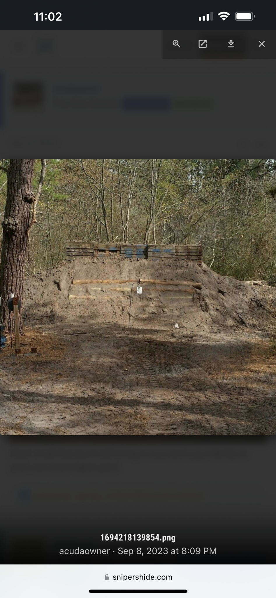

So it would just be better to leave the RR Ties off the top. Makes sense. So how deep do the Specs say for Rifle rounds up to 30-06?
The "spec" is that the berm needs to be 20' high. With a 2/1 slope that means it would be 40' deep.....the front 24" of that berm- the shooting face- should not have anything larger than 1" as part of it- no rocks etc.....The interior of the 40' could be dang near anything- it's really just there to prevent slumping of the primary impact face.

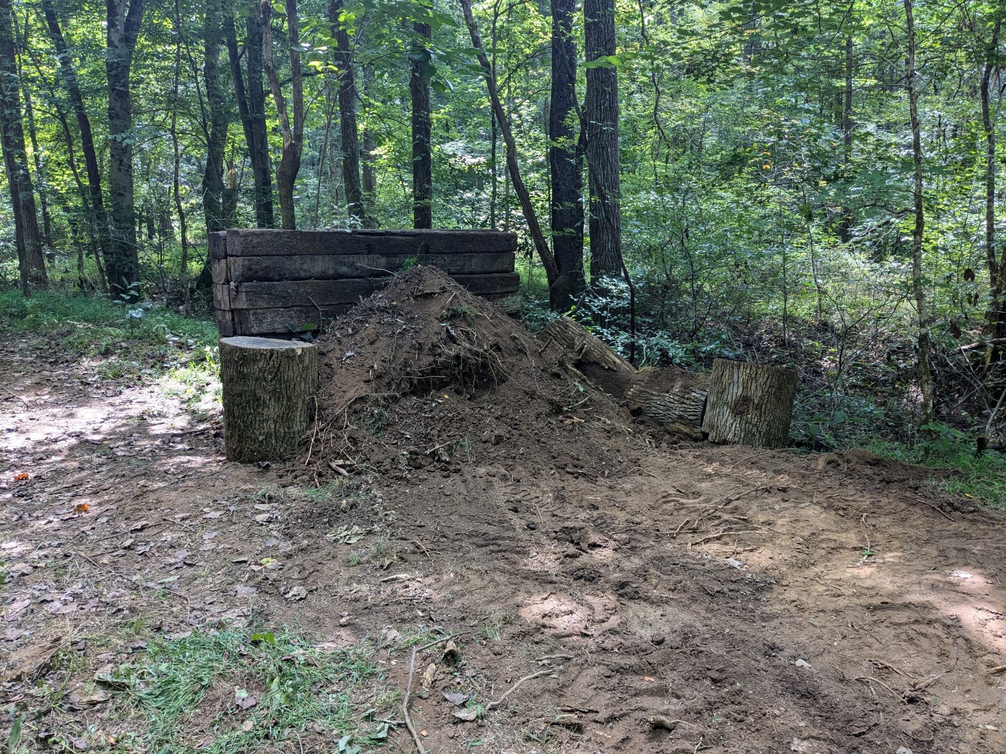

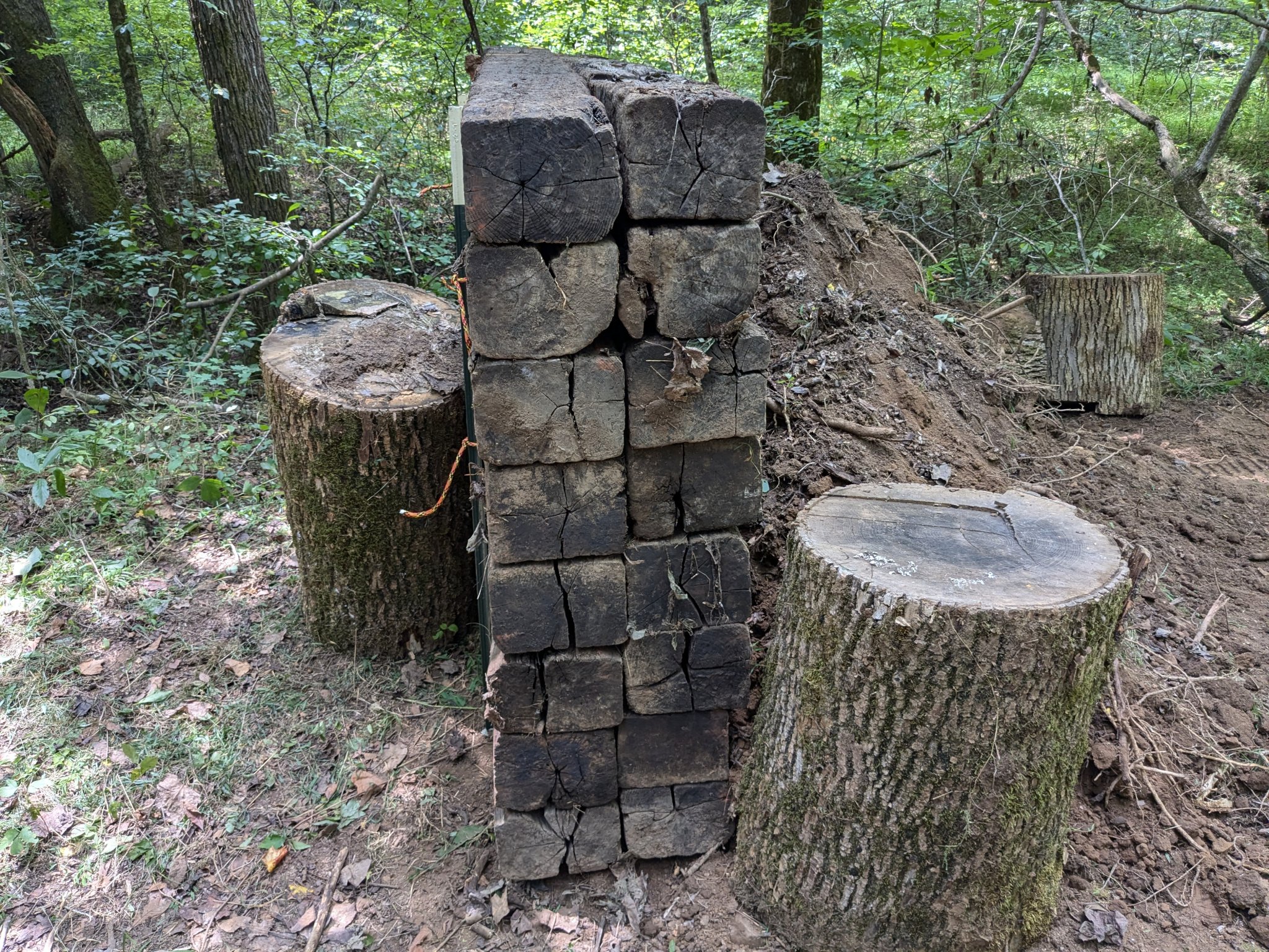

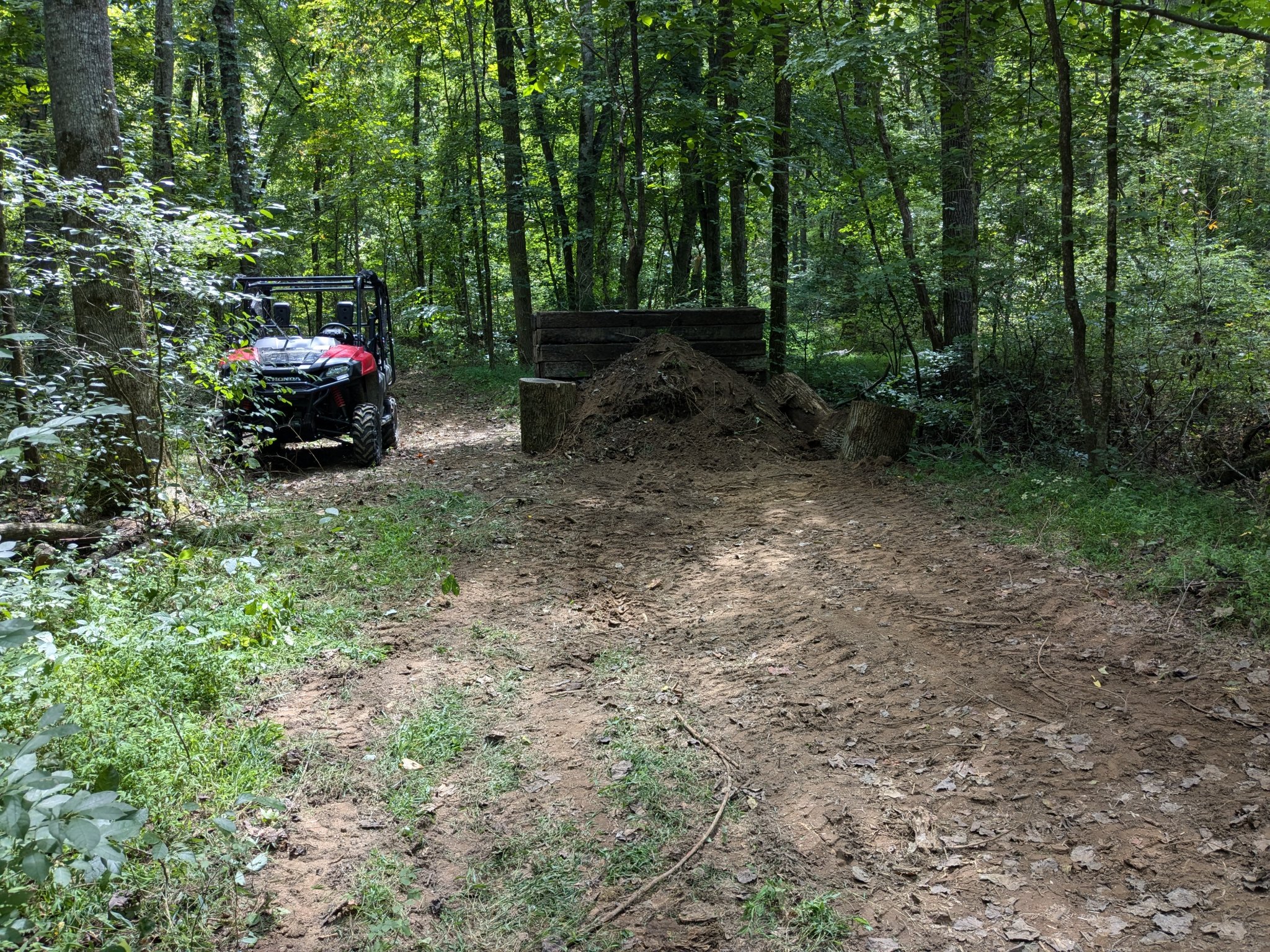

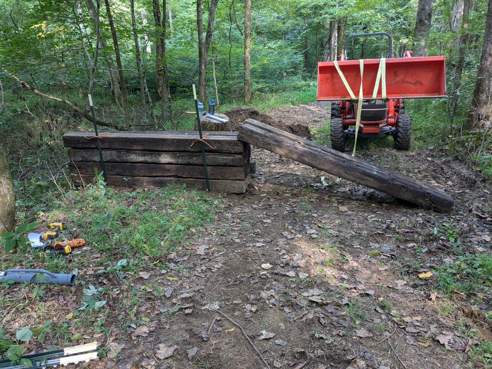

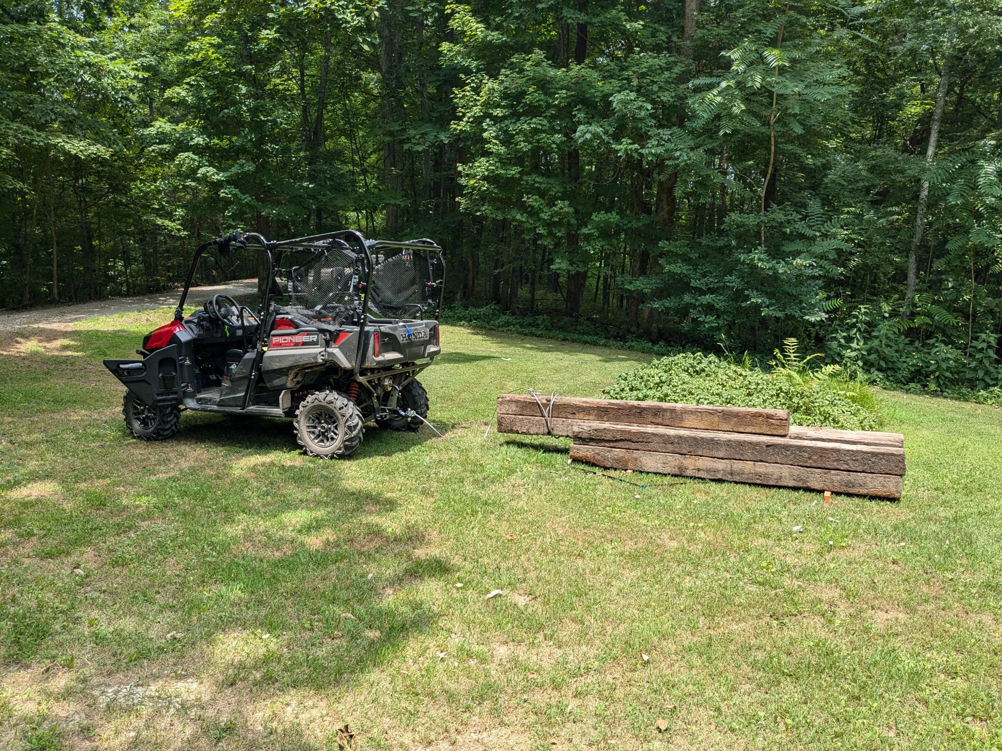

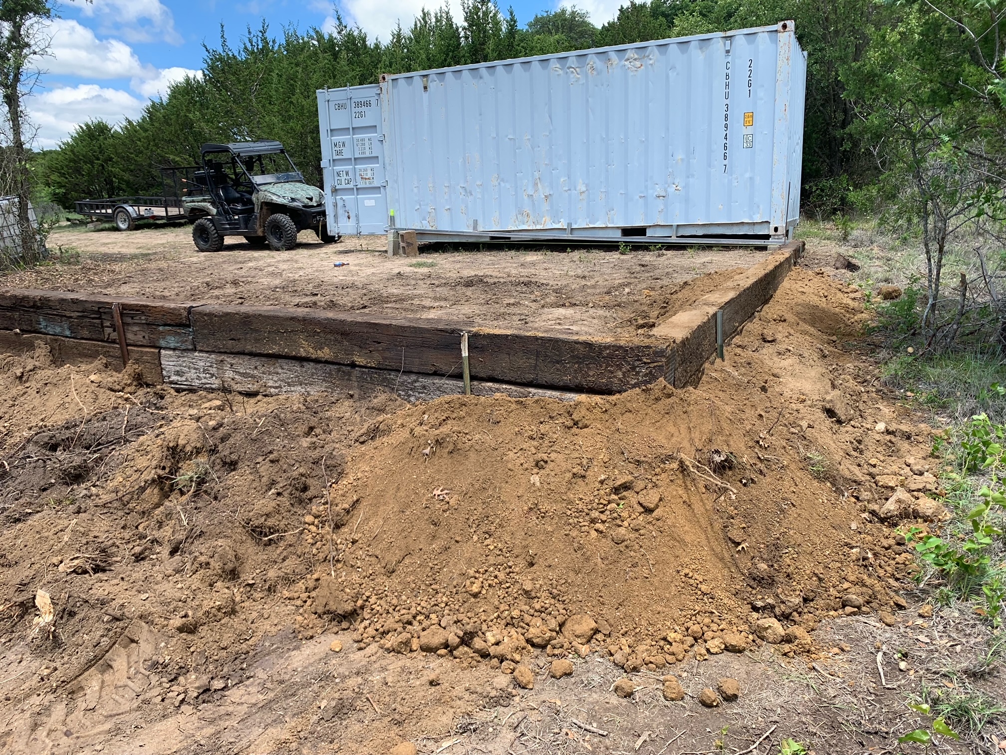

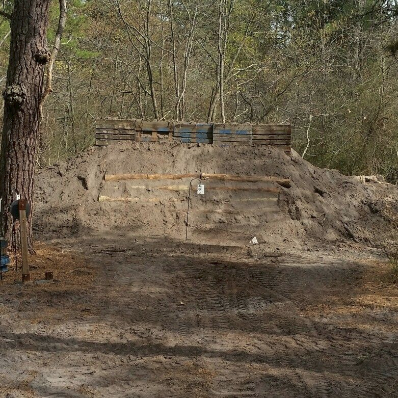

Made some progress recently, in late June I drug all 16 RR ties from the stack they were delivered in down into position with my buggy, but then was out of town or busy until last weekend.

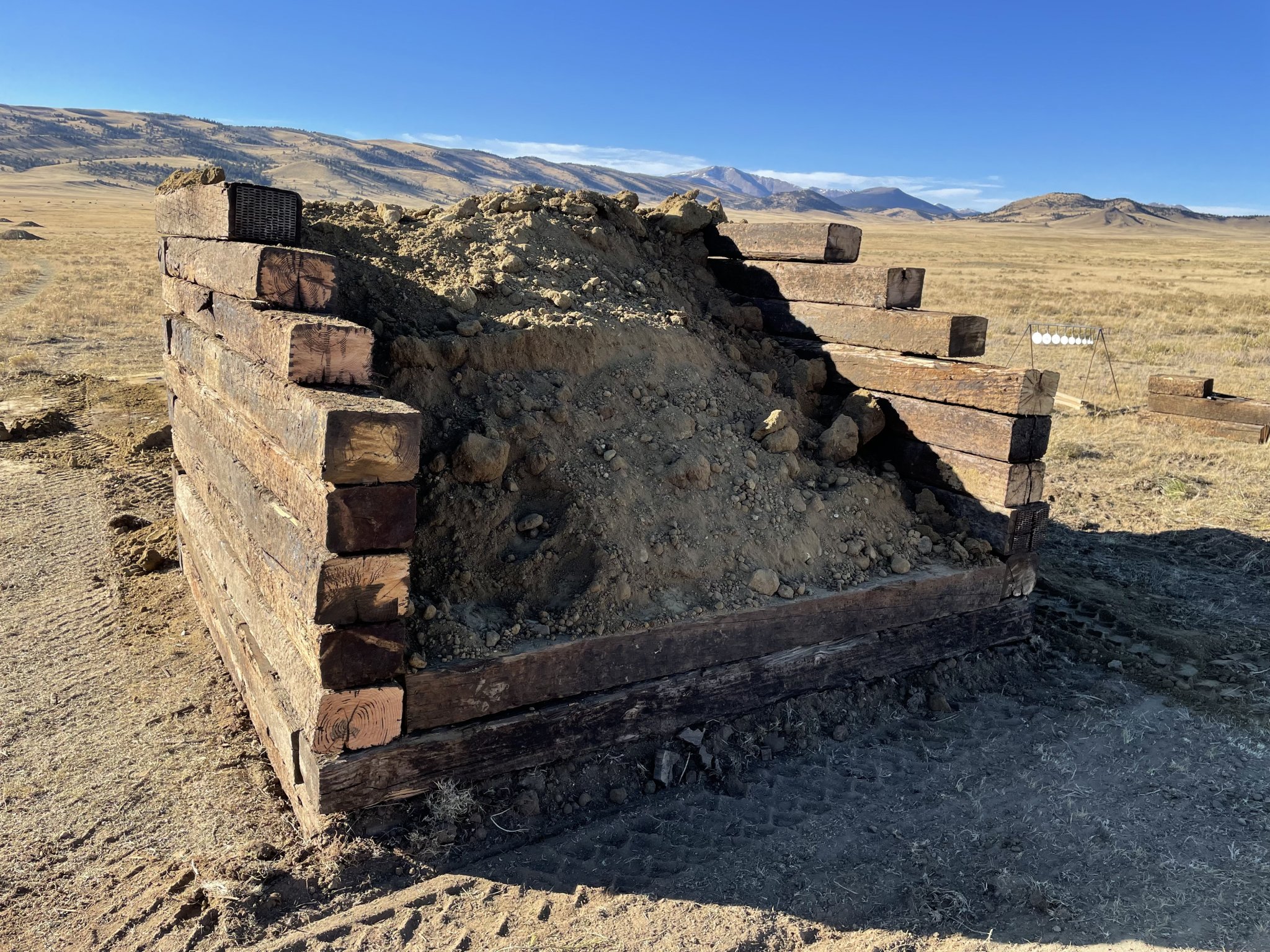

Looking from the berm area back towards where the bench will be, RR ties stacked 4 wide on the right of the trail.
My neighbor graciously came over to help, we stacked the first 4 ties by hand, but that was pretty back breaking, so we moved to lifting them up and moving them over to the tie wall with the tractor and then pushing them into place by hand which was far easier.
Neighbor recommended wiring the t-posts in the back to a nail driven into the ties every so often to stabilize them until dirt was pushed up. I didn't have any wire on hand so wound up using some rope.
I used some 14" lags to try to screw the tie wall together front to back and top to bottom. Got a bunch stuck and I think I overheated a few impacts, but got everything attached.
I'm going to stack up more dirt in front of the wall, but there it is.
View from where the 100yd bench will be, you can see the berm at the end.
Next steps are to stack up more dirt as mentioned, then figure out what to do about the shooting bench.

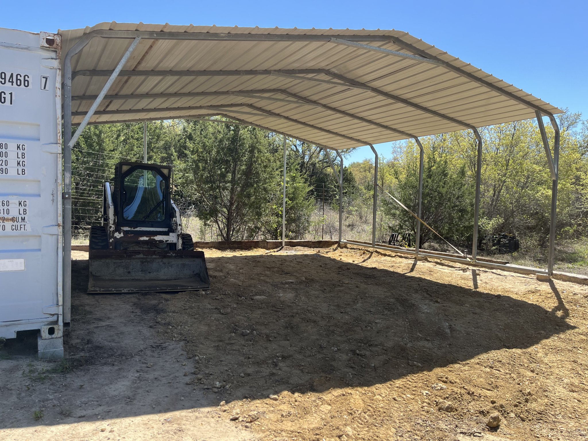

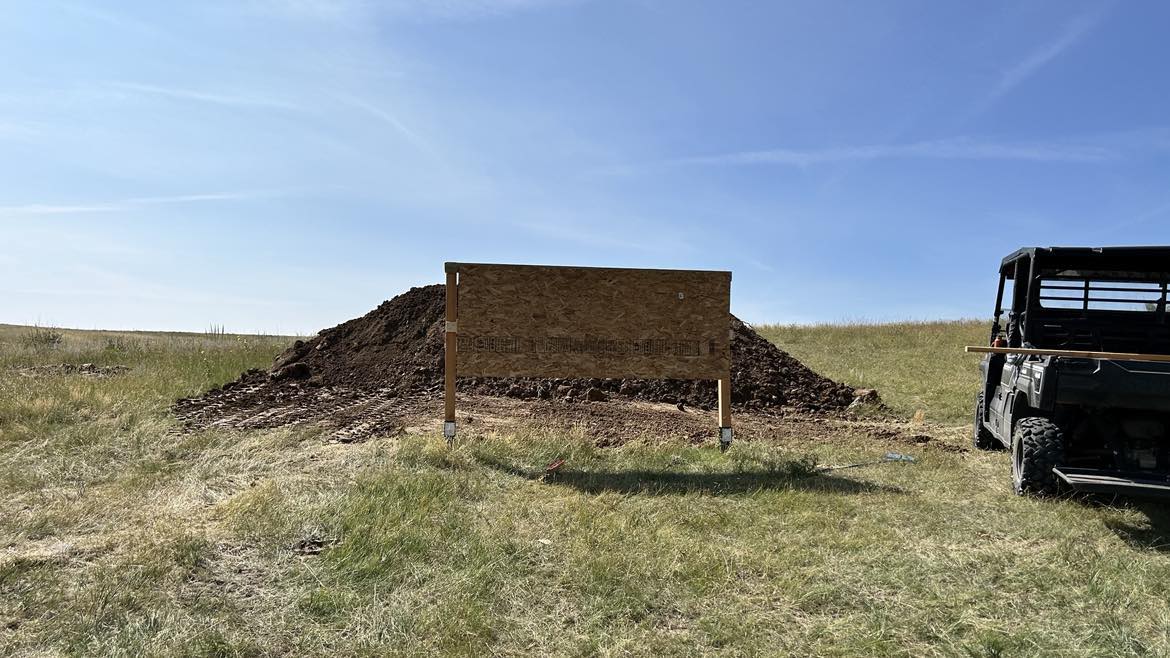

Have a similar on going project at our weekend place. Had my truck tires replaced and then picked up a few more from behind their shop. Spent a few weekends clearing trees/brush and stacked and packed the tires in front of a dirt berm. Although is only about 12' by 5', I will say that there's another 1100+ yards of trees and brush on my property behind it.
Then picked up a carport port that someone had taken down and proceeded to make some shade for a portable bench I had. The ties intended for the backstop were repurposed for that project. Set the them against some t-posts and drilled and drove rebar through each layer.
Neither the back stop or the carport are finished at this point, our dirt is about the same consistency as concrete this time of year, but the range is functional.
