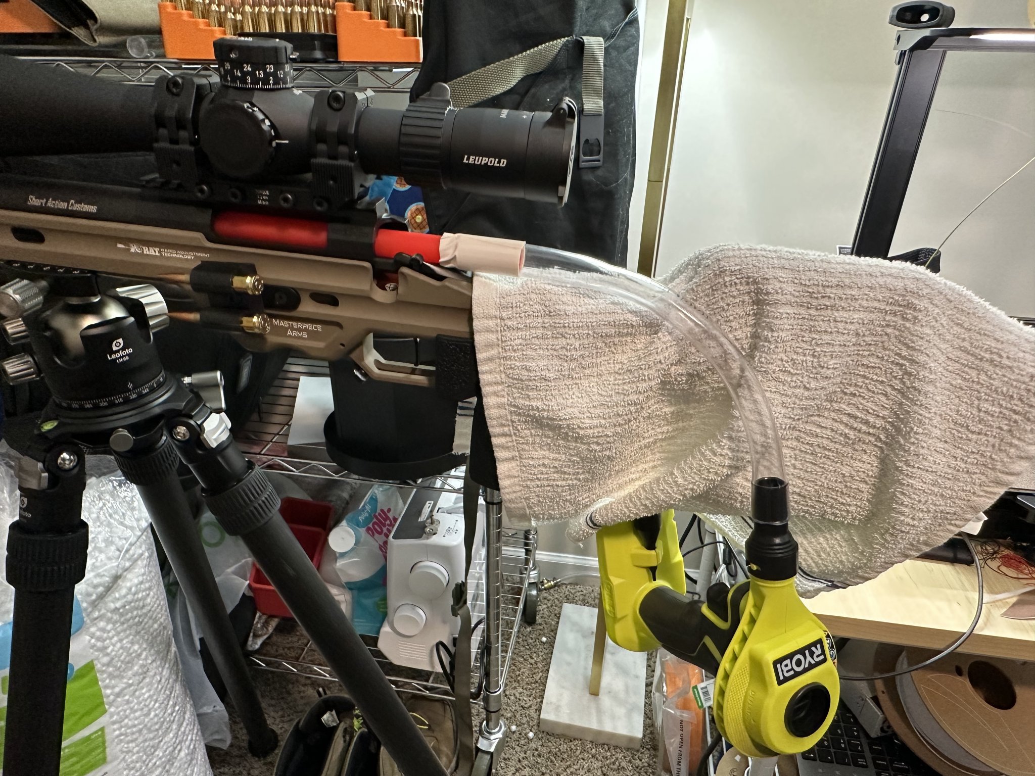

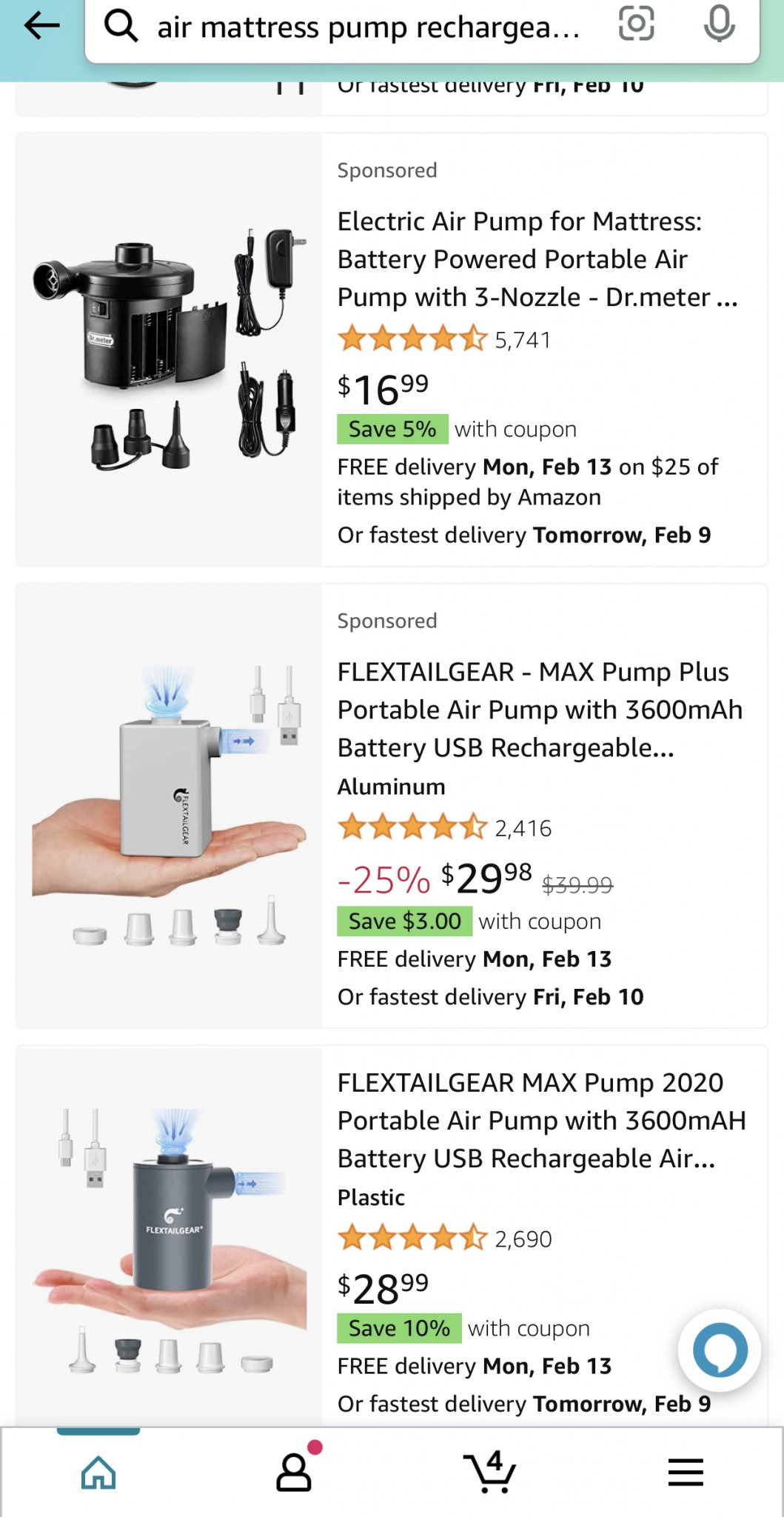

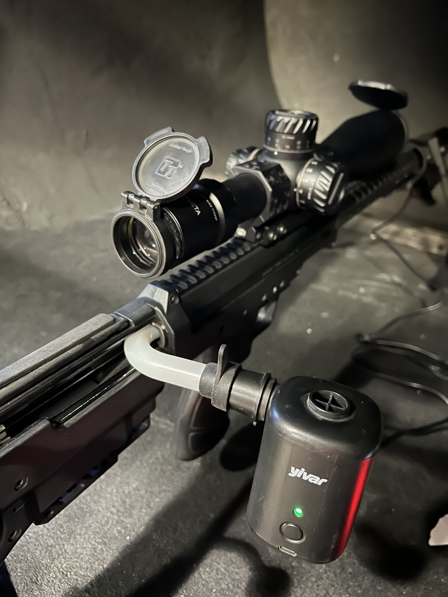

    If you’ve tried one of the commercial offerings, you were probably disappointed with airflow, battery life, or the whole shebang. That inspired me first to buy a rechargeable mattress inflator on Amazon for about $25 and rig a plastic pipe elbow so that it will generally fit in the bolt raceway pointed towards the chamber. That thing blows air out the suppressor of a 26 inch barrel at between 5 and 10 mph and cools the barrel extremely well. The only problem being that it has limited battery life & takes a while to charge on a USB port, and will not run off of an auxiliary battery USB port when battery dead/charging. So when it's dead it's dead for several hours till you get it recharged. FWIW, it does last for about 40 minutes of blowing, which is a pretty good range day.

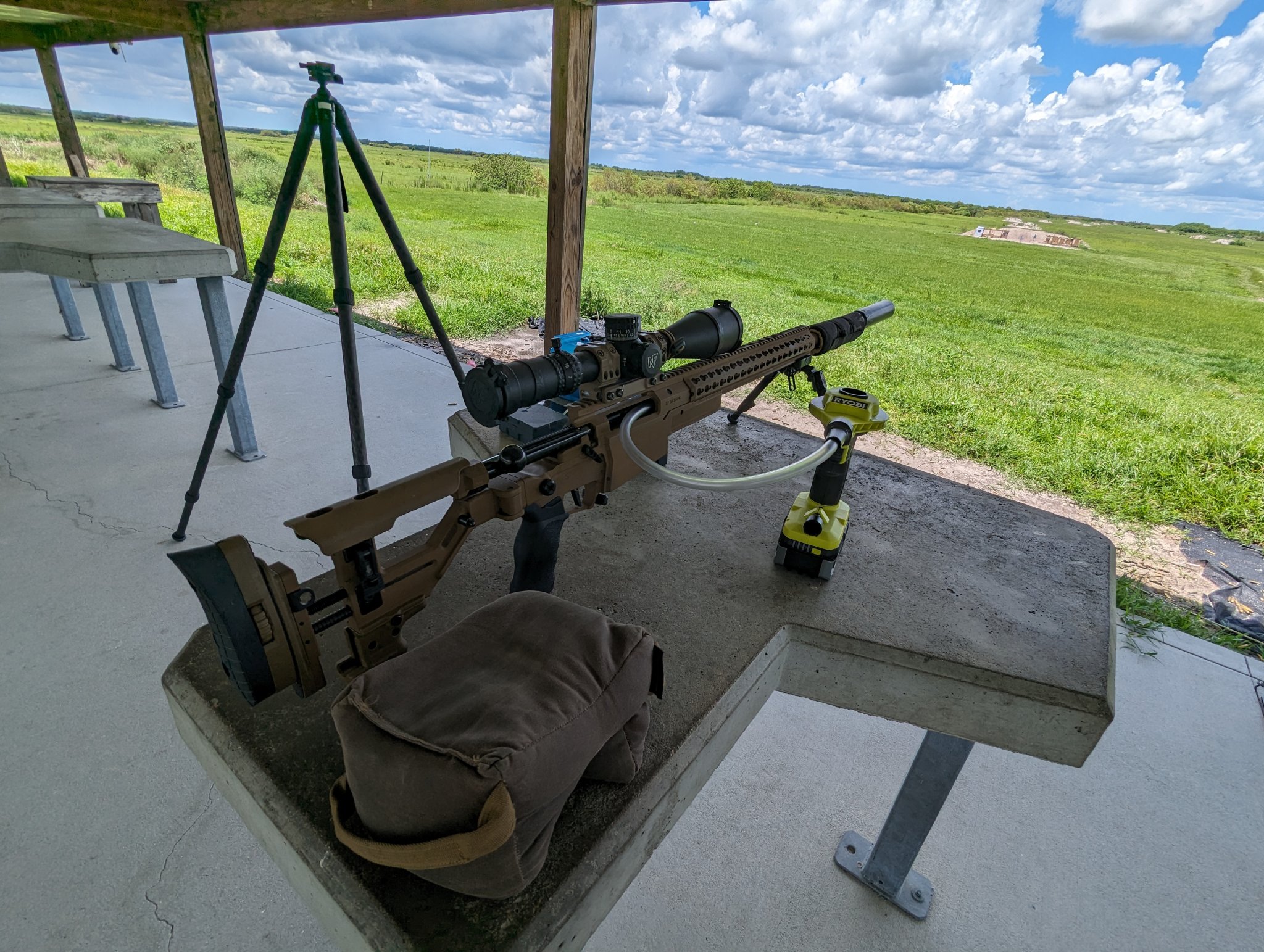

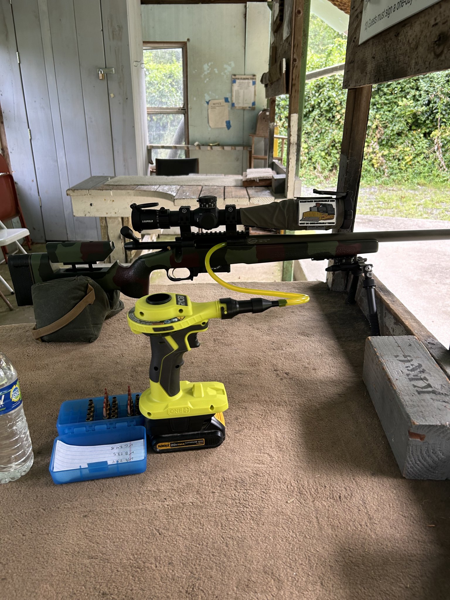

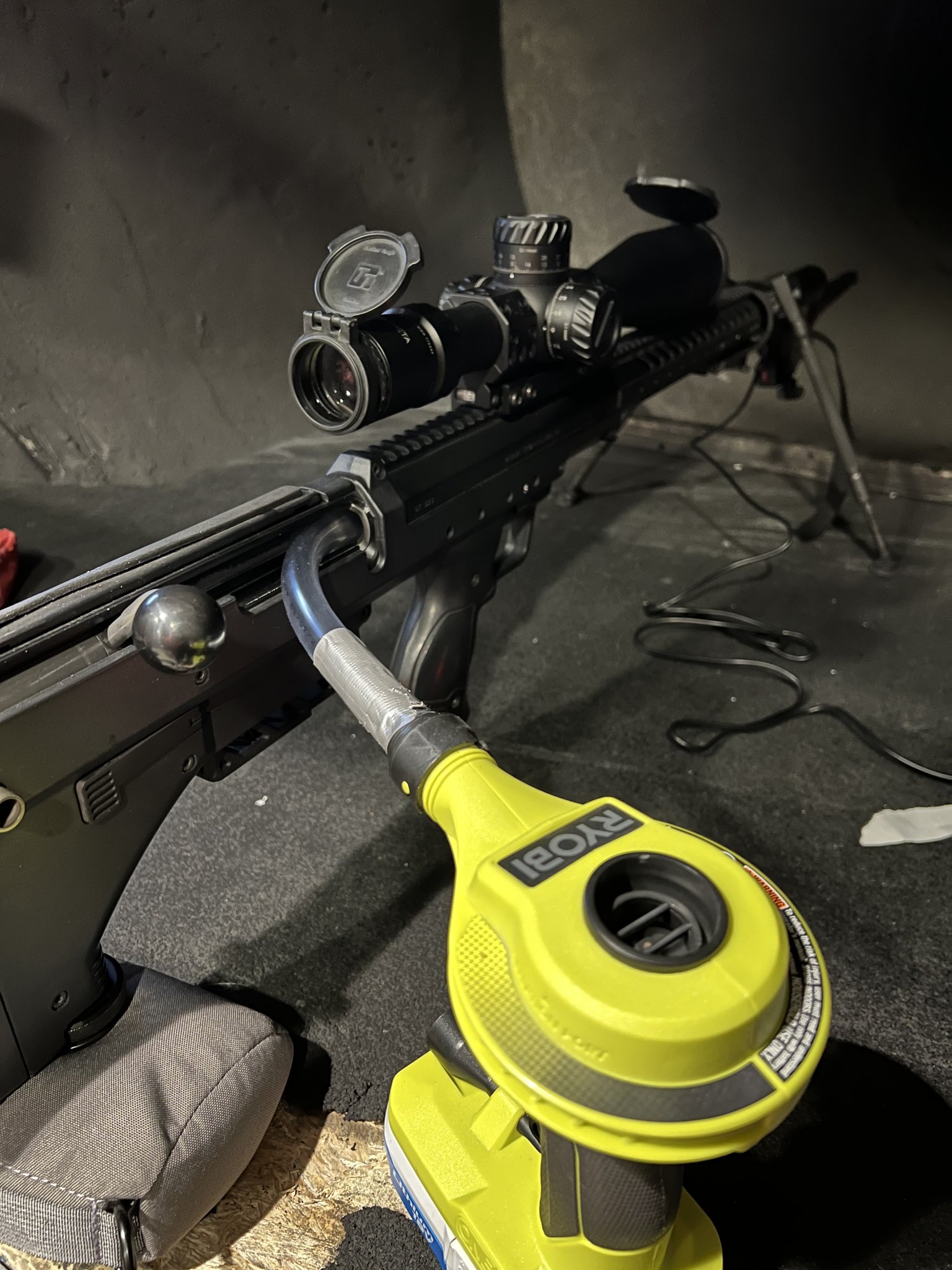

    Then, my brother showed me that the toolmakers like Ryobi and Milwaukee are now making an accessory for the 18v lithium batteries that is basically a high velocity air blower. For cleaning out workspaces, inflating stuff, and whatnot. I got a piece of plastic tubing that likewise fits in the ejection port and up towards the chamber and just duct taped it to the nozzle head of the Ryobi blower and that sucker blows air out the suppressor end at like 15-20 miles an hour. It’s ridiculous, how much air it blows. It will blow for several hours on one charge and I’m sure you have spare batteries in your truck like I do.
    Now I can run those 20 shot groups that the Hornady guys were talking about on podcast 50 lol. Seriously though. 10 shots. Cool. Repeat.

    If you’ve tried one of the commercial offerings, you were probably disappointed with airflow, battery life, or the whole shebang. That inspired me first to buy a rechargeable mattress inflator on Amazon for about $25 and rig a plastic pipe elbow so that it will generally fit in the boat raceway pointed towards the chamber. That thing blows air out the suppressor of a 26 inch rifle at between five and 10 mph and cools The barrel extremely well. The only problem being that it has limited battery life takes a while to charge on a USB port, and will not run off of an auxiliary battery USB port when battery dead/charging.
    Then, my brother showed me that the toolmakers like Ryobi and Milwaukee are now making an accessory for the 18v lithium batteries that is basically a high velocity air blower. For cleaning out workspaces and whatnot. I got a piece of plastic tubing that likewise fits in the ejection port and up towards the chamber and just duct taped it to the nozzle head of the Ryobi blower and that sucker blows air out the suppressor end at like 15-20 miles an hour. It’s ridiculous It will blow for several hours on one charge and I’m sure you have spare batteries in your truck like I do.

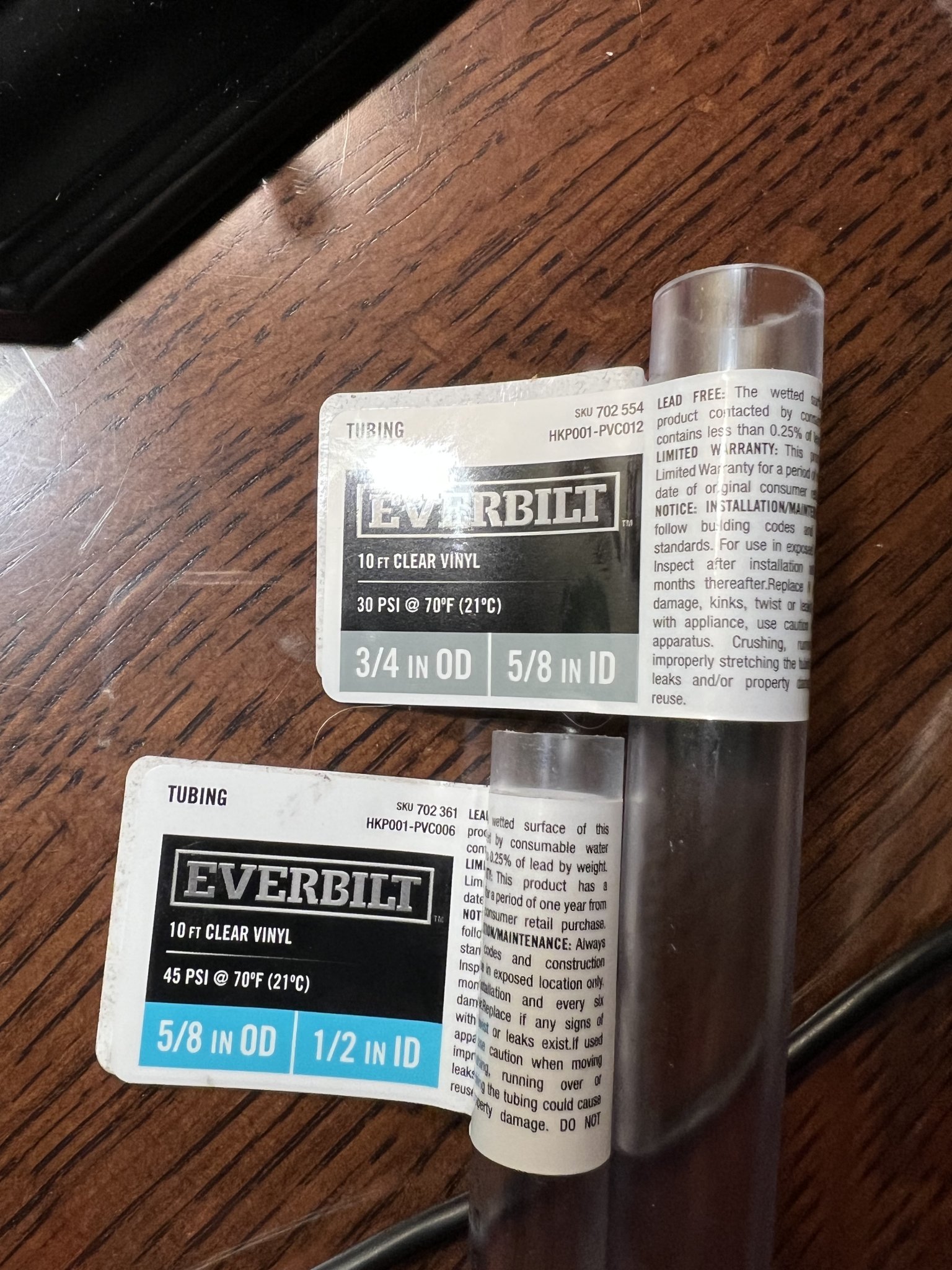

    Awesome idea, what is the ID of the hose that fits?

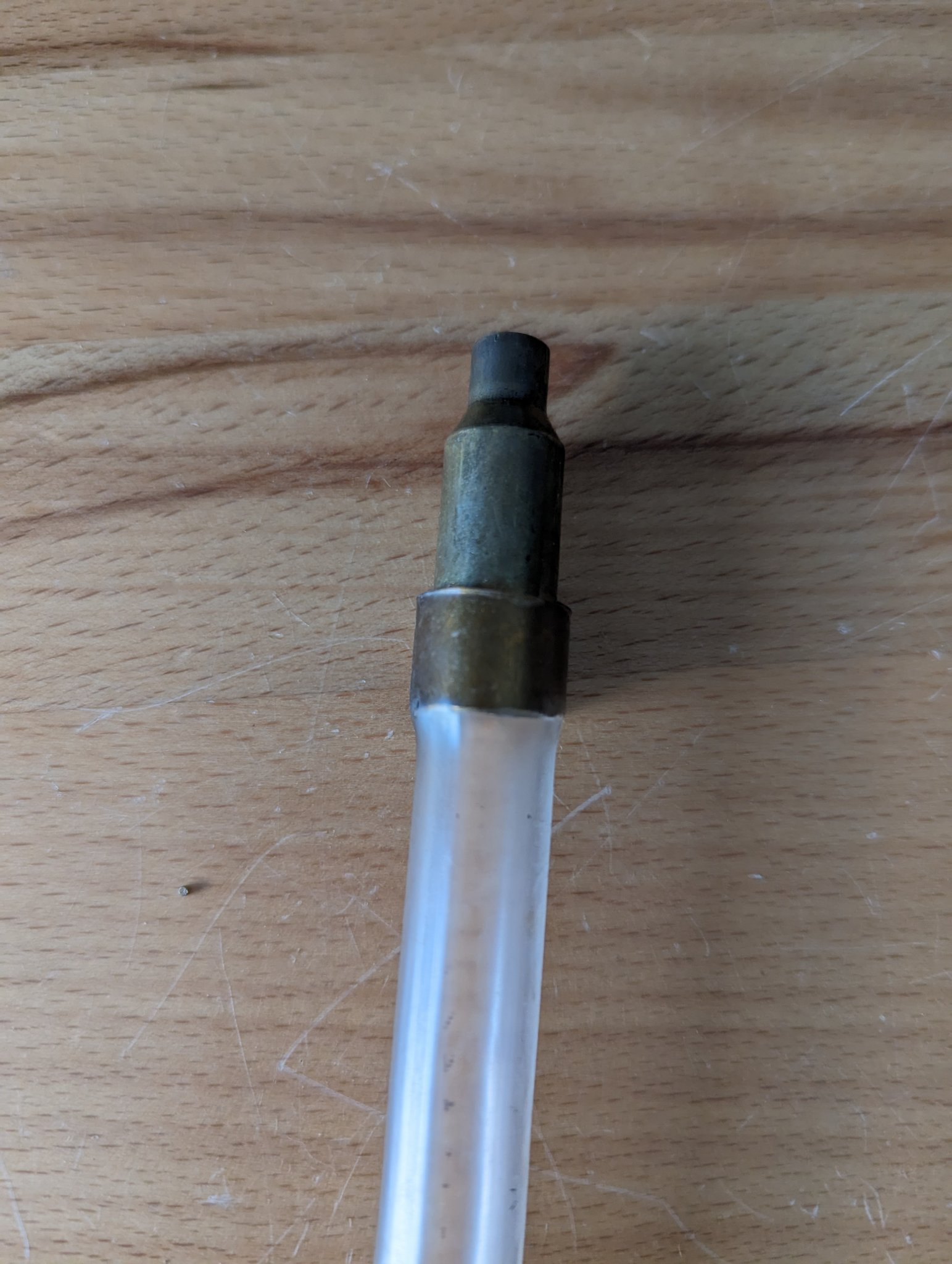

    well, the Ryobi attachment is 5/8" and a 5/8" ID & 3/4" OD tubing can be stretched slightly to fit. However, the 3/4" OD of that tubing and won't fit in the bolt raceway/slot without deforming it into an ovoid shape, and then won't allow you to jam it up in the chamber where the bolt head goes. So it's better to just duck tape a piece of 5/8" OD and 1/2" ID pipe/tube. This ain't a museum piece.
    In fact I just tested it. I got 11 MPH with the kestrel and a 22.5" SAC .223 barrel and SiCo SAKER 762 suppressor attached with the bigger tube. With the smaller tube and duck tape I got 14.7 MPH. Blowback with the former was significant, and barely noticeable with the latter because you can jam it up in the chamber better. With larger calibers (e.g, my 338 or 50 BMG), the exiting MPH is even greater, because of reduced resistance with increased cross sectional area of the bore.

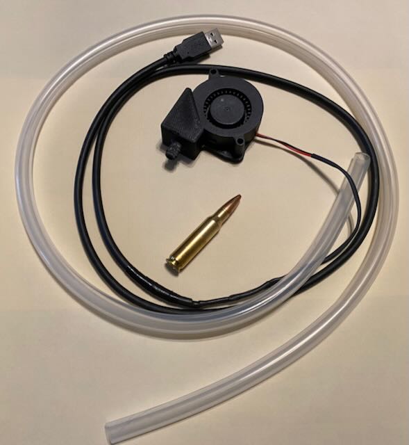

    A few years back I found a 3D printer model of a blower adaptor for DC blower fans. I had one made and found a DC blower fan on Amazon that I could power with a USB lithium battery pack. It works, but I'm only able to move air at 3 MPH through the silicone tube. There's no filter on the intake...
    The unit is fairly small. The USB cable and silicone tubing take up the most space. That's a .308 round in the image for reference.
    3D Printed Blower Model
    DC Blower Fans

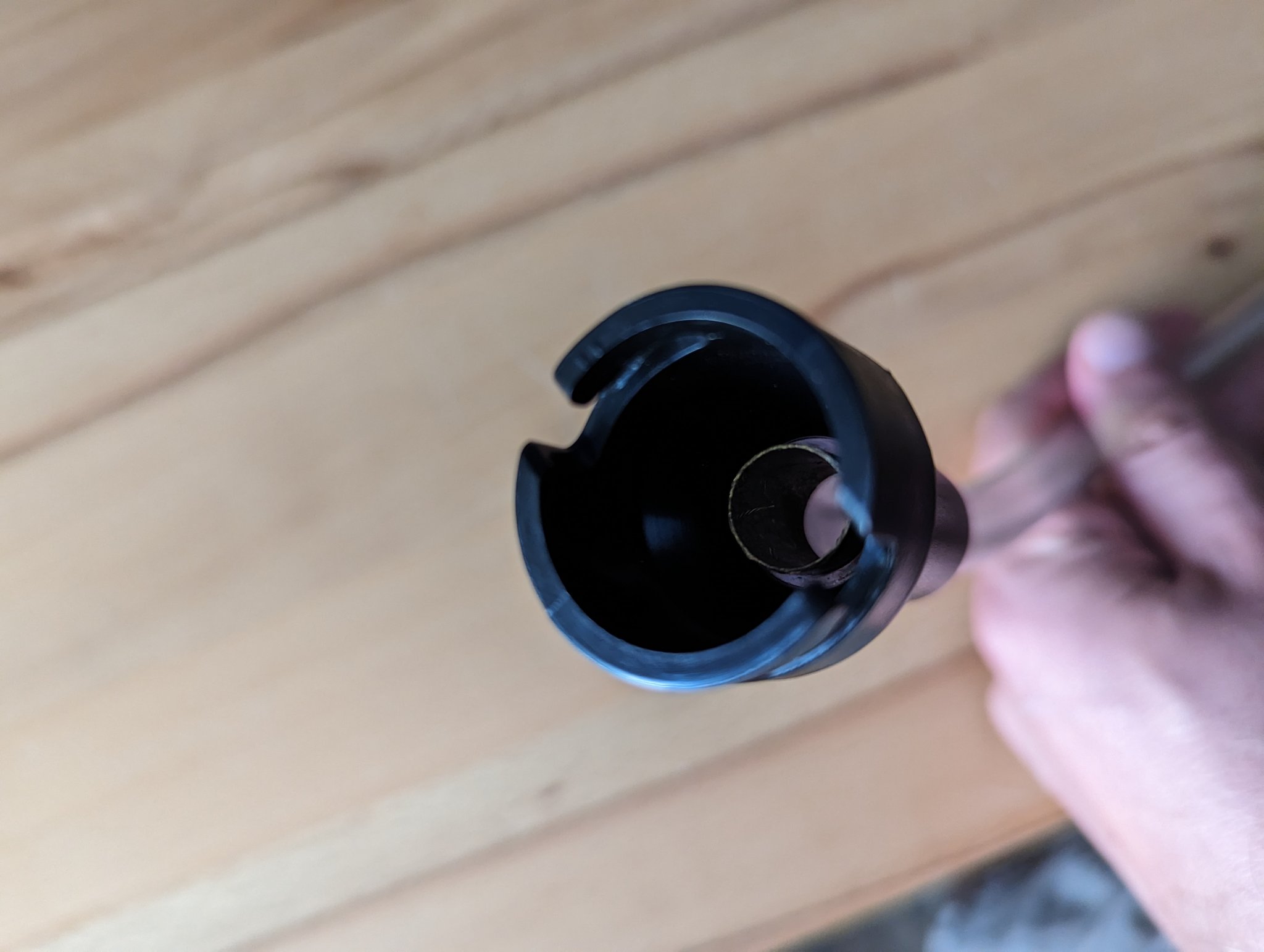

    Yeah that was my though too, if you can get the nozzle geometry right and straiten the flow down the bore axis you can pretty much count on a good chunk of the flow to reach into the chamber.
    You know, there’s a lot of bore guides already being made. A cool idea would be to have one made without a solvent port and just hook a hose up to that.
    I think I have an extra bore guide laying about. Perhaps I’ll cut off the solvent port (if it has one, can’t remember), buy that Ryobi thing, buy a hose, and give it a whirl.

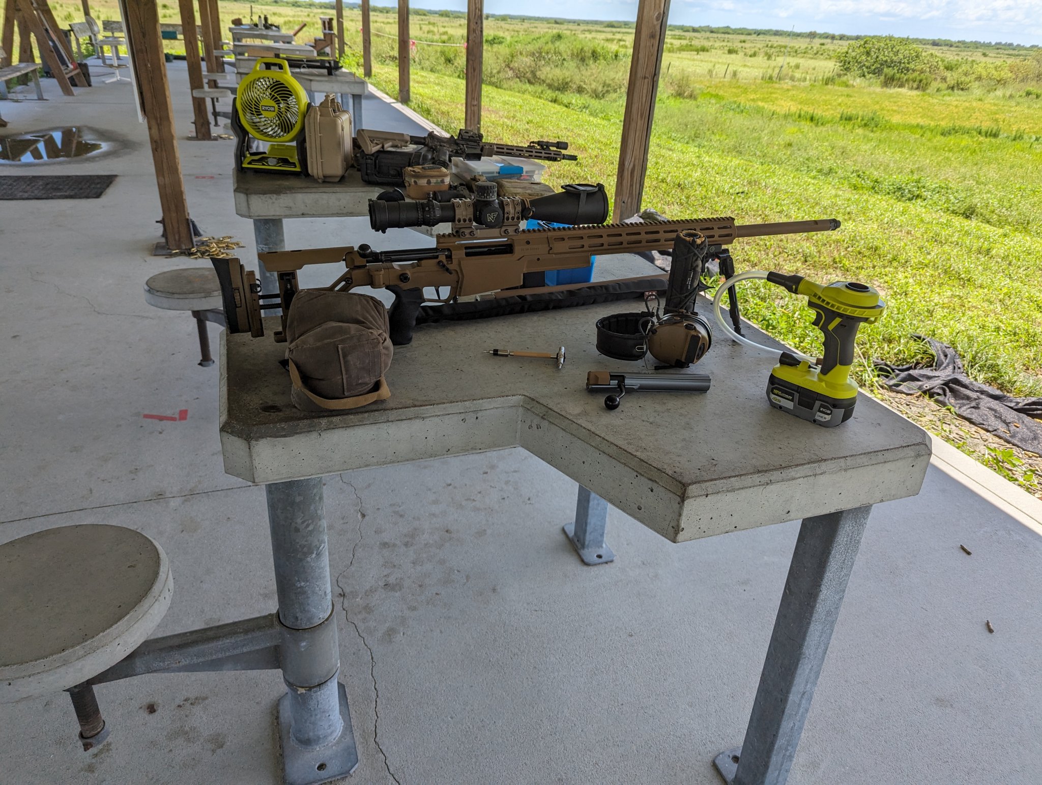

    I just picked up one of the Ryobis. Holy shit that thing is a little turbo! Loud little guy. Glad everyone at the range has earpro lol.
    I have a bunch of step-up and step-down vacuum cleaner hose adapters. Gonna check to see if I can find a no-tape solution.
    Reactions: secondofangle2

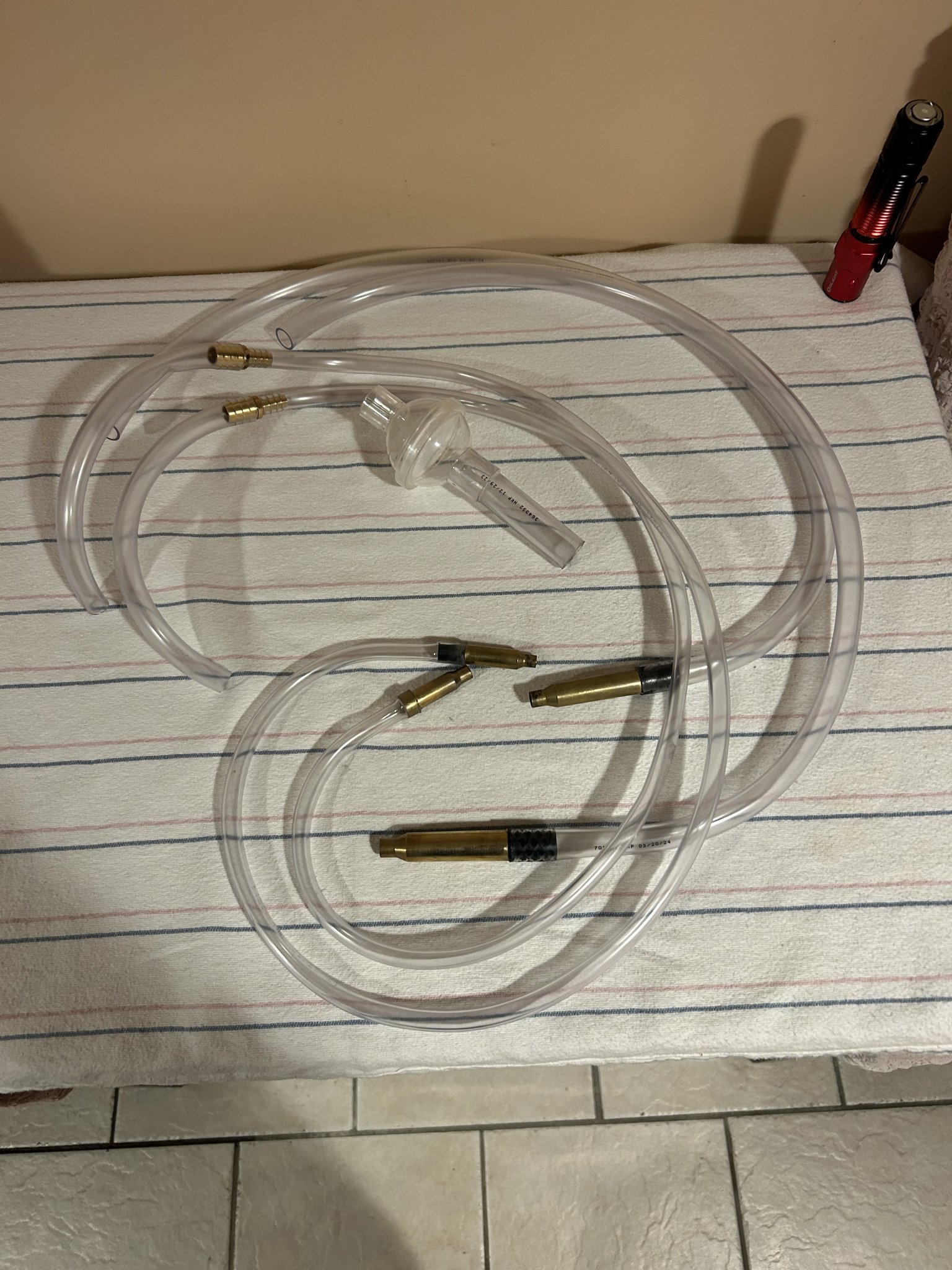

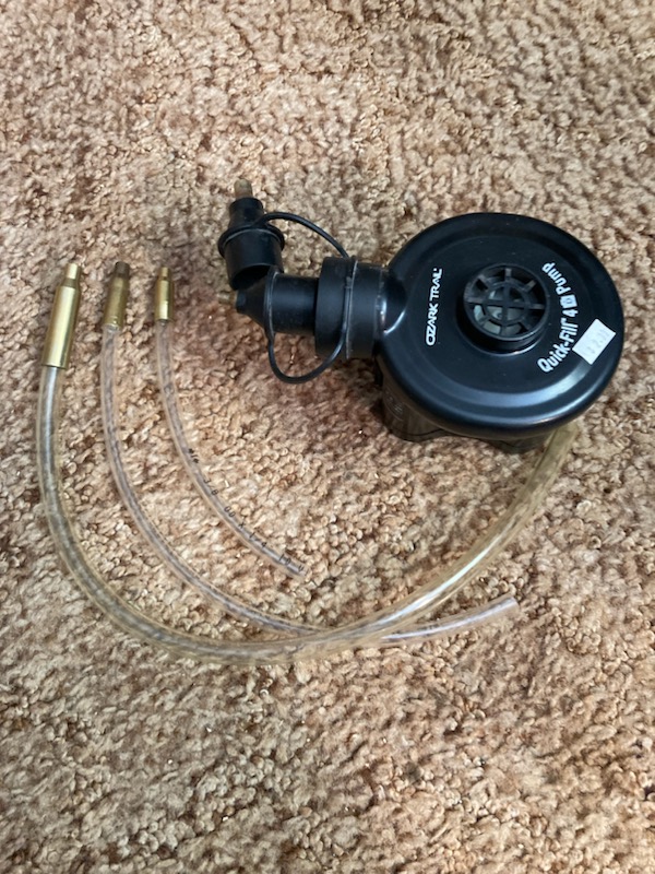

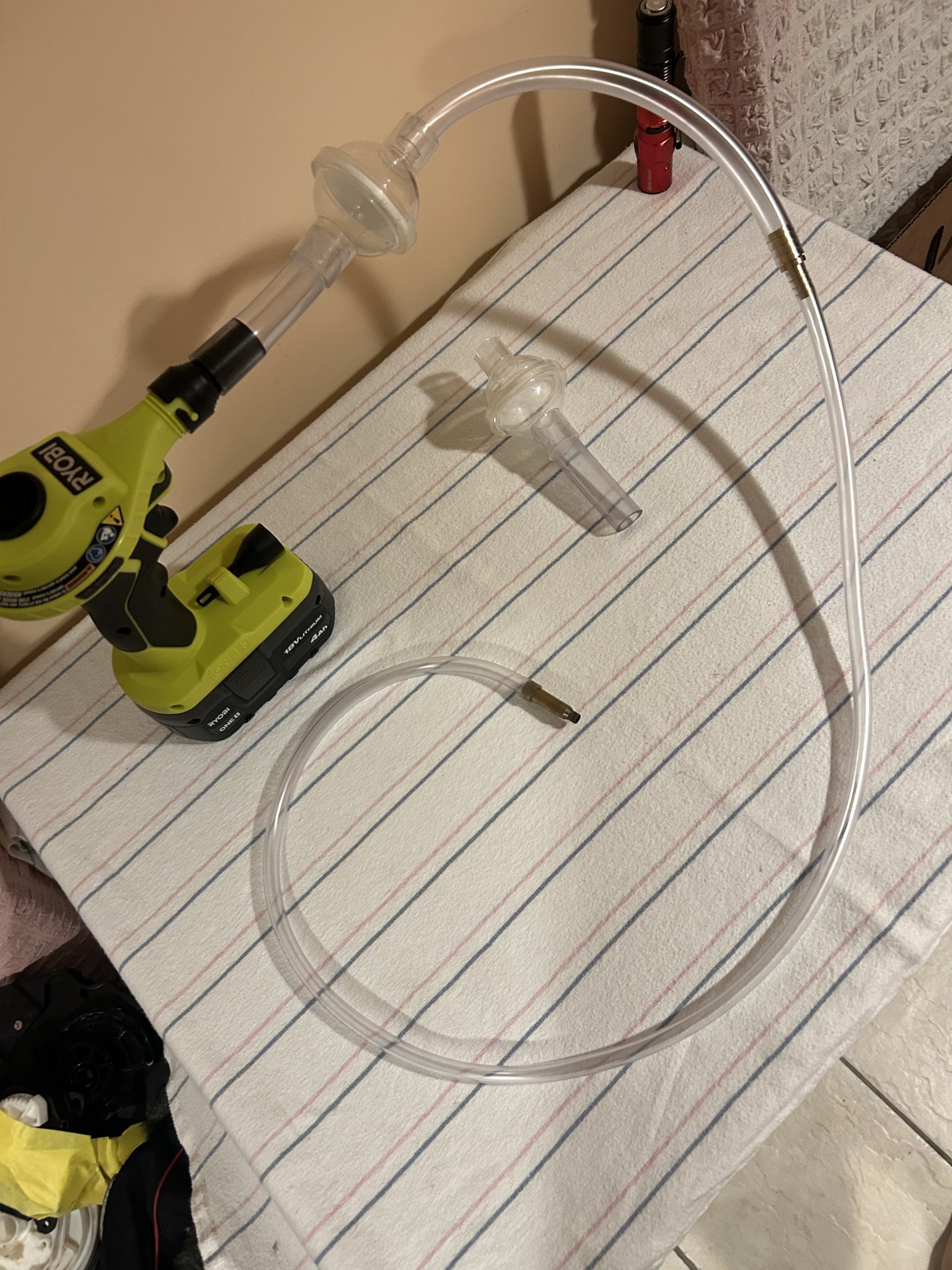

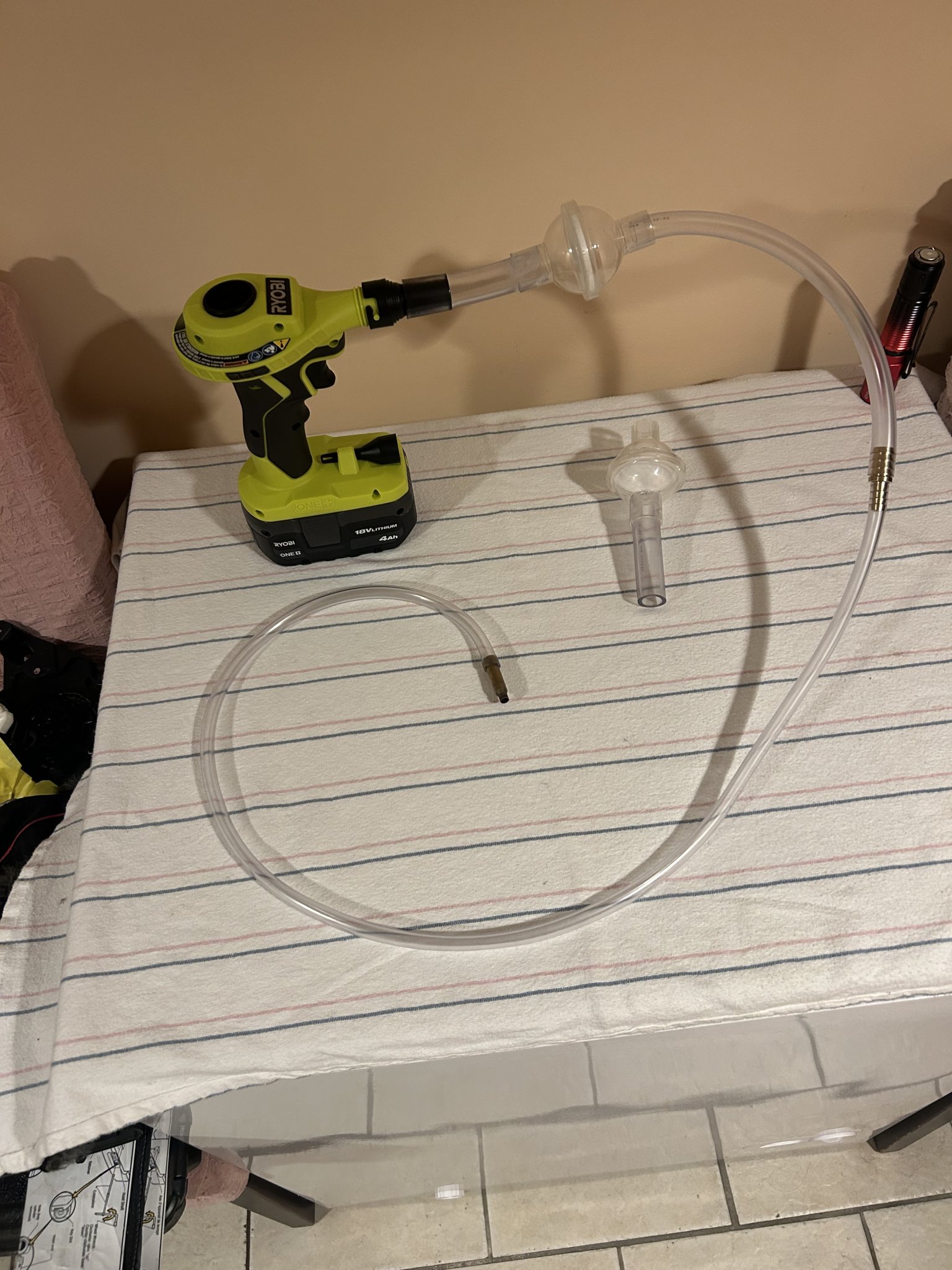

    Thanks for everyone, who has share idea and project.
    I sneak out to idea everyone in this post and build by custom cooler, get it hose dimension and connection pick from here.
    I'd like to share my project:
    Reactions: TylerN
