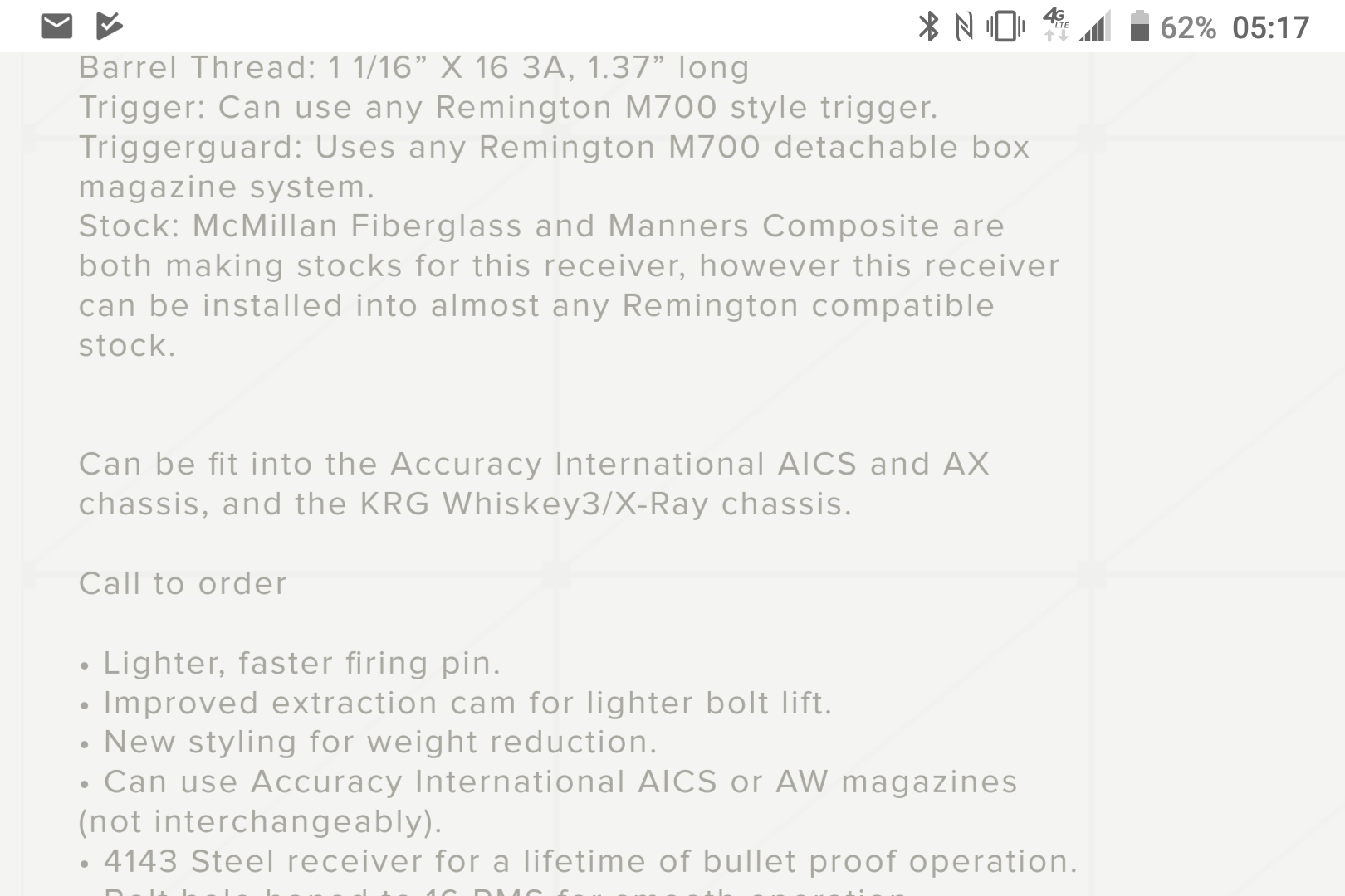

On the badger website, it says it can be set into an AI chassis and a couple KRG chassis.

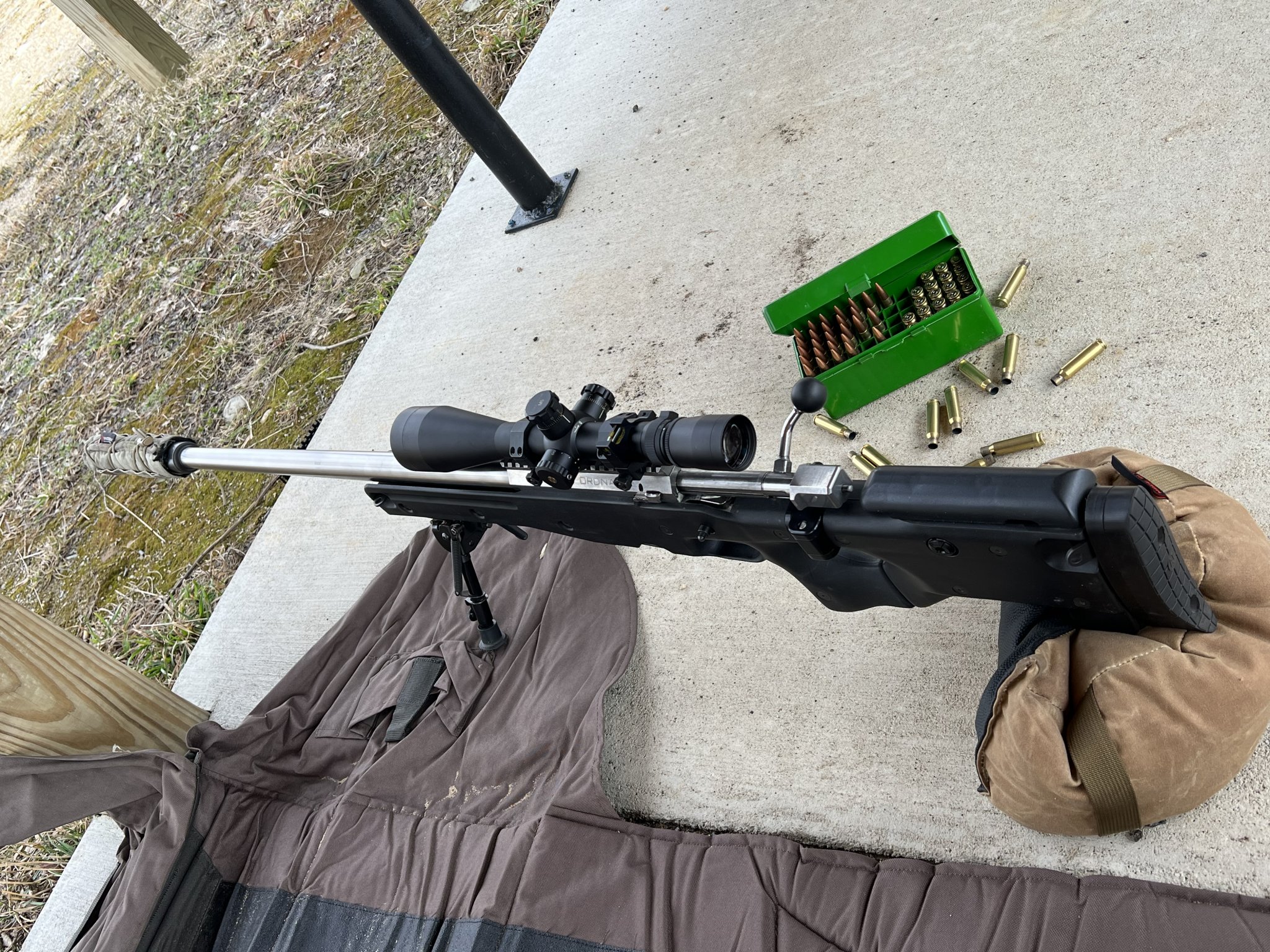

Mine's also in a KRG W3, unfortunately, KRG stopped producing M2013 short action inlets in 2017 (Oddly, the LA are still being sold). I would think it wouldn't be difficult to convert a R700 backbone to a M2013. The action screw spacing is the same and the inlet shape is flat. Other than the double recoil lugs, it seems straight forward.

Just chasing experience from anyone who has an AI and a Badger, could you tell me if the AI will drop into a Badger inlet? Reason for this is that McMillan don’t have an AI inlet but do inlet for Badger. Action screws will be irrelevant as it will be glued in 👍🏼

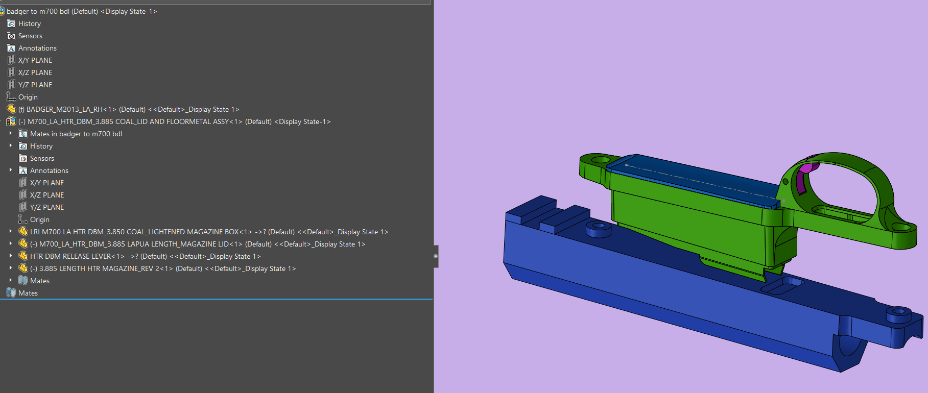

Two questions, can a R700 stock be inletted for a Badger ?
Can a Badger be set up with a mag box and BDL bottom metal or is it strictly a DBM only ?
Regarding stock work, virtually anything can be done with enough commitment and money. The Badger action is/was made next door to me, and I've fitted them for folks for over a decade. I have vetted CAD models on file.
As for the internal box question: This would be a very invasive and expensive option as the action lacks the internal feed lips for a typical staggered stack, staggered feed type arrangement. Twenty years ago, while at Nesika, we often set up actions for a staggered stack, center feed internal box on the WSM stuff (back when it was new). Using a Wyatt box, you'd have to push the cartridge body through the feed lips and hope they'd return to normal shape. In most instances, they'd start to yield, and the dern thing would turn into a jack in the box. If this were attempted on the Badger receiver, my gut says you'd have a similar result.
Off the cuff, the idea that comes to mind is to machine a frame that'd insert into the existing receiver mortise with the required feed lip geometry, but that is pure speculation. It would have some front-end work to see how feasible it is. The good news is that on a L/A, the hole spacing for guard screws matches the M700 (7.345"), which helps. The bolt also has plenty of face surface area for case purchase during feeding. As I stated, the big question is recreating feed lip geometry into the receiver.
