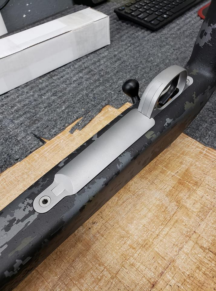

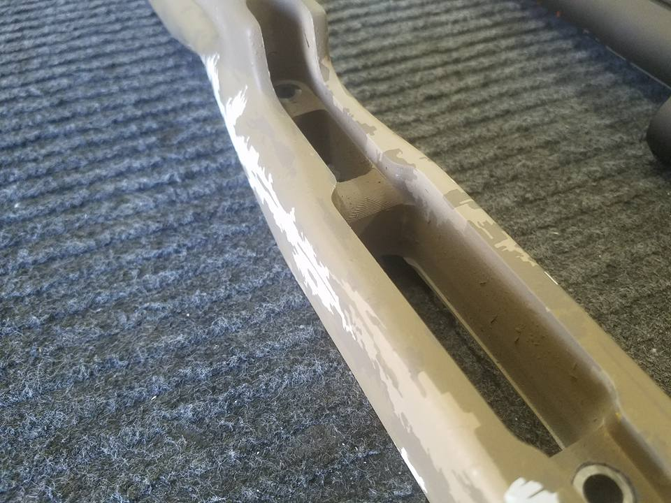

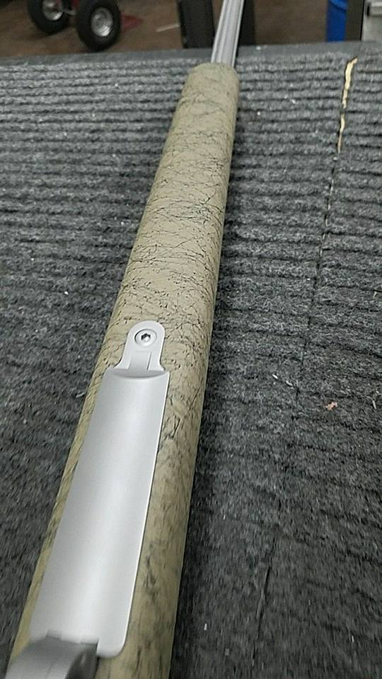

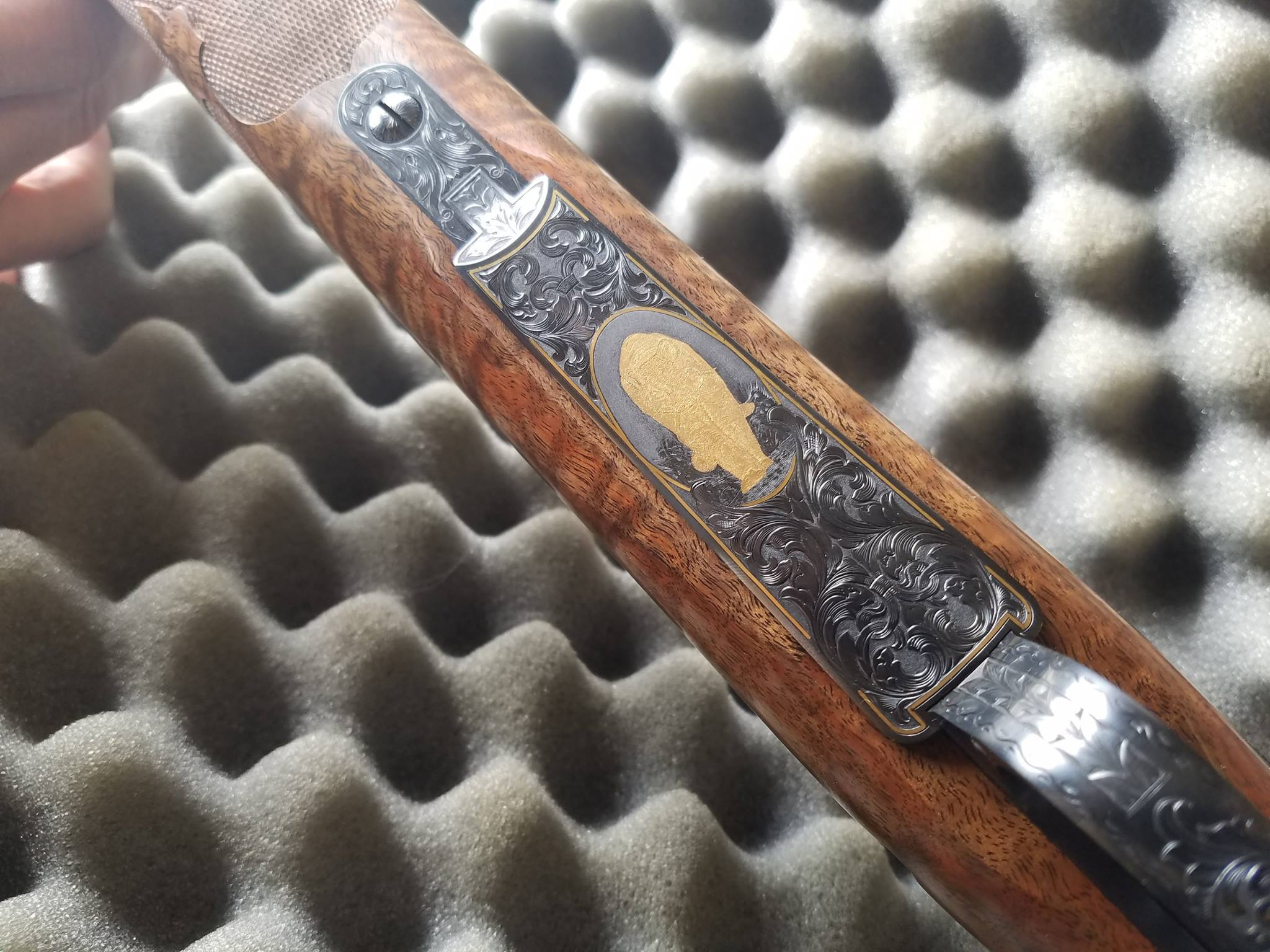

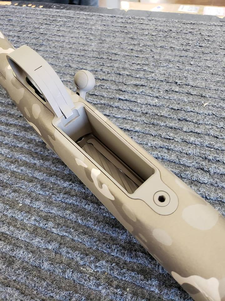

Examples of some of our floormetal inlet work. Does not make the gun shoot even a little bit better. I'd be the first to admit it.
It is little more than making an honest effort to deliver well fitted parts.
