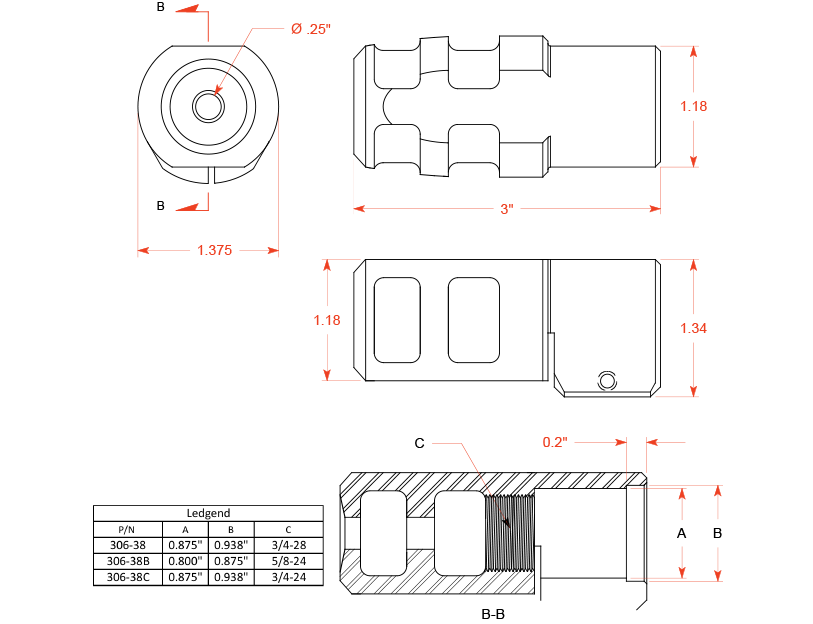

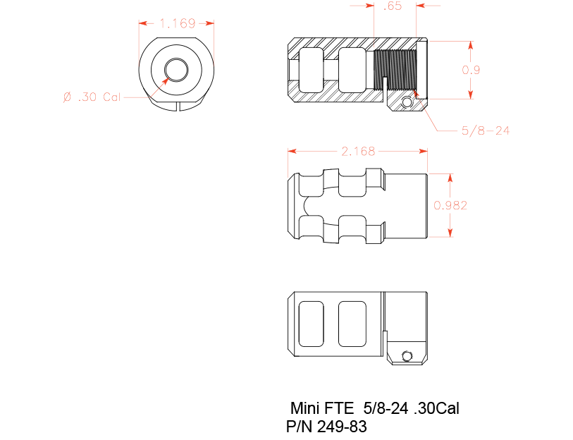

I have a question on this topic, I just purchased an FTE .800 Dia. 5/8-24 thread, (Part# 1005-306-38B)and once I received it, it does not clear my factory AI-AT 24" 6.5 barrel. It seems like the overall dia. of the AT barrel is to large for the brake. does anyone know if I just ordered the wrong FTE?
Thank you.
As seen in this diagram, barrel requires to be machined to .800 dia, this is where the clamp will tight on your barrel to ensure perfect fit / alignement. Note that FTE needs the hole to be bachined to your caliber too. It is .25 by default.
Mini FTE is easier to install without gunsmith work involved.
