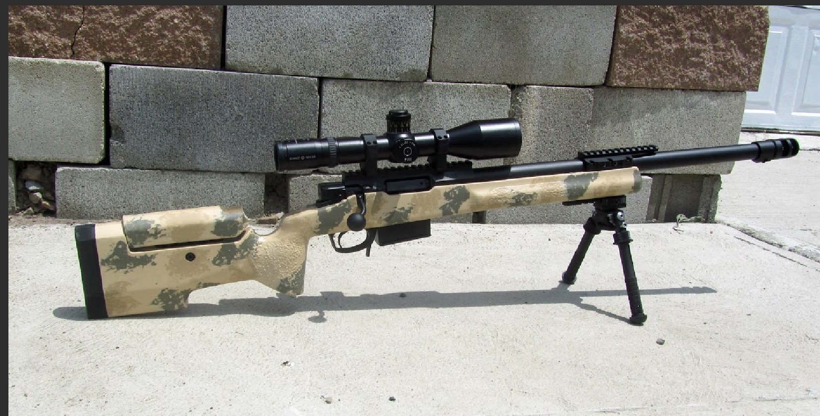

And look - they aren’t the most feature packed action - but I’ve had mine for a decade now and won’t ever get rid of it.
