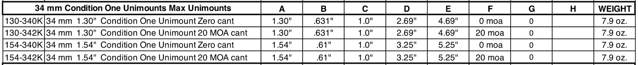

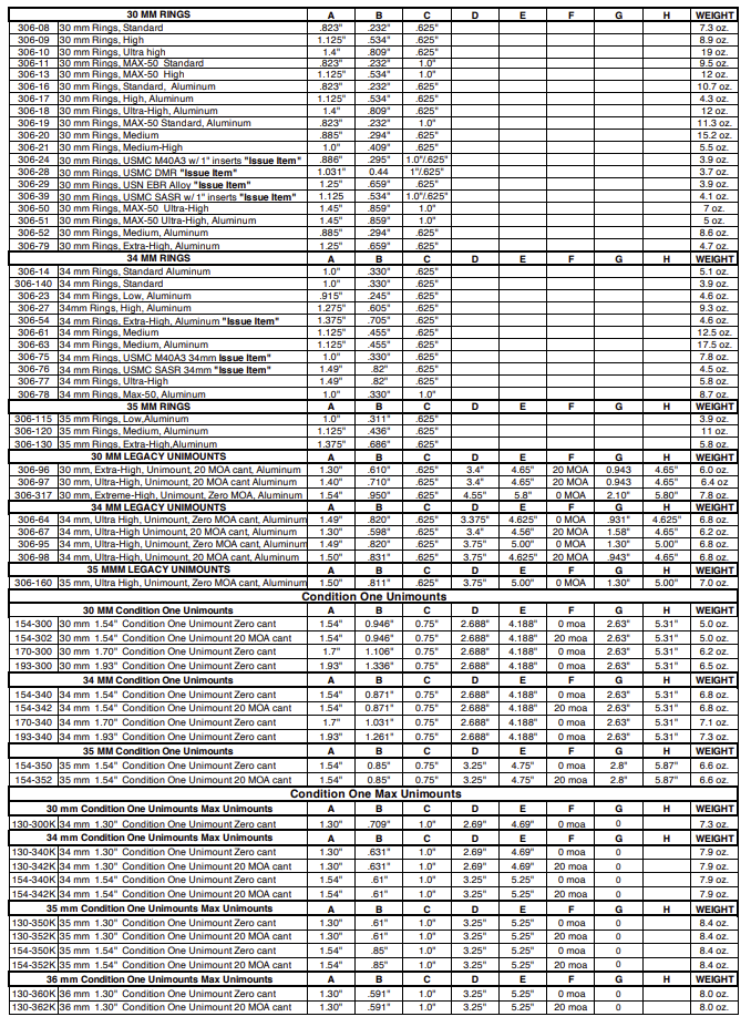

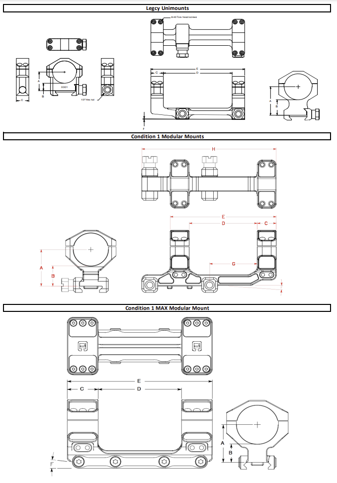

Not sure if that PDF loaded correctly from my phone, but it should be the cut sheet from Badger for all Max mount sizes/heights.
I can repost tomorrow from my computer, or you can ask BO, and they’ll send it to you.
Edit to add image of cut sheet:
  • 2022 mount sizes V4.1 1-27-22.pdf
Reactions: matt33 and Edsel
