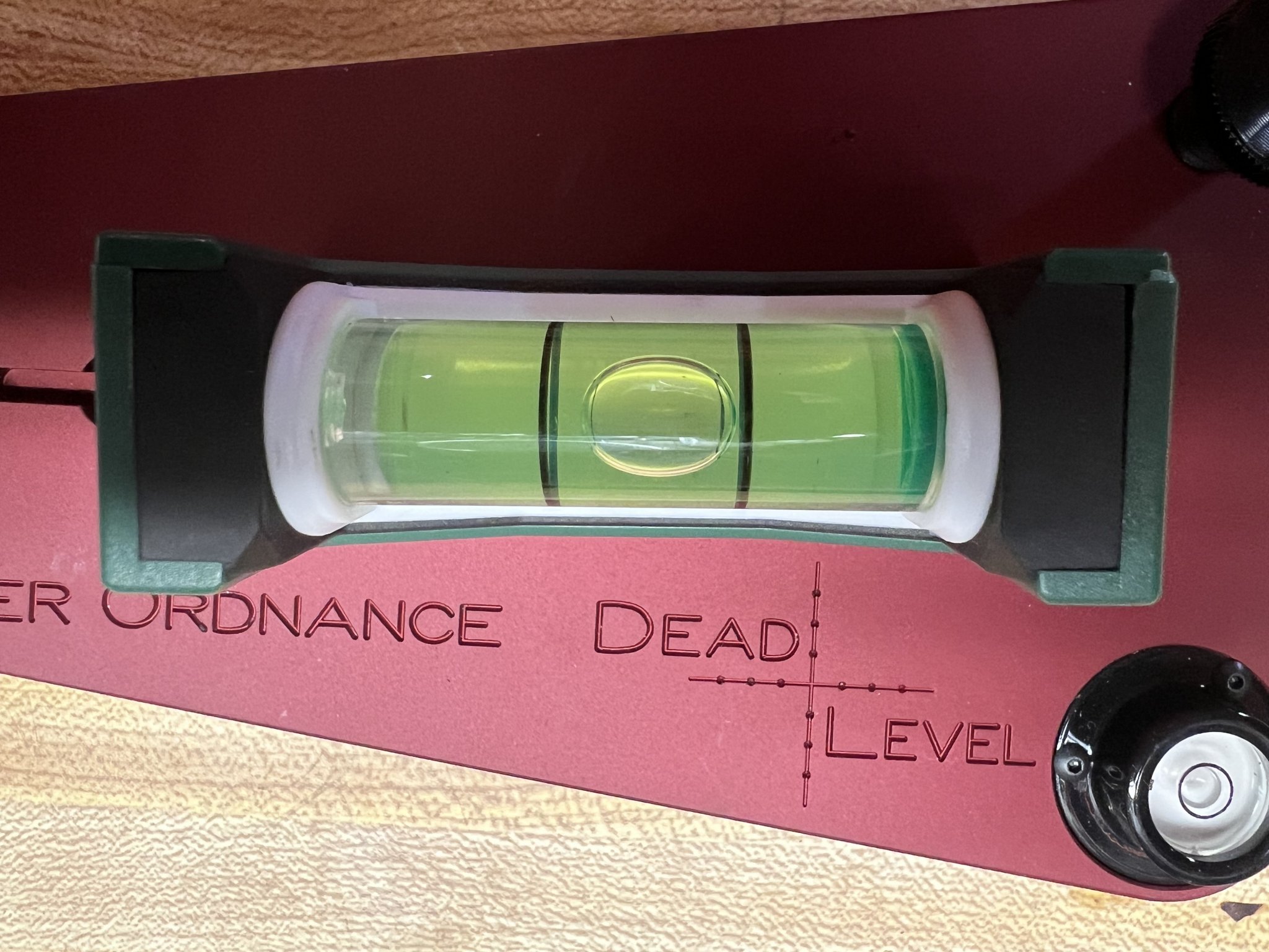

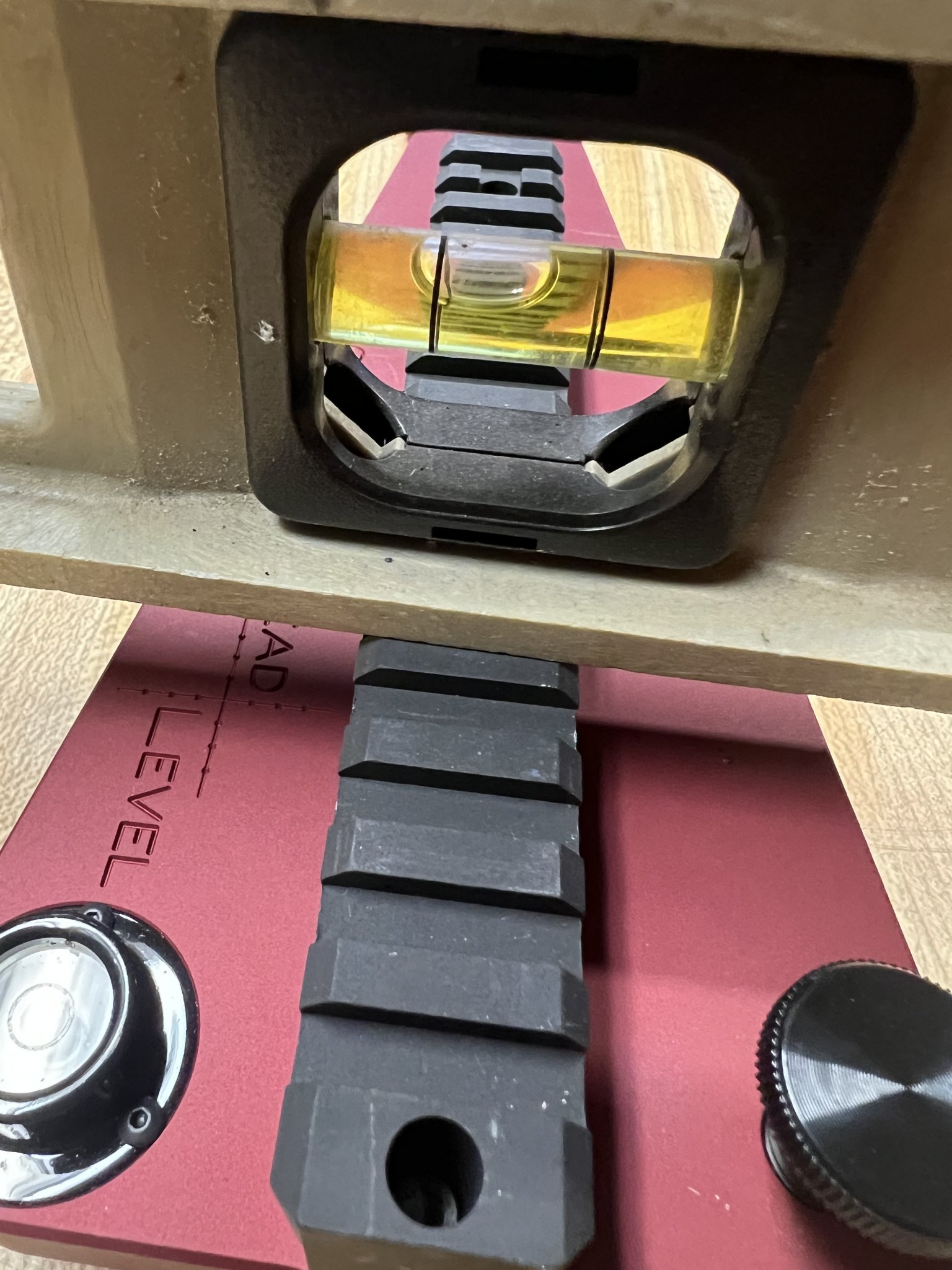

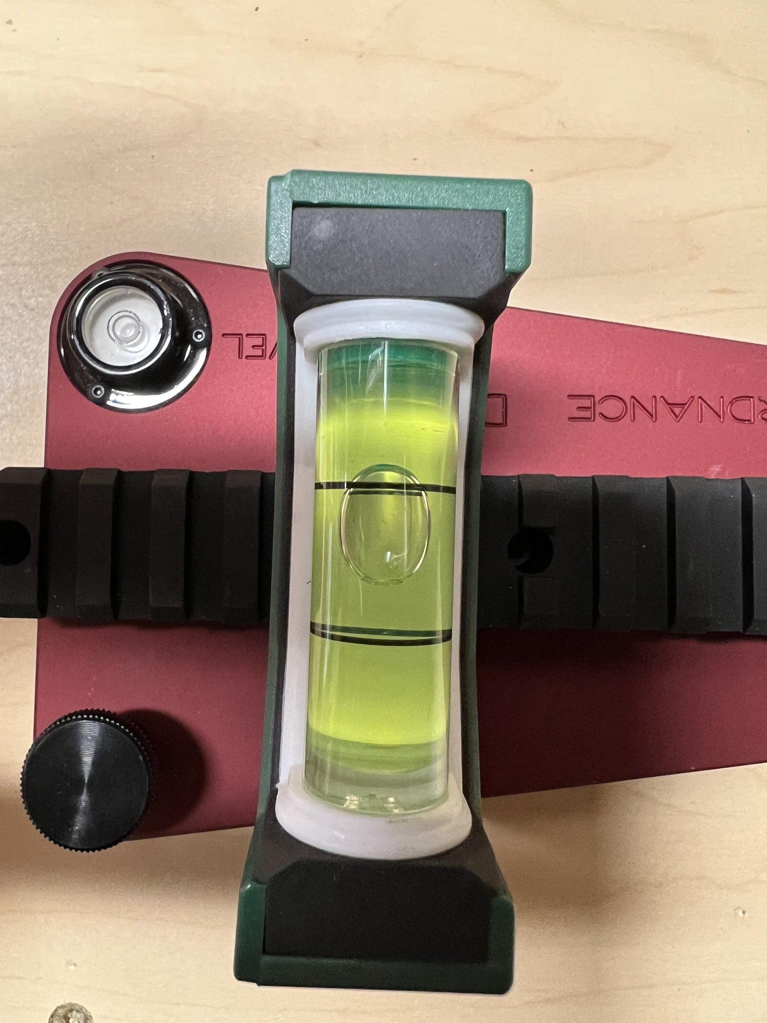

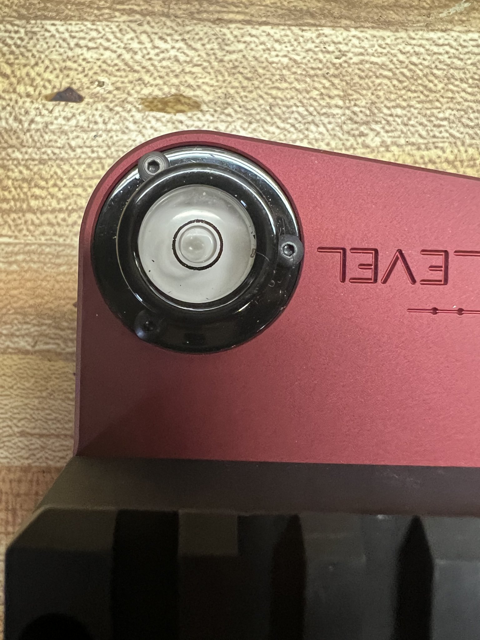

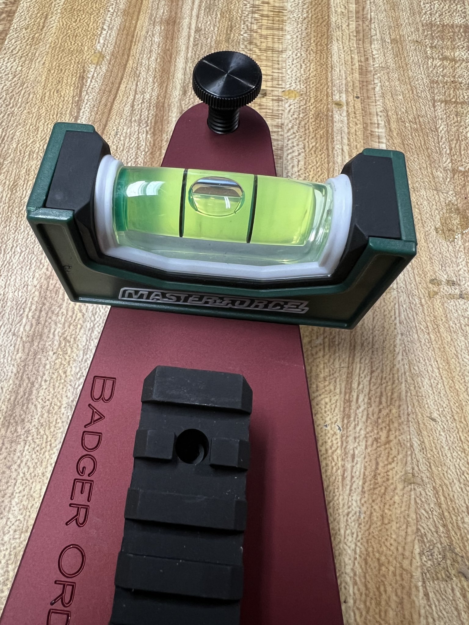

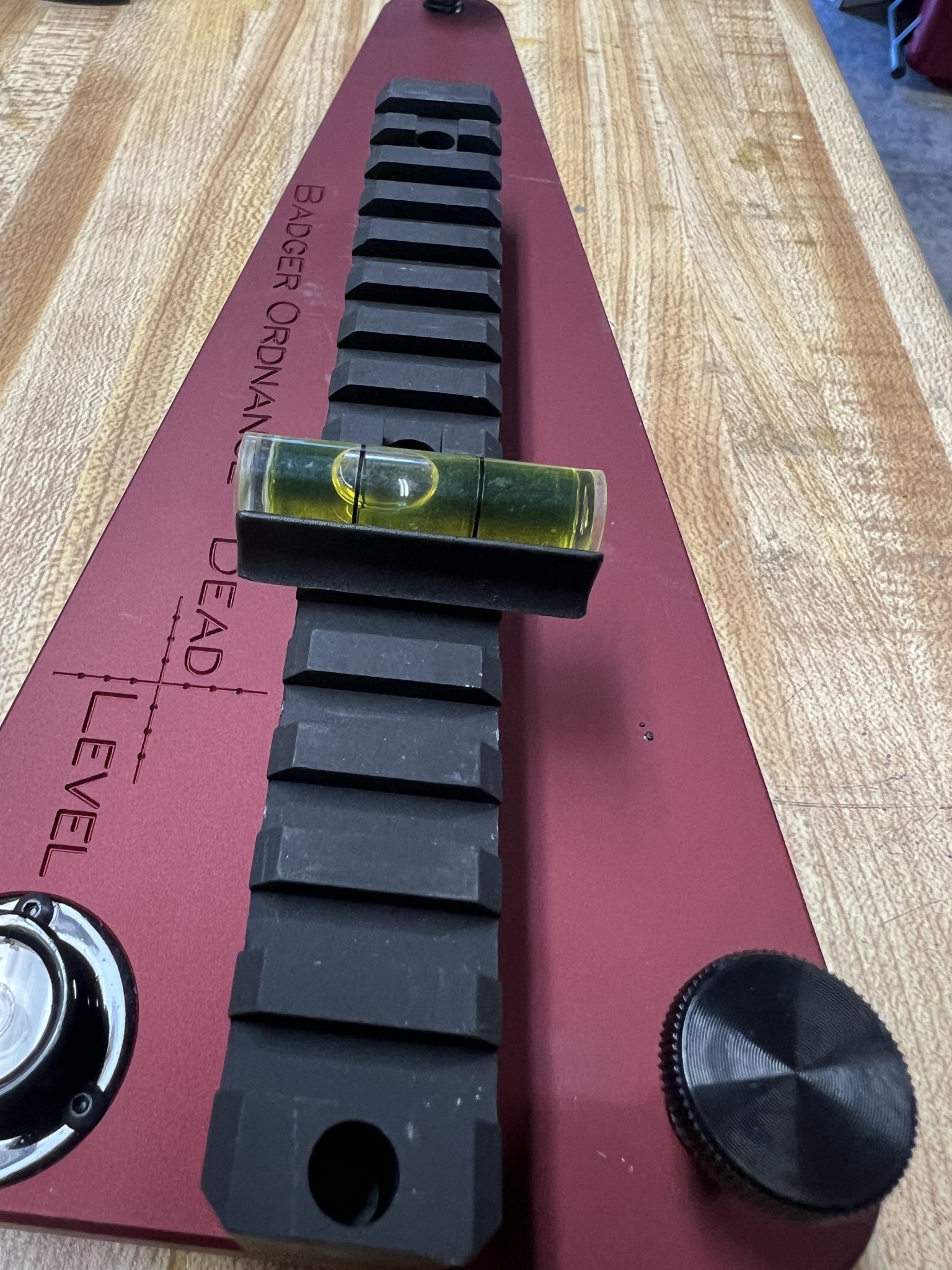

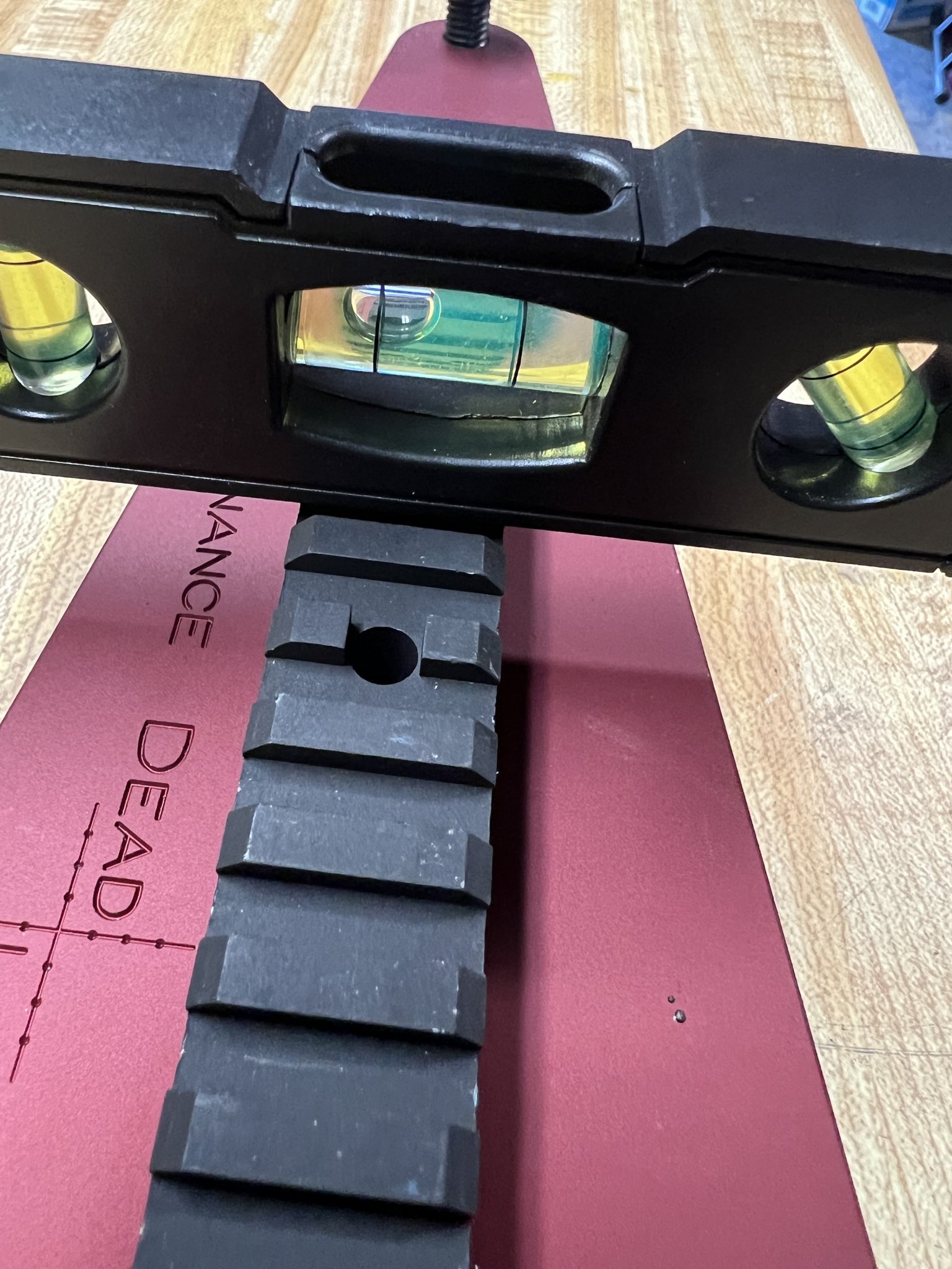

    I bought a Badger Ordnance dead level recently and was mounting a scope and for my curiosity I decided to check level with the level I had against the bubble level and found it was off. Does anyone else have this problem? Am I missing something? I assume the rail should be the same as the base.
    What really matters it’s to have the reticle, erector and centre of the barrel aligned with a plumb line. Then mount the bubble level with the bubble centred when the reticle its on the plumb line. No concerns
    Reactions: drcrk0525
    Cheap plastic levels are just that. @Lowlight once had a picture he posted of 4-5 cheap plastic levels next to each other and all were different.
    Get yourself a properly calibrated level from Starett tools if you want to check. I use a Spuhr or other wedge or feeler gauges to get the scope flat to the Badger rail and then check with a plumb afterwards. I have used my badger for 3 years now without fail.
    My Dead Level is the same way. I bought it like 10 years ago, and I haven’t used it in years because of that issue. Now I use the really nice metal (and magnetic) Fix-It-Sticks levels that go on my picatinny scope rail and scope cap, and are machined perfectly to ensure concentricity. Level the rifle on both axises first, then level the scope in the rings making sure the 2 levels match (even if they’re not perfectly plumb to the earth) while torquing my ARC rings, and my scopes come out more level than my Dead Level ever did… And the fix it sticks levels are only $55…. Sometimes I do them sitting on my reloading bench with a spare picatinny rail I have sitting around, before I put them on the rifle. 👍🏼

    Mine is the same way, which is one of the other reasons I stopped using it. They even sent me a new bubble, but the problem persisted. I think my pic rail was machined crooked, too.
    Man mine has been flawless for years. Love this thing. But look at the SAC tool. It’s rail section is much smaller
    I just tried it. It shows it level. In all fairness I have sent Badger a email and they advised they would check it out and fix it. I’ve just never sent it in.
