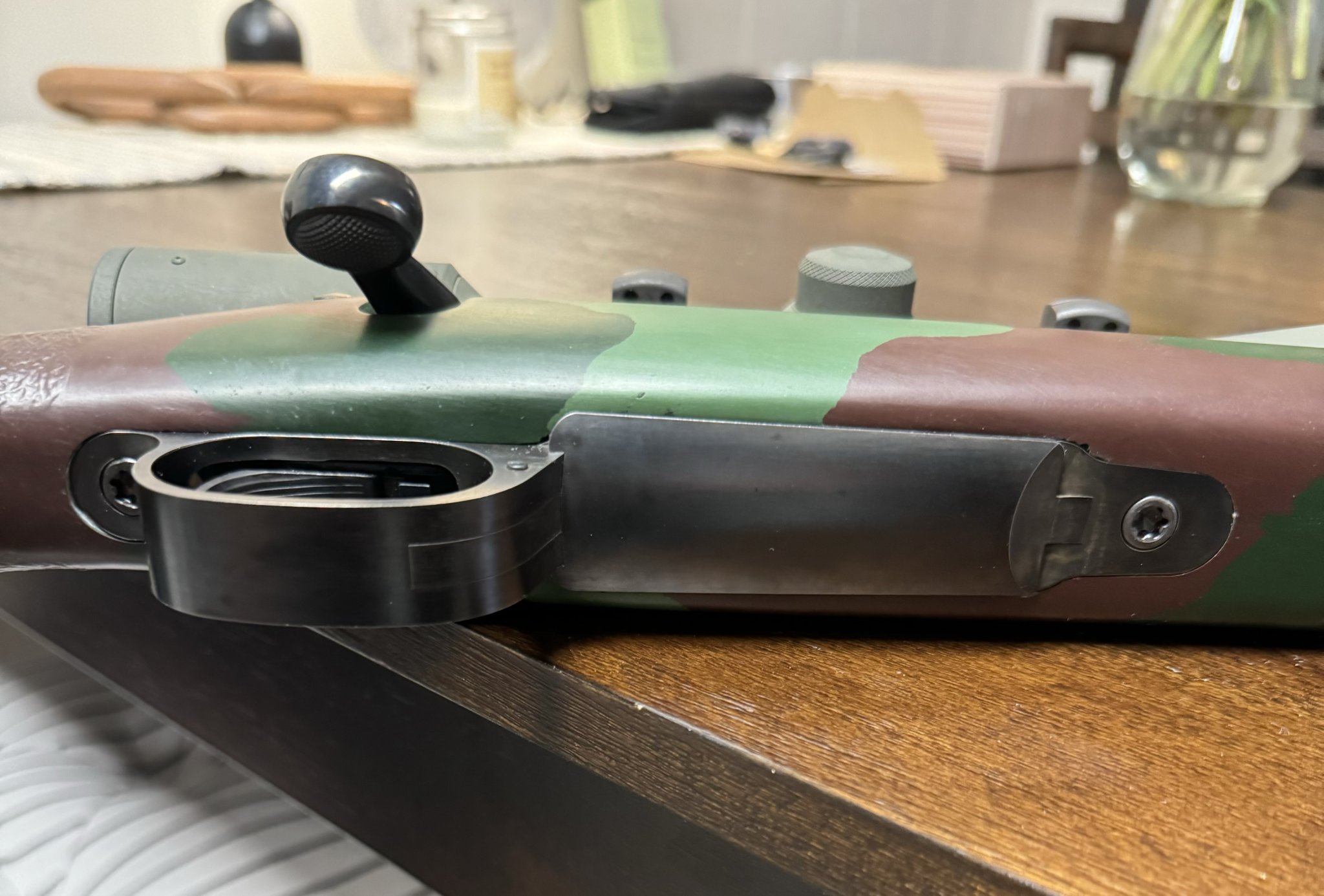

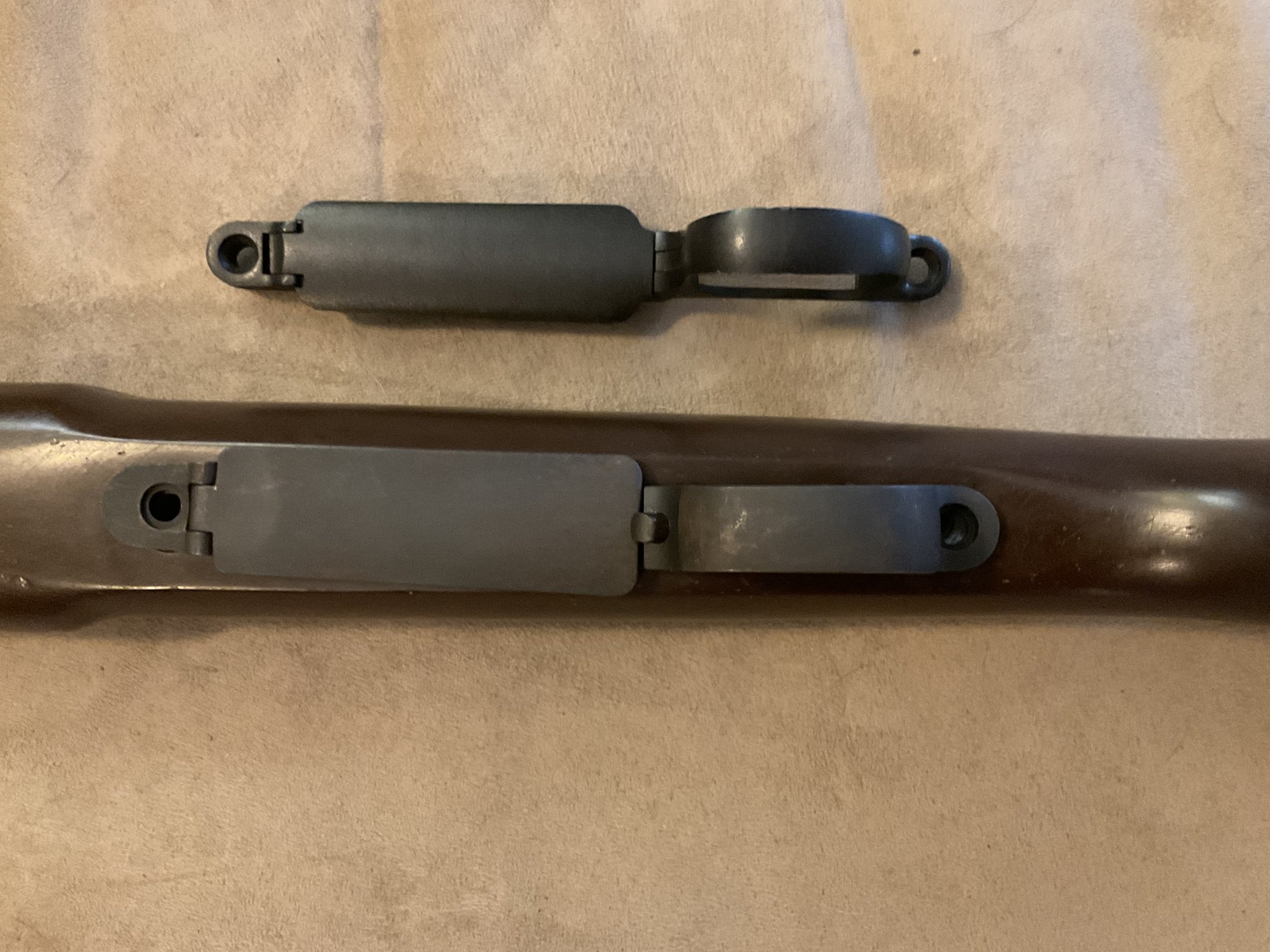

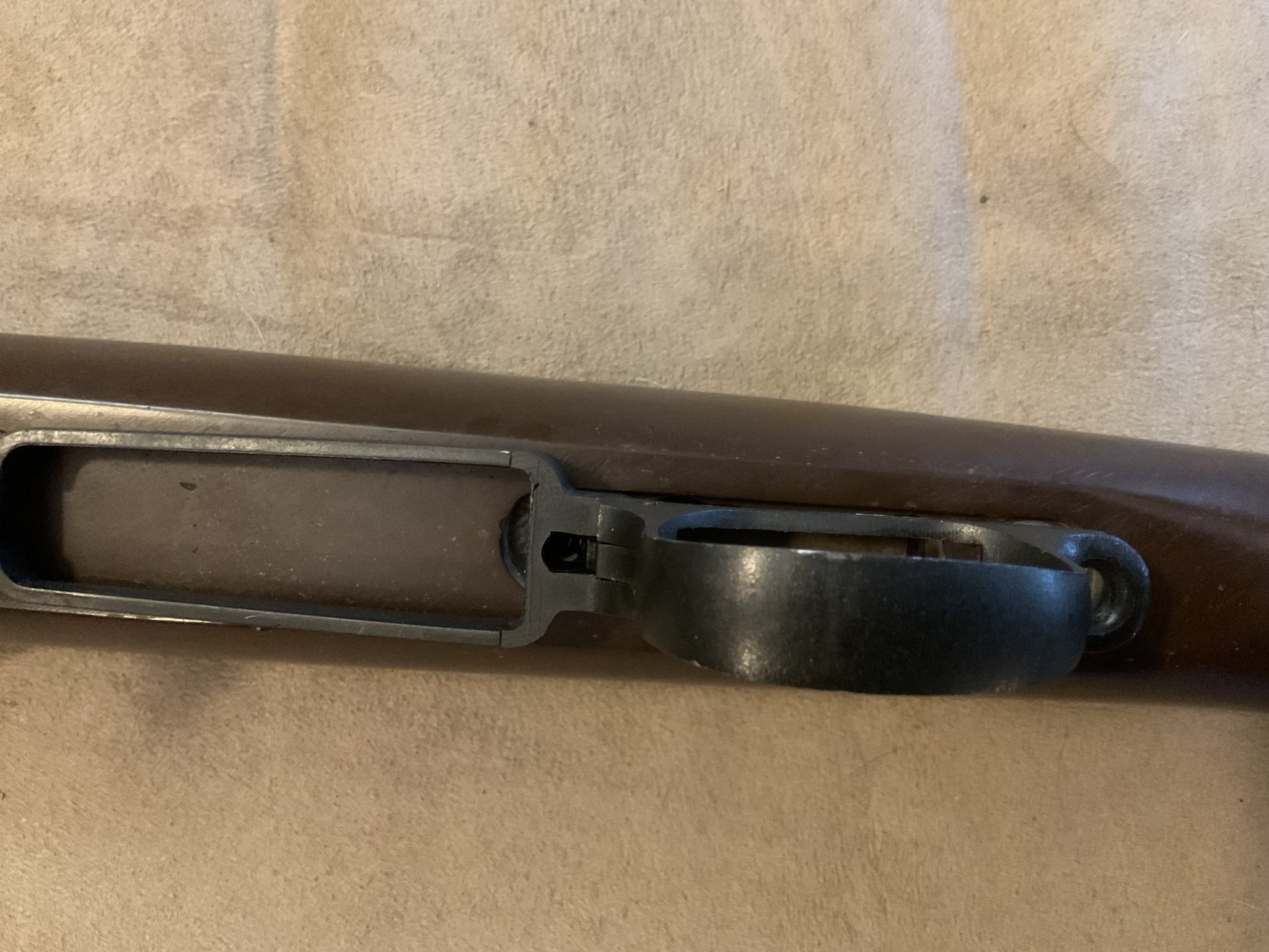

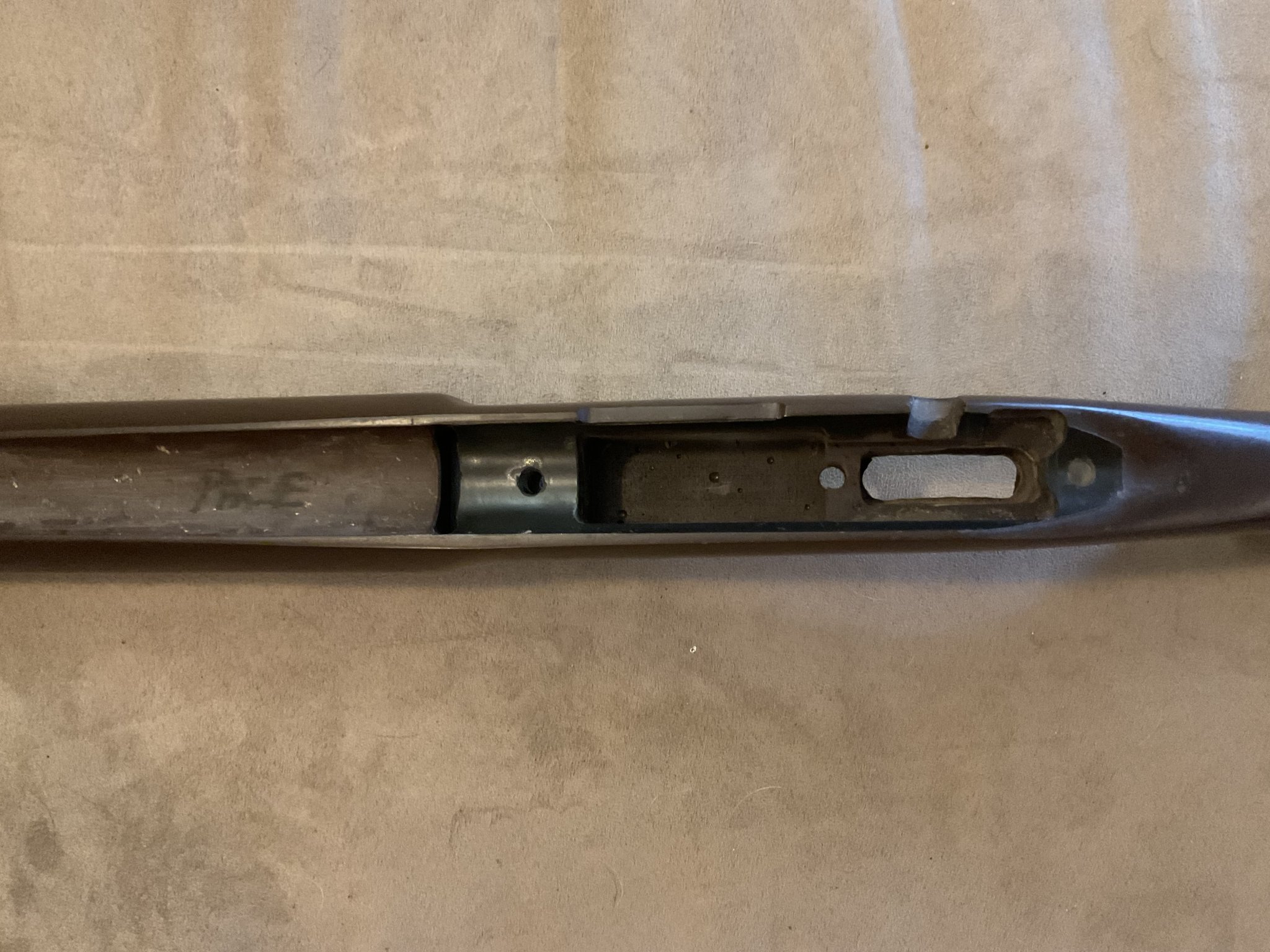

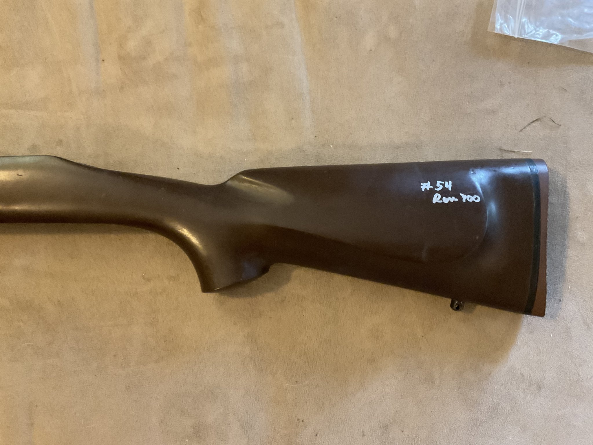

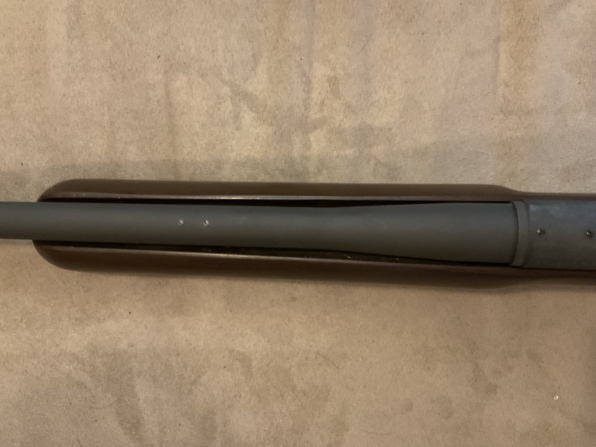

Pics of the stock and a couple mock up fits:
Is that enough meat to inlet the BDL floor plate?
Repro M40A1. I wouldn’t be using one of these.
.22 cal 40X slated for a rimfire M40 build.
Previous bedding. Stock came from seller in CO. Does the name “Pace”ring any bells?
Just any early? bench rest stock, I guess.

That’s definitely an old McMillan stock, lol. Probably a discontinued line, especially since it looks like it has a solid color molded-in finish. If you check out McMillan’s flat-top only stocks page, you’ll see many of their older lines that look very similar to yours: https://mcmillanusa.com/flattoponlystocks/
As for bottom metal, per the above posts, either should work for you. You can also just get it opened up to the BDL footprint, and use either factory aluminum BDL bottom metal or a myriad of aftermarket steel bottom metals that fit the BDL footprint too, which would also look more in-line with the age of the stock.
But you definitely have options. Nice stock.
