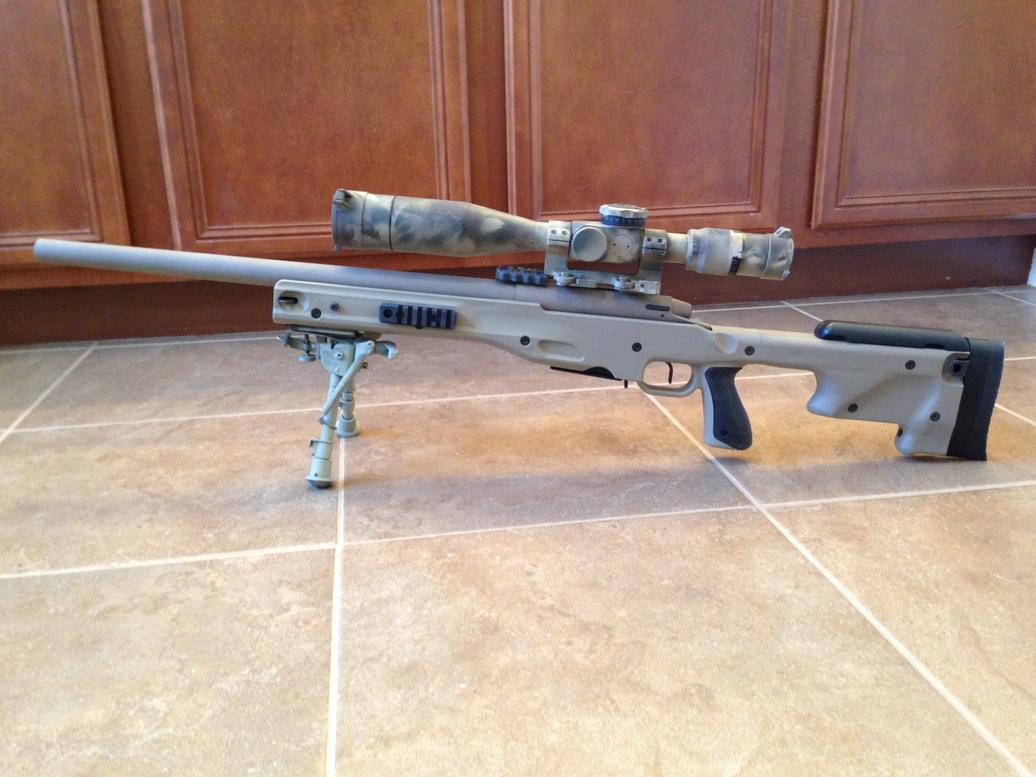

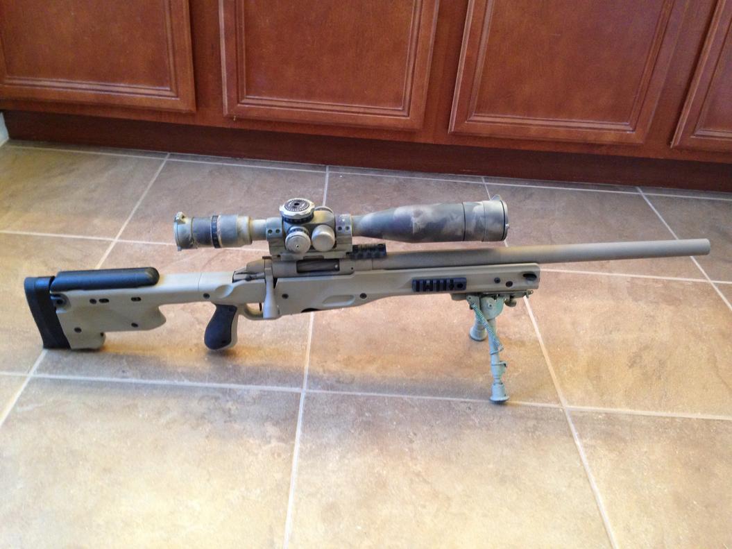

Does he plan to use any NV in front of it at any point? If so, he will need at least a 1.5" base. Here is my AICS 1.5 with a Larue LT111 mount that is 1.535" tall. I've only had to raise the cheek piece up slightly so that when behind the weapon I can rest in a relaxed position and my eye is in line with the scope. I know this differs from man to man but this is what works for me and what it looks like. Hope it helps.
