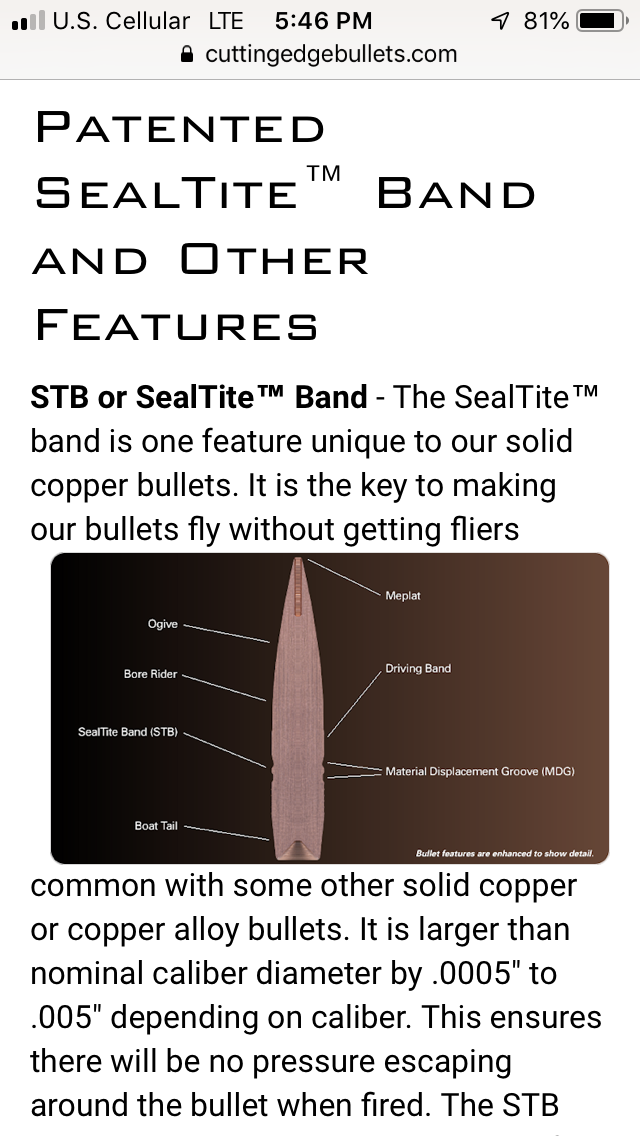

    I’m just getting started with my 375 Snipetac. Forming brass now and going to try cutting edge 377s and badlands 350s. I have a couple friends that shoot the badlands but haven’t really heard of many others. Who on here shoots their bullets and how’s your results been? The cutting edge is leaving a crazy amount of fouling and I’m pretty sure it’s from that sealing band. Flatline and badlands don’t have that so I’m thinking,(hoping) they’ll not foul as bad.
    The "sealing band" as you call it is the drive band and is the only part of the bullet that is full bore. Usually drive band bullets in larger calibers are faster at max safe pressures and have less fowling then bullets without them. Some barrels seem to like brass over copper bullets or visa versa. I'd play with that first. Everyone uses pretty much the same alloys for bullets unless there is someone crazy enough to still use beryllium copper lol
    -Alex
    I wasnt entirely sure I was correct but just checked. The sealing band is larger than the caliber.
    Yeah, the drive band is usually slightly overbore. I't isn't much metal to swage and seems to help a bit with centering. If you look at bore rider designs they usually have the borolette slightly wider than the tops of the lands for the same reason. In the 50s at least a lot of us slug the bore and then try to get bore riders that are 5/10000" wider at the borolette and drive band. More variation in land to groove for us that the little guns though.
    If your barrel is fowling badly with both brass Lehigh and the copper cutting edge bullets then you then you may have the misfortune to simply have a rough bore. Any chance that you can run a borescope down it?
    -Alex
    I've never seen a barrel that fowls less over time but good luck with that.
    The only thing I've seen occasionally work in barrels that fowl badly is annealed brass bullets. They need to be inert gas annealed and I'm not aware of anyone that currently does that by default. It was something that Lynn McMurdo was doing for a bit. The only caveat is that it needs to be done on bullets with slightly longer drive bands to keep them from shearing. He said that with the softer brass the engraving pressures dropped enough that the max safe velocity stayed the same so the only substantive change was the fowling reduction. It has been a while but I want to say he went from a 100/1000" drive band to a 120/1000" in a 50. No clue how soft he was going though.
    If you have a bunch of brass projectiles that you done care for, sending them off for heat treating isn't going to be expensive and might be an interesting experiment.
