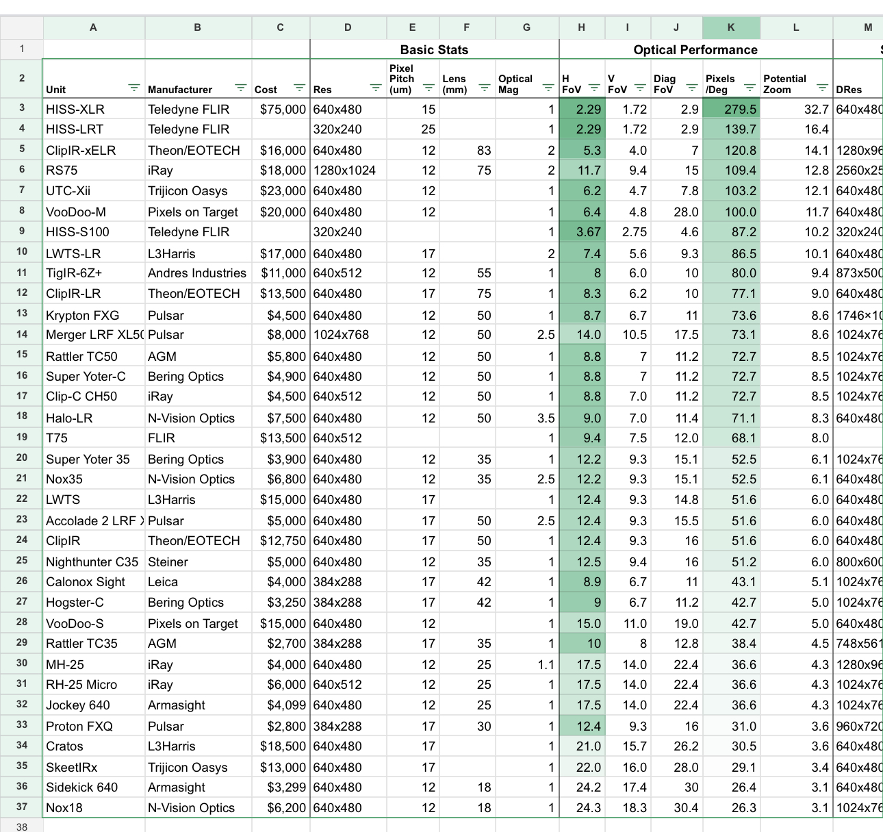

Thanks so much for that chart!!Not my spreadsheet(and "Cost" is MSRP). I've saved this for myself, but wish I could credit the member that originally made it.

I’d lean xii / voodoo mSo if I’m understanding this correctly, if the majority of my targets are 500yds and closer, I may be better suited to get the ClipIR LR to get more FOV and just suffer a little on targets past 500yds and over 12x on a day scope?

I would be realistic about your actual ranges. 500 yards at night with thermal is a LONG way. It would be best if you can actually look through some of this stuff before throwing down the big cheddar. Despite your desire to buy a big $$$ clip on many people are just as well served by something like a HALO XRF in terms of integrated package and imaging quality.So if I’m understanding this correctly, if the majority of my targets are 500yds and closer, I may be better suited to get the ClipIR LR to get more FOV and just suffer a little on targets past 500yds and over 12x on a day scope?
Don’t be! I’m really glad it got sidetracked because I think I finally understand that I don’t know what I don’t know, especially from the pixels per FOV degree.Sorry @shark3-1 I feel like we're hijacking your thread.
