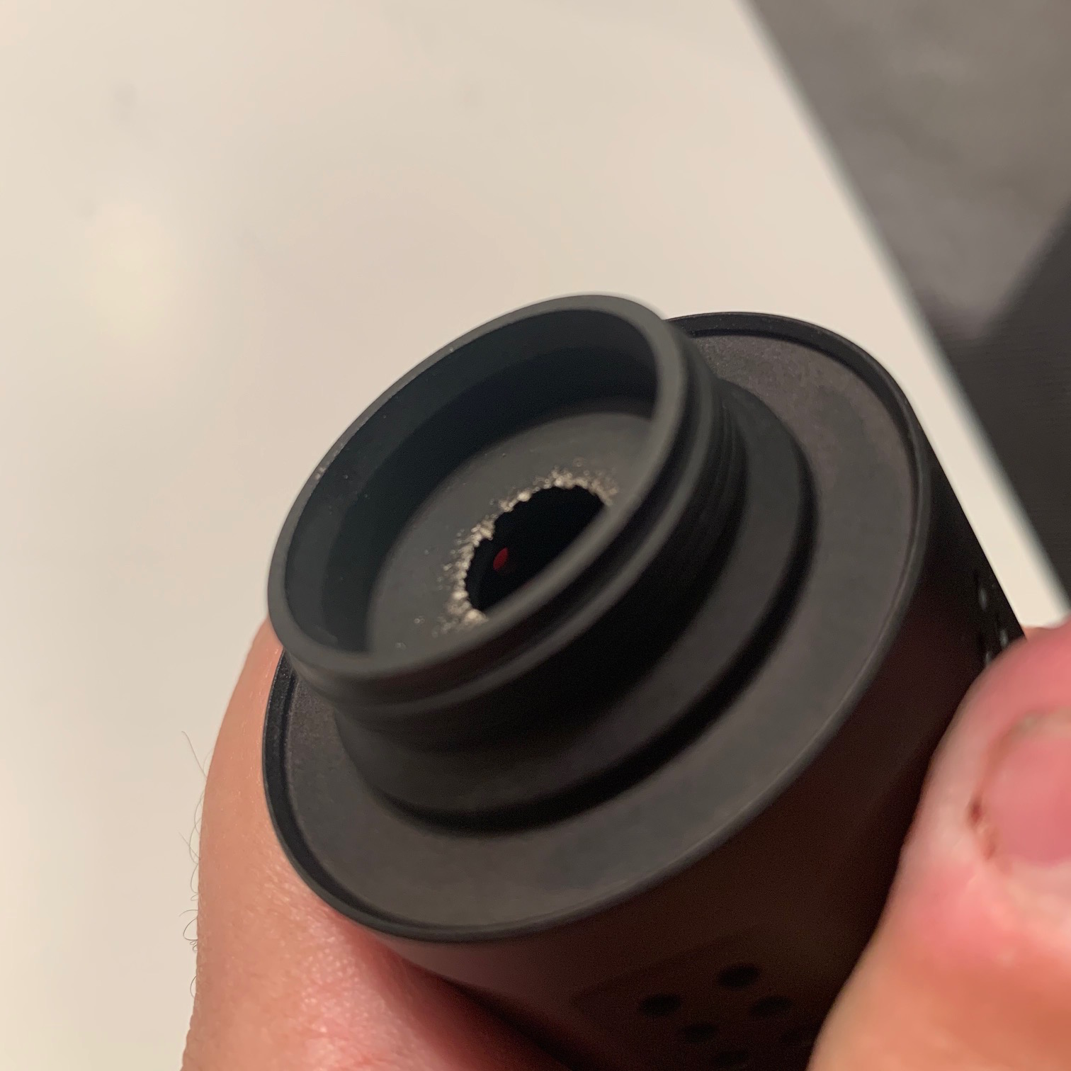

maybe baffle strike is the wrong term.
Nothing was hitting in the can from what I can tell. The hole in the e brake had chips around the edges like the bullet was coming in contact.
Pic attached

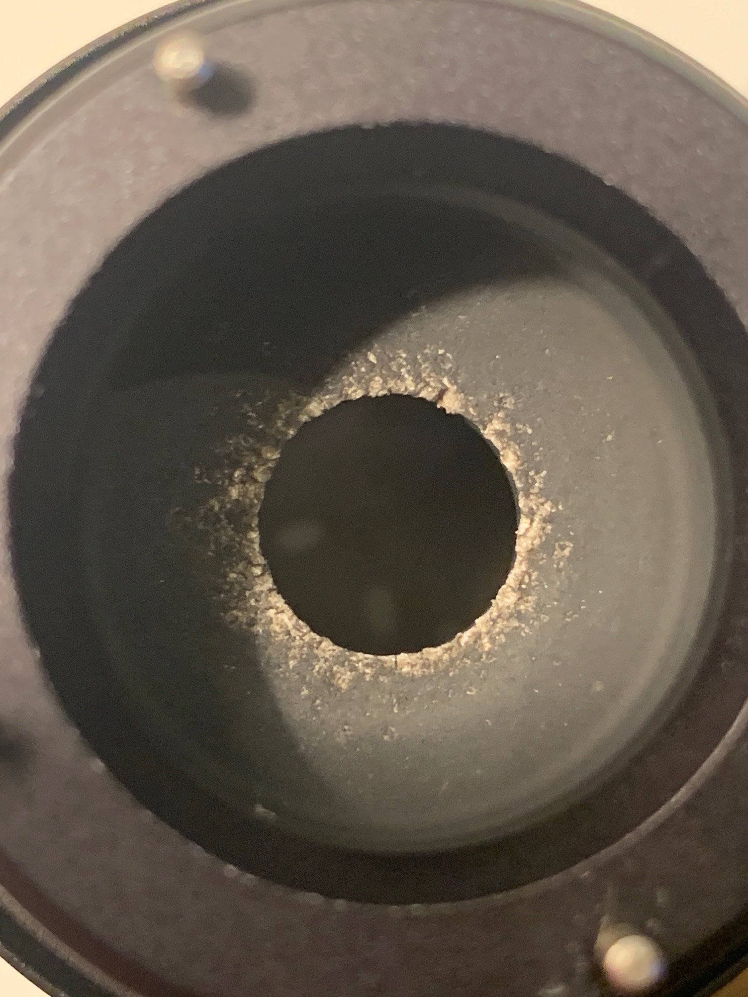

Then what are the chips in the material caused from? Any reason it shot well after I removed it?
Looks like copper to me. Could just be the bullet shedding little pieces of jacket as it leaves the bore. If the bullet was hitting it would be a smear on one side with a deformation of some kind. There is no way the bullet can touch that end cap with zero damage to it.
As for the good group after you took it off I’d say dumb luck. One 3 round group is statistically irrelevant. Now if you shot 5 in a row the same way, put it back on and shot 5 in row much bigger then there might be some type of issue somewhere
Did you measure the can's bore diameter? Those marks look like impacts..... by something. Are they uniform around the diameter?
Pic straight on looking down the ebrake if you can. It doesn't look like a strike to me from that angle.
Are you sure the brake you mounted on the barrel was a 308 bore? It will be now ?

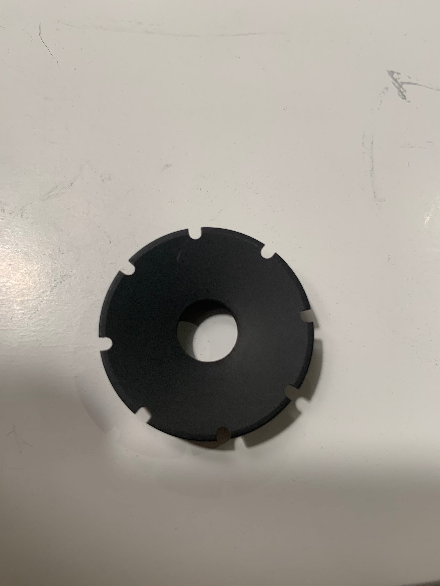

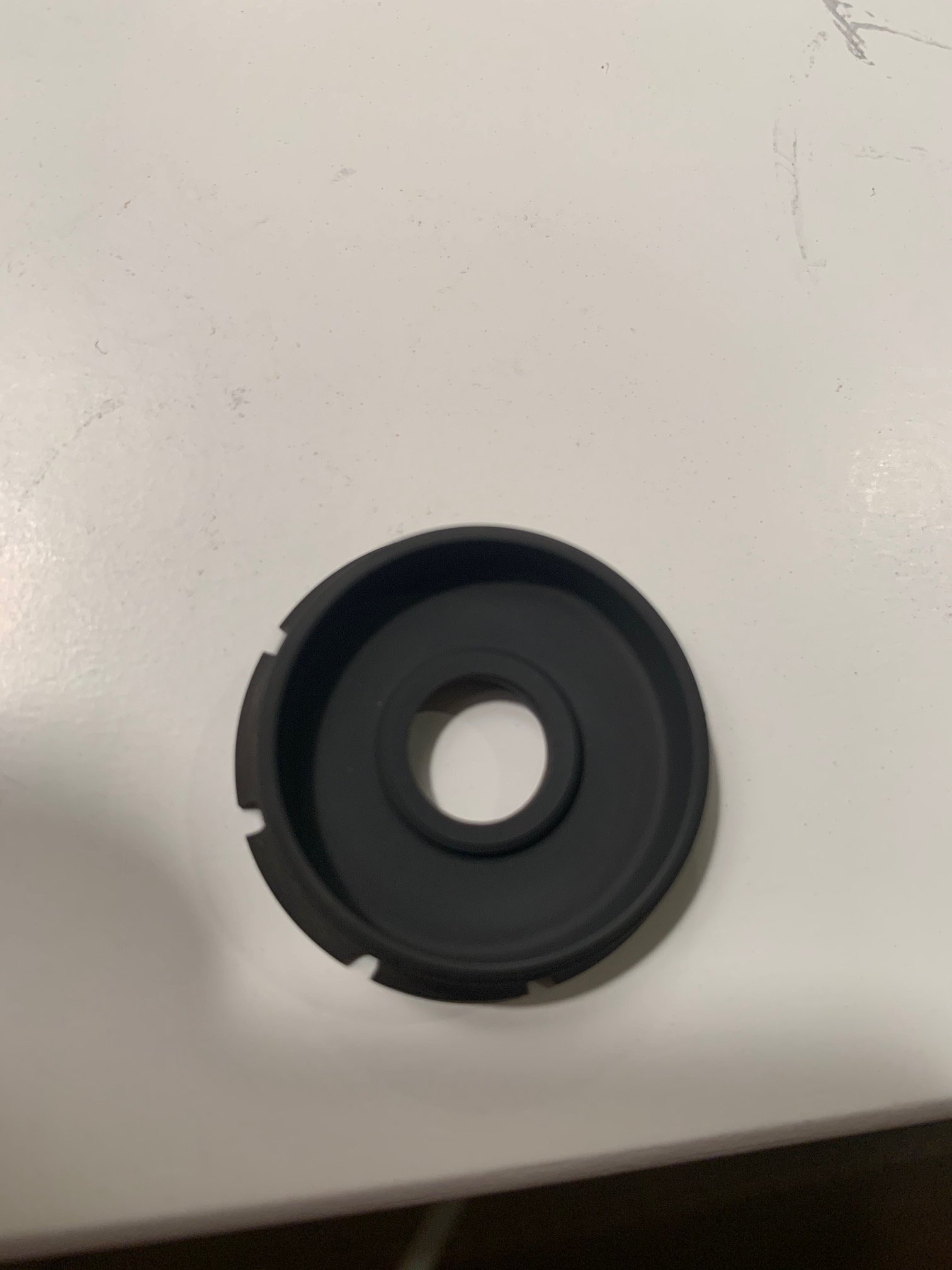

Here is the end cap itself, fired from the end of the ebrake as well as directly to the suppressor itself. Perfectly intact

I was all for the bullet losing it's jacket but the rest of the suppressor doesn't have a single nick or mark in it. I find it hard to believe the shrapnel makes it through the entire suppressor then just nicks the ebrake.

Could be the jacket isn’t hurting the rest of the can because it’s 17-4 which is much tougher than what the ebrake is made of. I’m still in the shedding jackets theory

Will not happen dead air will replace it but the pic straight on is not a strike.
Op pull your brake off the muzzle and look at it straight on and let's see if we see the same/similar pattern
