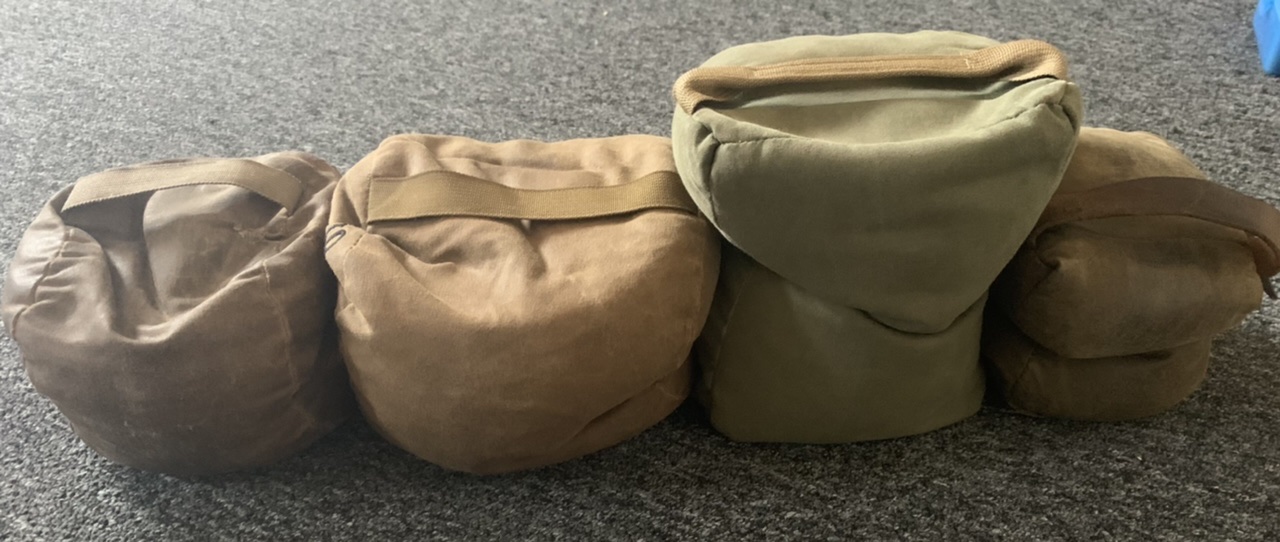

Here is a mini fortune cookie, a tater tot, a full size game changer, a pint game changer.
The full is notably taller when stood on end.
Using these as a front bag on a table is going to leave you very little room to fit a bag under most butt stocks. That’s why they are usually used a rear bags on a flat surface.
