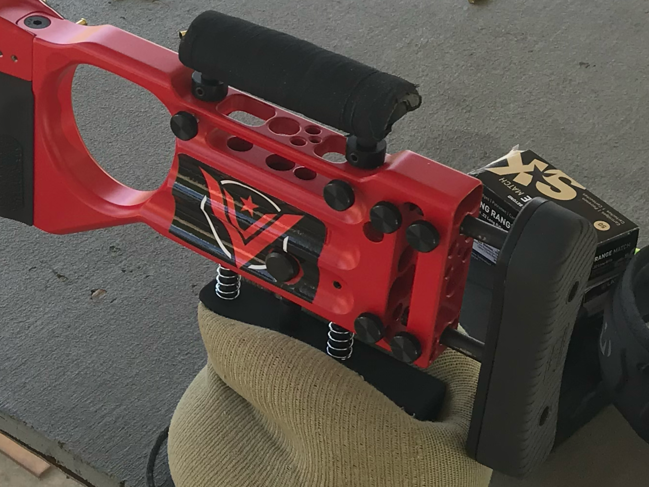

use case: NRL22 (50-100yds)
scenario: with 26" barrel rifle balanced at front of mag well (pre-barricade stop). Gray Ops barricade stop made rig butt heavy; added competition side rails and 4 x Gray Ops XL steel weights to regain balance. would like to try 18-20" barrel but concerned with balance, welcome input/advice from folks running similar barrels.
build: RimX / MPA Matrix / Competition Side Rails ( 1.1 lbs) / 4 X Gray Ops XL side rail weights (2.8lbs / Gray Ops barricade stop / 26" ACE barrel ACE contour (1.250 -> 1.10 @ muzzle)) / NF ATACR 7x35
