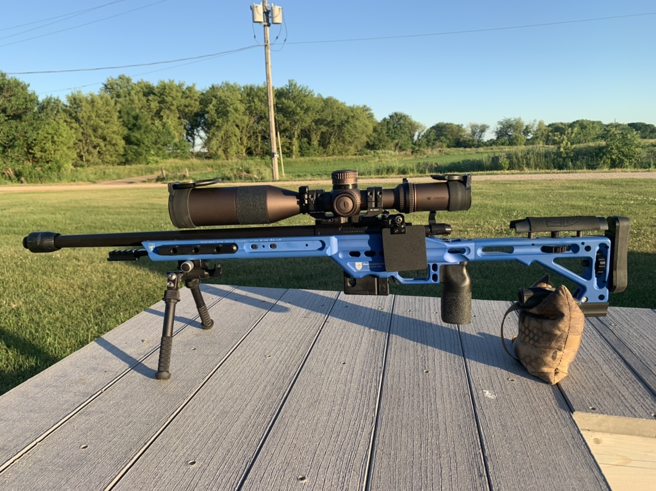

Vudoo gen2, 22” MTU, side rails, front Gray Ops weight, no internal weights. Balances a couple inches in front of the magazine.

I have never tried the Railchanger X so not sure. My experience with the side rails (pushed fully up when tightened) has been lever clamps (like RRS) mostly seem to work, longer shaft Arca knobs (like MPA RAT, Wiser Precision) work, short Arca knobs (like RRS pro) do not. Please note I have not tried every possible combination though. There was a small up-charge to match the color of the side rails but I felt it was well worth it. Gives it a more finished look in my opinion.

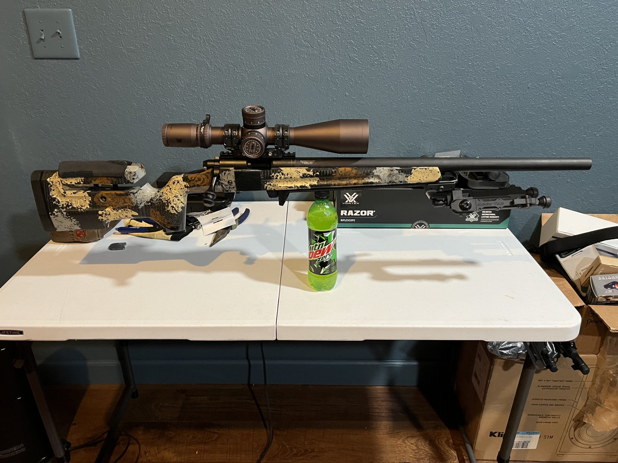

Just switched to a Manners PRS1 with a 24” barrel tapered from 1.25 to about .98” and have home made lead cast into an Area 419 weighted arca. She balances like an Olympic gymnast.
