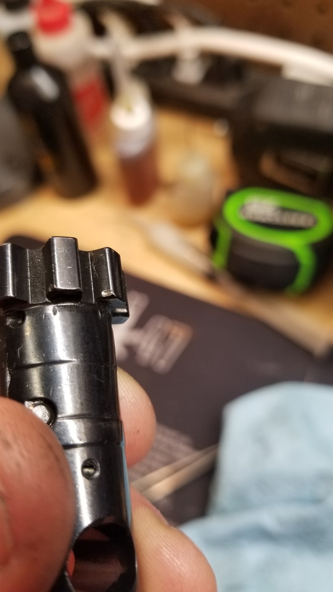

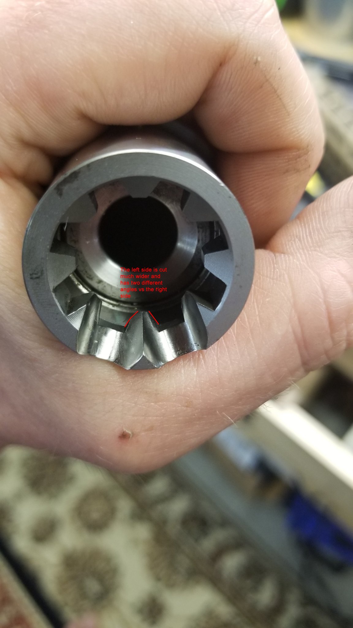

Well I just bought one, 6.5CM 22" Rifle Length Premium Series, shot like crap, was not MOA. I started inspecting it after I finished the 2nd ladder test, at 82 Rnds, found the barrel lugs weren't cut correctly, it tooks chunks out of my new bolt. Got the bolt replaced by Toolcraft, they were awesome BTW, totally recommend Toolcraft. I sent these pictures to BA, they RMA the barrel and sent a replacement, waiting for it to arriving today. I'll have more feedback this weekend if the barrel shoots or not, hoping the 1st barrel was horribly inconsistent due the bolt issue.

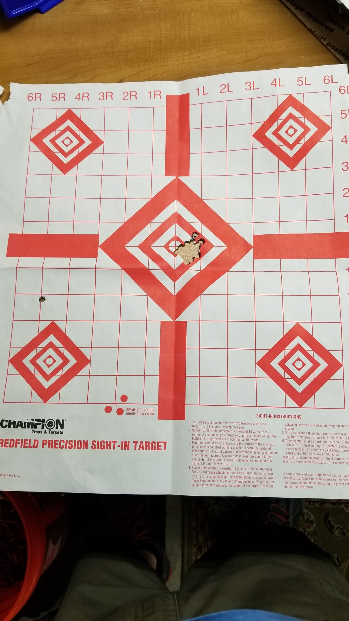

Here is my replacement barrel with properly cut barrel lugs, this is was a random starting load for barrel break in, I wasn't taking time to get great shot placement in between barrel cleaning.
6.5CM 22" Rifle Length Premium Series 18rd at 100 yards, the flyer was my 1st shot, I then adjusted the reticle.
This looks promising for the ladder test.
