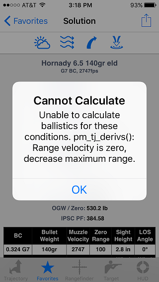

I have reinstall app, delete all profiles etc. And imho I found a bug. The problem is with a range over 900m (1000y). When I use maximum range to 900m it works over not. If u can test it, lets do it. Pressure in hPa is input wrong on current atmosphere section.
Is this the error message you're getting? There does appear to be something weird going on with hPa and distances past 1000. Every time I open a profile from favorites and enter current weather conditions and click on solution, I will get that error message and my hPa number will have a decimal point and a bunch of numbers after it, the same occurs for the Celsius temperature field. These errors might only be on my end because my profiles were formatted with imperial data.
It does appear to be a bug. Here is how to get around it. Click on the rifle profile you want to use, then click on the icon in the upper right corner(box with arrow), when the menu comes up click load, scroll to the bottom of the page and click on calculate trajectory, your drop chart will load and then you can go into your weather and input the current conditions without the error message popping up.
To summarize, just make sure you "load" the profile and the problem should be eliminated.

I took the time to build two new profiles after changing all my data to metric, I set my max distance to 1300 meters and I couldn't generate any error messages. This leads me to believe that there isn't any bug that I can find if the profiles are built and used under one standard. Weird things may happen if the app has to do a conversion, based on my earlier post.
