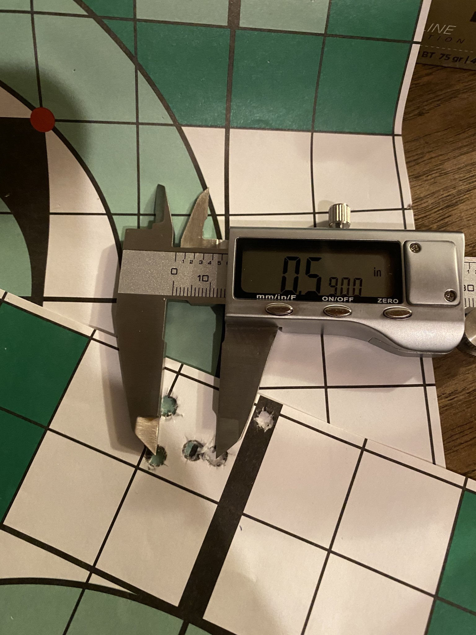

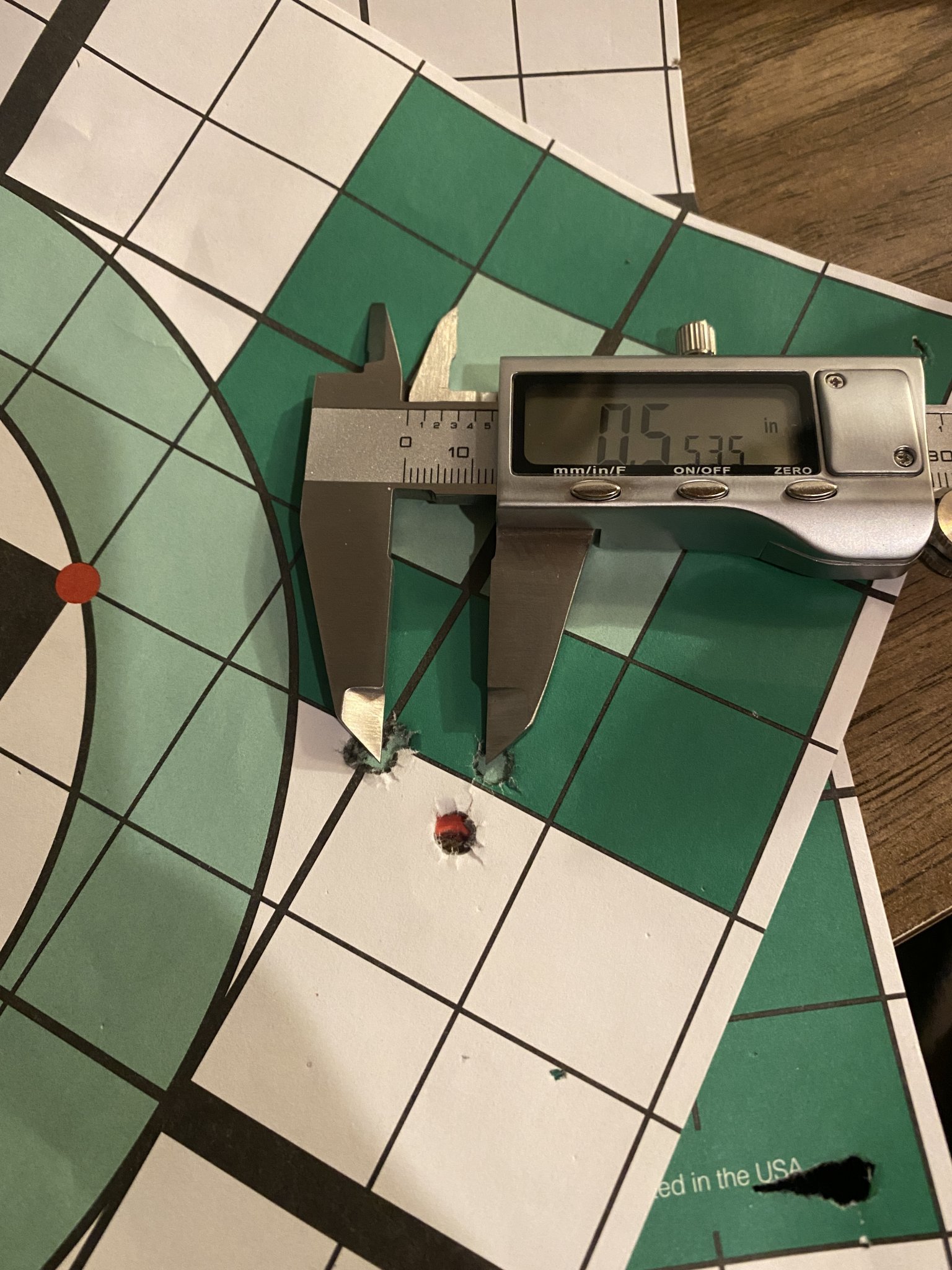

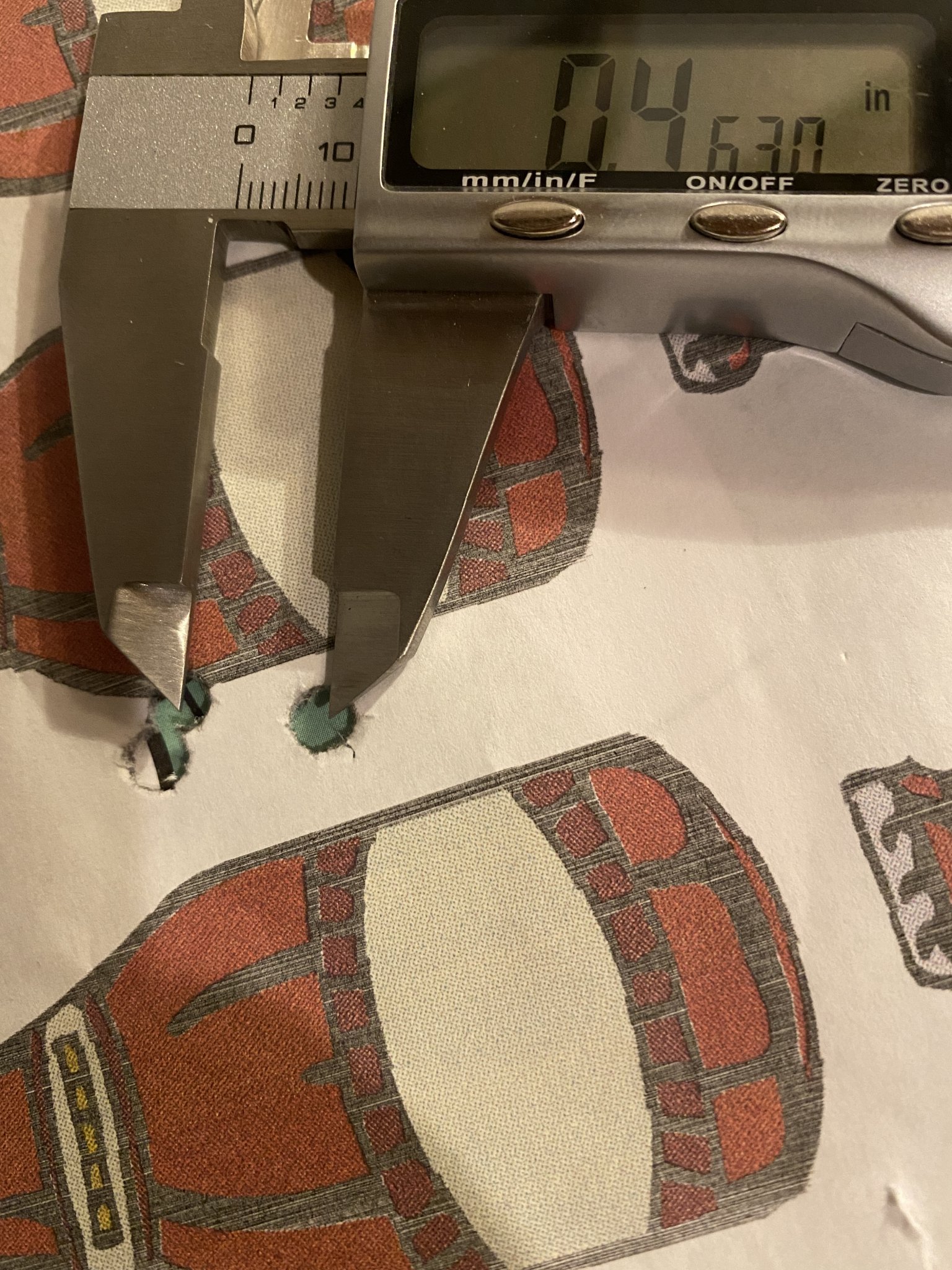

    Installed this barrel yesterday and am happy to report it is showing some serious accuracy.
    Threads were a little coarse/rough but otherwise the fit and finish looks great.
    All 5 shot groups- will post pics later
    .54 with Factory Hornady 55gr v max
    .8 with Winchester 68gr match
    1 inch with PPU 75gr match
    .5 with PMC m193 (3 shot group to zero)
    Anyone have experience with this barrel? Pretty good so far for a 200$ tube .

    I’ve heard they like 62 grain . Plan to take some
    Federal fusion and m855 out next time I hit the range so how it behaves !
    55 vmax, 68 match(.8 w/pulled shot) , xm193

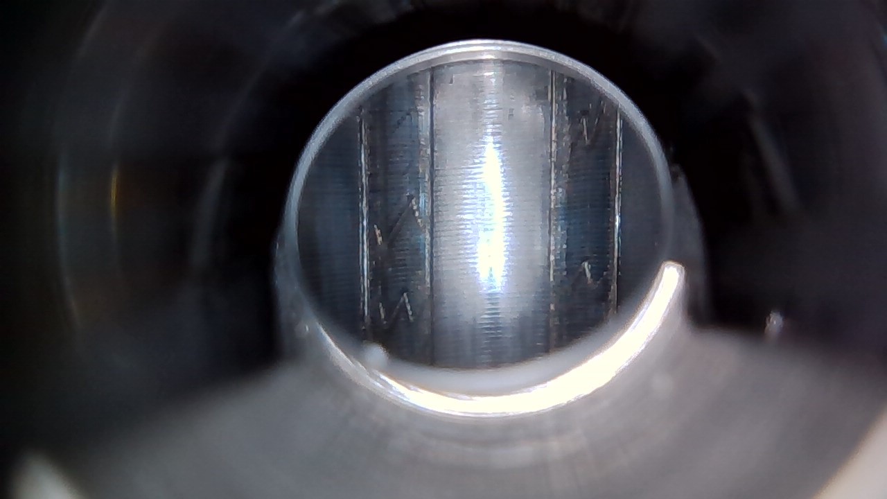

    I got a lemon of the exact same make. Best it would do was 2 MOA with anything, and usually was 3 MOA or so. After 200 rounds of trying (including handloads), I gave up on it and used the warranty.
    My CS experience with BA was awesome. I had to answer the usual "are you a dumbass" questions, but I absolutely understand why those have to be asked. I had a new barrel (can't remember if BCG too) on the way before I even sent my old one back. Put the new barrel on a budget build for my dad, and it showed much better accuracy with M855 of all things when I was breaking it in. Dad likes it. I'm satisfied with the company, but I'll probably not buy another (just no need).
    Same here. Here is the throat on mine. Replaced it with a WOA fluted SPR

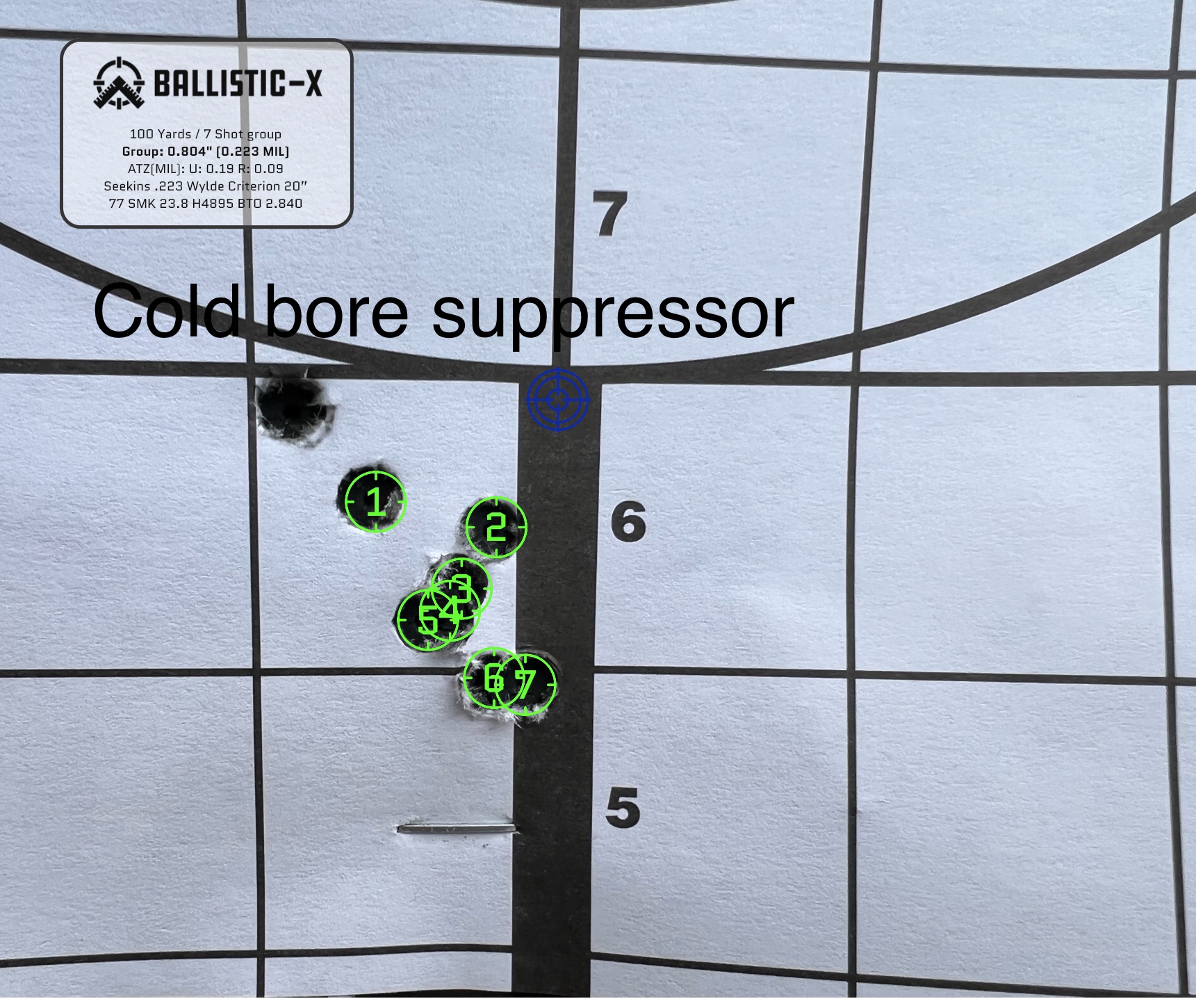

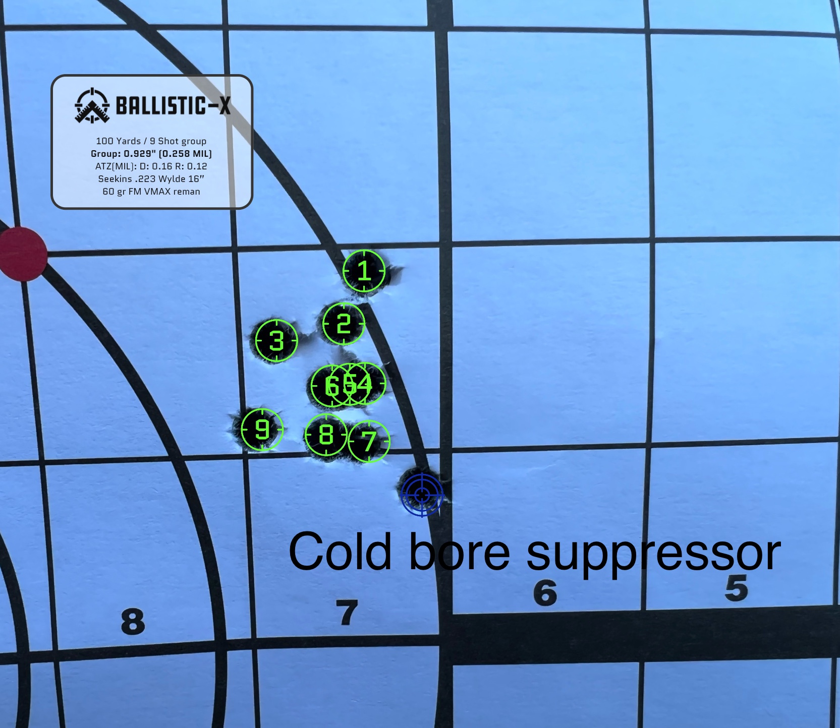

    Not a BA barrel but 20” Criterion. I do get good results from Govt profile CL BA barrels though.
    Point is, 60 gr VMAX is very accurate for me. As good as my 77 SMK hand loads.

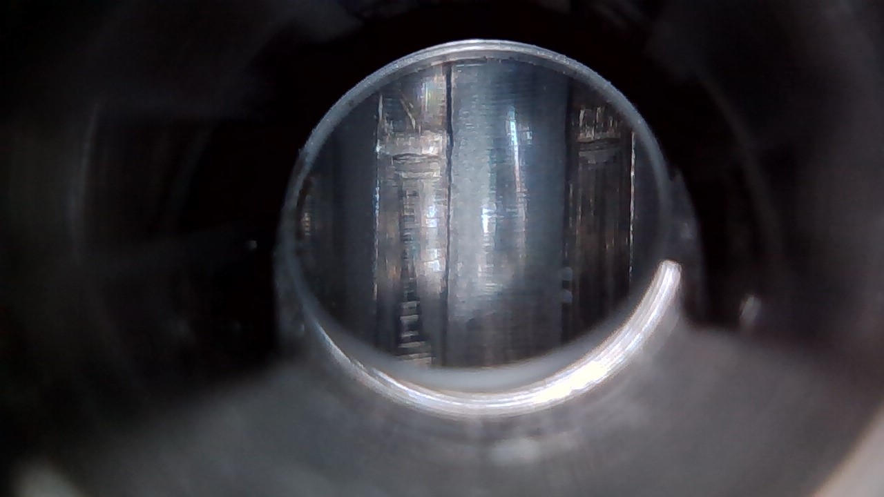

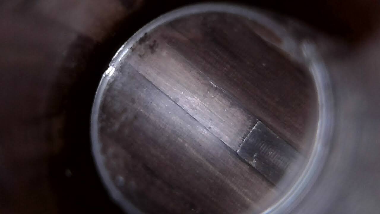

    I have the BA premium SS fluted barrel in 16", I saw the same thing when it was brand new, here is what it looks like with around 200 rounds FMJ down the pipe:
    What worries me is this, just in front of the throat, I saw a lot of "W" tool marks in the lands
    The exterior finish is pretty good, but interior, where it actually matters, is lacking for sure. Accuracy wise, it sure is capable of less than 1 MOA with my Agulia 62 gr BT or Federal 75 gr BTHP in 3 rounds group but maybe it's just the shooter, when I go to 10 rounds group I will always have a few fliers which expanded the grouping to 3 inches at 100 yards.

    Well, like I have said it didn't shoot bad, it's very capable of 3 shot within 1MOA even with non-match ammo. With I think with more rounds smoothing out those imperfection, in theory, accuracy should go even higher.

    Just ran the break in. Groups were shot at 36 yds, shots were approx 45-60 seconds apart from the first to the last, bore snaking (no cleaner) between each shot. Ammo used was factory Norma 77gr SMK. Temp was 38F. Elevation 600'.
    1st group- 2540/2560/2477/2518/2546 ES-83fps AVG-2528 Group size-1.45"
    2nd group- 2438/2523/2550/2519/2458 ES-112fps AVG-2497 Group size-0.96"
    3rd group- 2519/2511/2479/2474/2525 ES-51fps AVG-2501 Group size-0.60"
    4th group- 2516/2520/2403/2481/2507 ES-117fps AVG-2485 Group size-0.75"
    Removing the flyer from the 4th group would have made the results track more.
    4th group (flyer removed)- ES-39fps AVG-2506 Group size-0.44"

    I had the same problem with 2 of the exact same BA barrels. Both were 2-3" groups at 100 with 50gr to 77gr factory and handloaded ammo. Had to go through a bit more of a proving I'm not a dumb-ass process with them twice. On the 3rd barrel now and factory ammo is a rough inch.... maybe. Worked up a handload that is a ragged 1/2-3/4".
    I have a new 18" criterion core sitting on the bench waiting to swap, just haven't had the chance yet.
