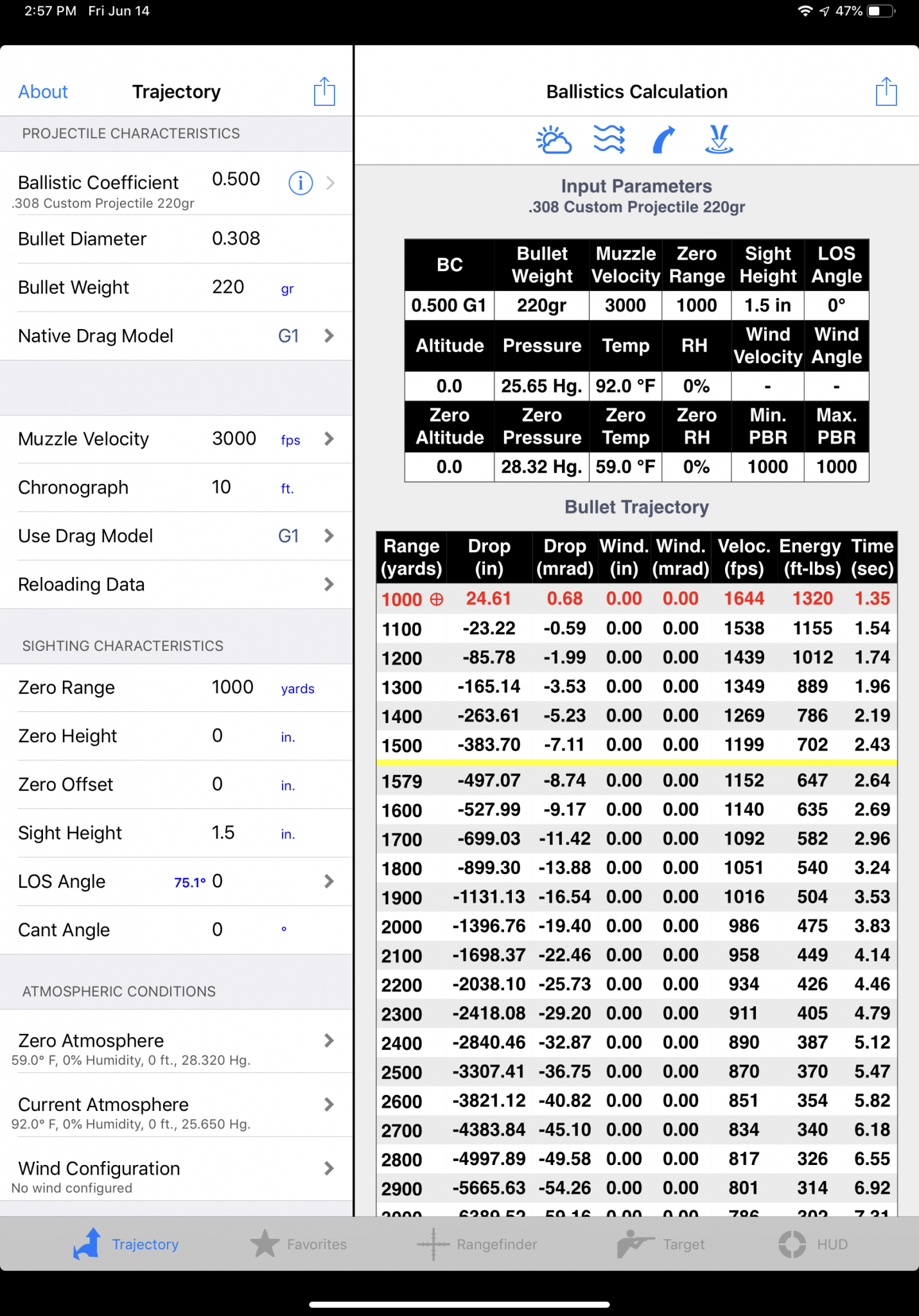

So I just used some BS stuff in Ballistic AE which uses JBM engine. I made up a 1k zero and some atmospherics and made up some Bs current atmospherics. You can see it accounts for the difference and says you have to dial .7 at 1k in current conditions

Using JBM Ballistics there's a way to read off the angle, ( milliradian ), for a given set of conditions. You could simulate the case at your home Altitude, make note of the angle, then set up a simulation for Raton and note the angle. The difference of the two angles should be what you'll need to adjust.

In CB check the DROP (not PATH) to account for the absolute differences between the two scenarios.
I would suggest that you make a second profile with a fake 100 yard zero that correlates to your 1000 yard zero.
This would create a static base line value that is for the most part free of atmospheric influence.
I would get a large target and put an aiming dot at the bottom of it, then shoot at that dot from 100 yards with your 1000 yard zero and measure the impact distance from where you aimed.
Convert that to MOA or MILs or whatever unit you work in and tweak your settings to match all other values to match between both profiles, except use the 100 yard zero on the new profile.
Then subtract your MOA offset from the drops provided.
You could then compare the two models to confirm the result is what you are expecting.
A word of caution here though... At close range the sight height above the bore will have a greater influence on your data than you might expect. So I would not change the scope height in your 100 yard model, I would just incorporate the needed MOA offset to balance it out... If you need to.
