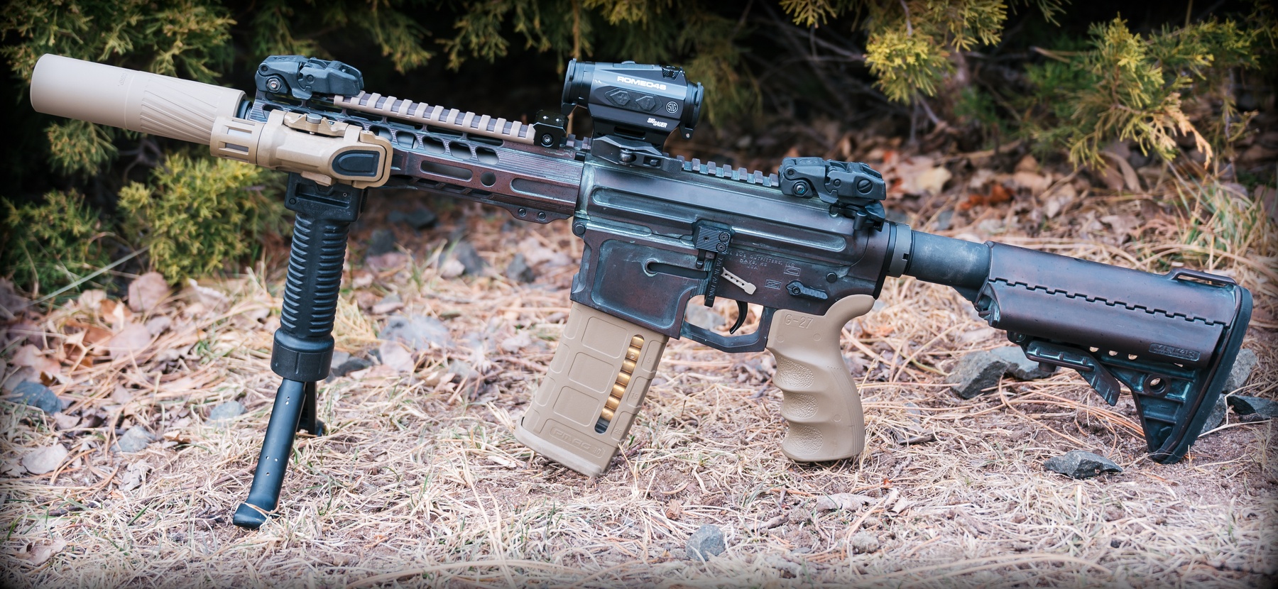

When are we, late 00's with that broomstick handle? Haven't used, let alone seen one in use in over a decade lol.
Nice rifle, tan furniture looks out of place though.
Hey now, I'm an old guy :D I assume by broomstick handle you mean my bipod grip? I think it was called the grip-pod or something like that. And since I shoot 99% subsonic loads from it, it has worked quite effectively when I need something a little more steady.
