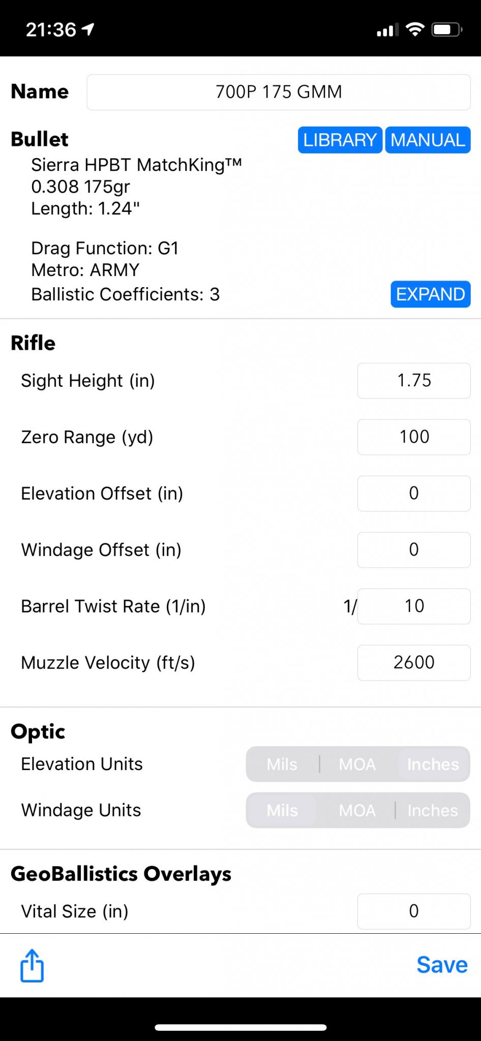

Just downloaded BallisticsARC to try it out at the range tomorrow, upgraded to the PRO version after downloading it to my iPhone.
I'm building my rifle/ammo profiles, however I keep hitting a roadblock. The MIL/MOA/INCHES buttons are greyed out on every profile. It won't allow me to pick MIL for my scope. Also, in Settings, everything is greyed out except for "Smart Buttons."
I've watched some YouTube videos on settings the profiles, and I don't seem to be doing any differently. Any idea why I can't select these?
I'm probably doing something dumb, but I'm stumped. Thanks in advance....
Of course, right after I post I figure it out. After struggling all afternoon. The buttons are 100% functional, just have no color. If you click mils, it switches to mils, etc. It's just a display issue.
Update: their tech support just responded: "That’s a bug on our part. Dark mode is greeting out the sliders. They’re still working properly, it to verify the settings you’ll prob need to switch to light mode. We have a fix in the works. Sorry about that!"
