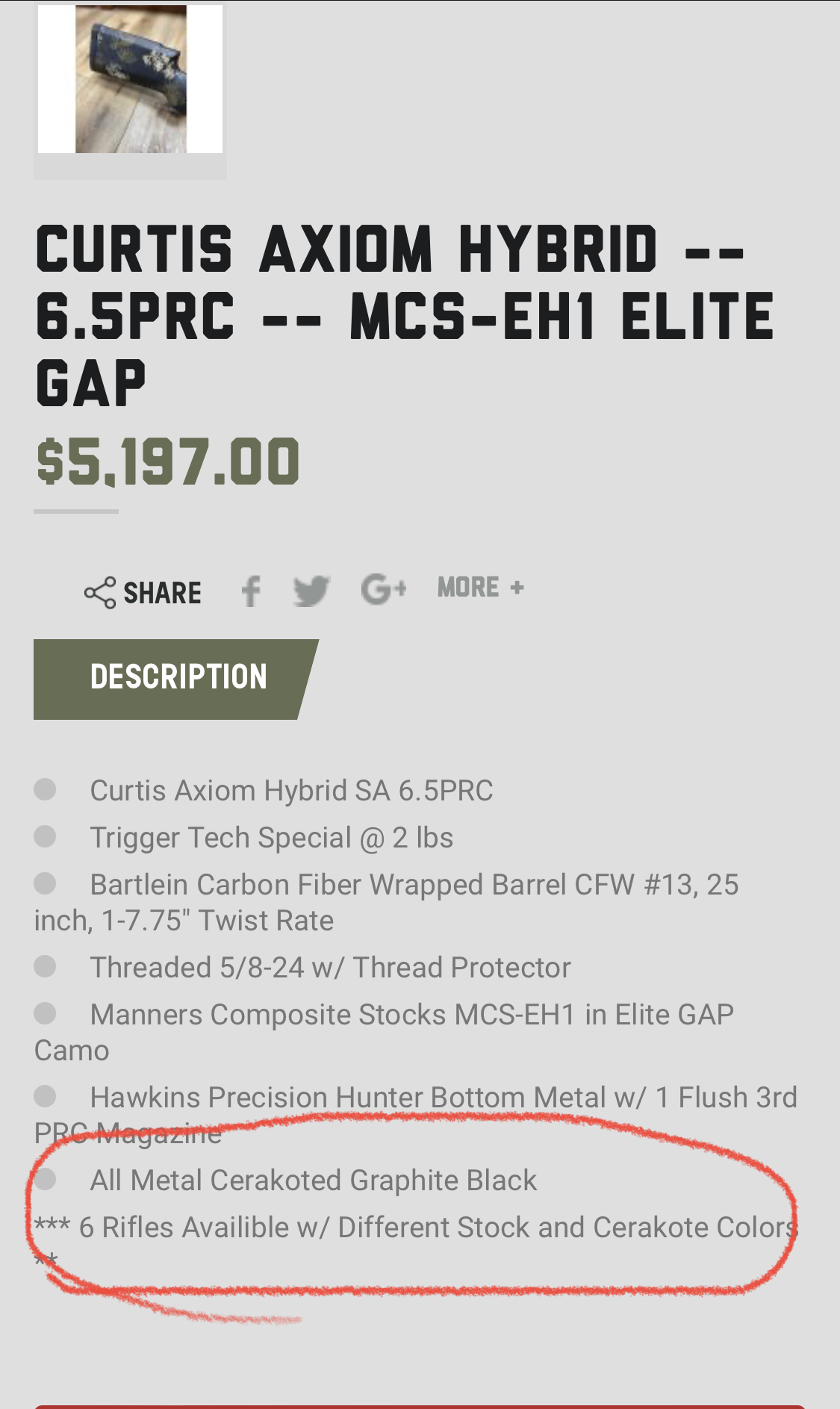

Above price range but GAP listed 6 light weight 6.5 PRC rifles yesterday.
Trying to find them, please post a link? Here's what I see on their ready to ship page:
At the very bottom of the link you posted.
Curtis Axiom
Bartlein CF wrapped barrel
Manners EH-1
TriggerTech Special
Hawkins bottom metal
$5,197
States there are six in various color schemes.
