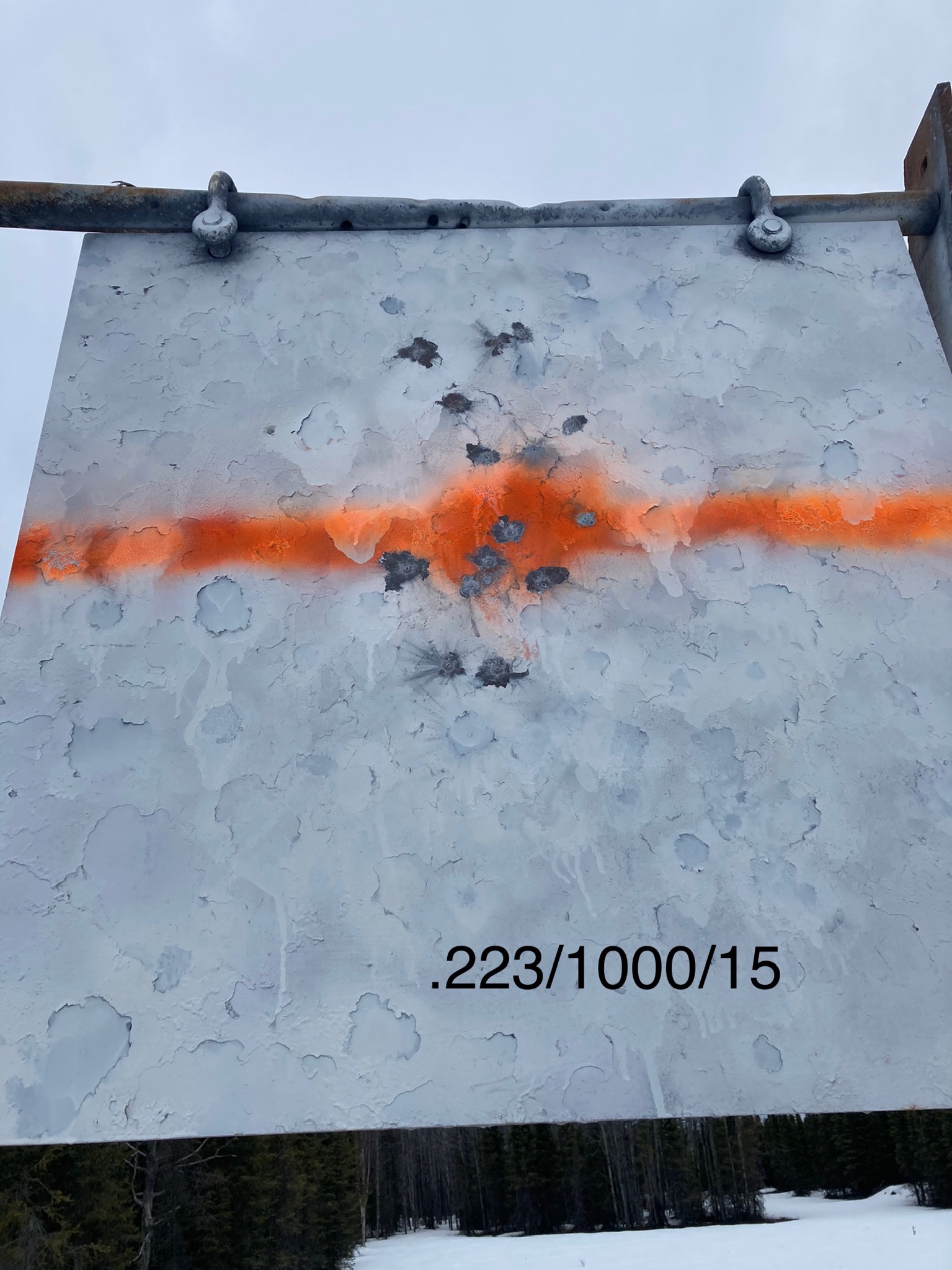

I just swapped my Proof CF for a Proof SS M40 contour. My 6.5CM is more for the bench and prone distance gun. Since I’m not lugging it around to hunt or PRS I wanted heavy as hell to watch for splash at distance. That was my thought process. Wanting light weight when you aren’t humping it 5 miles is a moot point. Heavier is better for a static shooting in my mind. Add a good break and you can watch your impact at almost any distance.
I shoot a lot of .223 at distances of 600-1000 yards. I prefer a 30 inch 1:7 heavy Palma or bull barrel. I’m shooting 90 gr. At 2750 FPS. There’s a very informative article called Mouse On Steroids. I’m just a plonked but here is here is a picture of two groups at a thousand.
