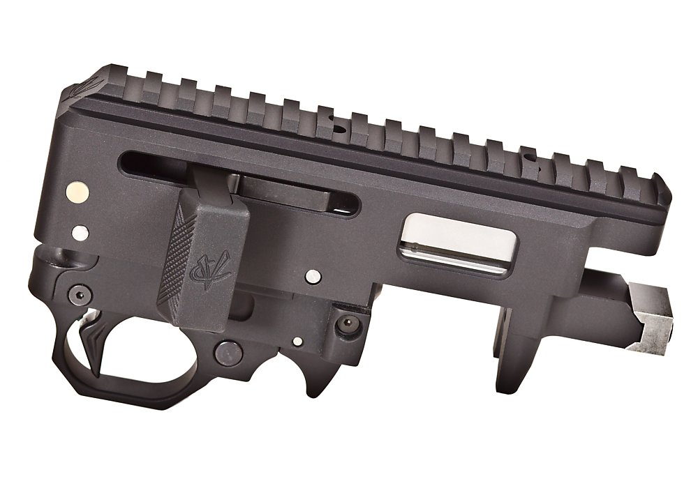

I’m starting a 10/22 build based on a Volquartsen/Summit straight-pull receiver. I’m trying to build something that at least superficially resembles a toned down biathlon rifle. I’m new to 10/22 builds and the choices of barrels, stocks, and triggers are truly bewildering. Leaving stocks aside for now what barrel and trigger would be good choices? I’m currently looking at an ER Shaw threaded bull barrel, a Tactical Solutions thumbhole stock, and a Volquartsen trigger guard. I’m open to other suggestions, but I’d like to stay at or under about $1100. I have $550 in the receiver and bolt. The Volquartsen trigger is $225, the ER Shaw barrel is $100, and the TacSol stock is $200, putting me at $1075. I’ll add links below to the items I’ve referenced. I already have a Savage Mark II that will easily shoot sub 1/2” groups at 50 yards and I’d like this rifle to be capable of the same..I just like the idea of the straight-pull action.

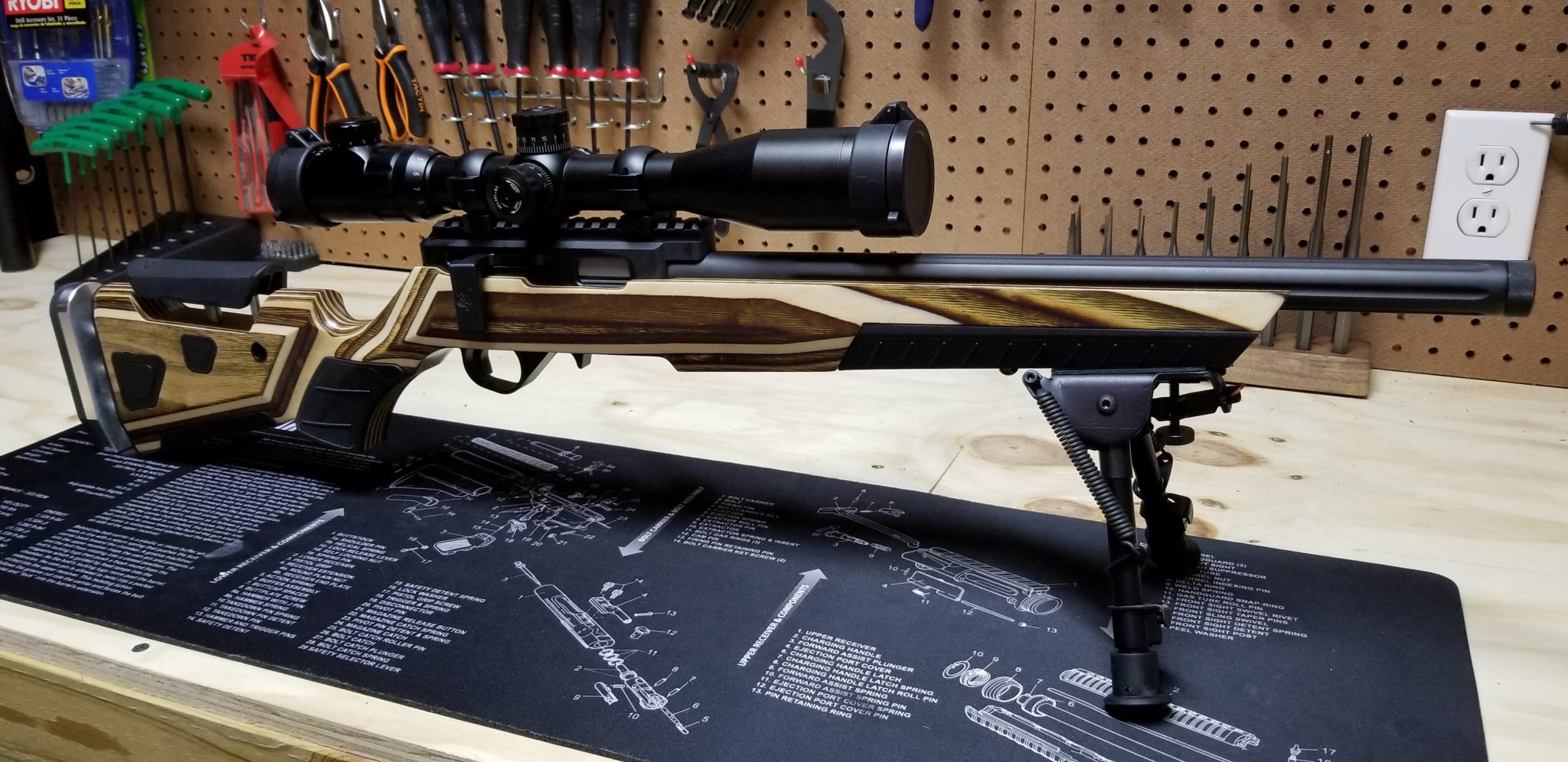

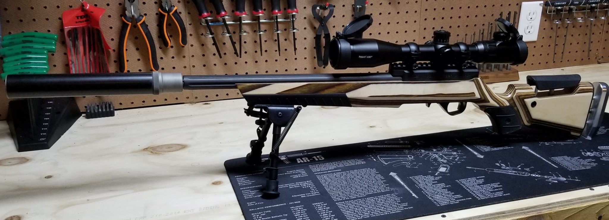

For a barrel if you want the best check out Mullerworks may be a considerable wait though as they are considered by some to be among the finest rimfire barrels in the world. I went a completly different rout on my 10/22, I had allways wanted one and when they came out with the 50th anniversary model I bought and built off of that with a Tac Sol barrel, Hogue overloaded stock and the Ruger aftermarket trigger. Its a very light and handy rifle with a 3-9 power scope on it.
That is really slick looking rifle by the way, just a heads up but if you havent allready tried it the SK Standard Plus ammo is more accurate than R100 and rivals R50 in my Tac Sol barrel and is a much better price.
Rifle turned out great. I am a fan of the coyote laminate, have one myself in the boyd's pro varmint. Looking forward to range reports and maybe a review thread on the AT-One stock.
