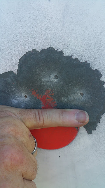

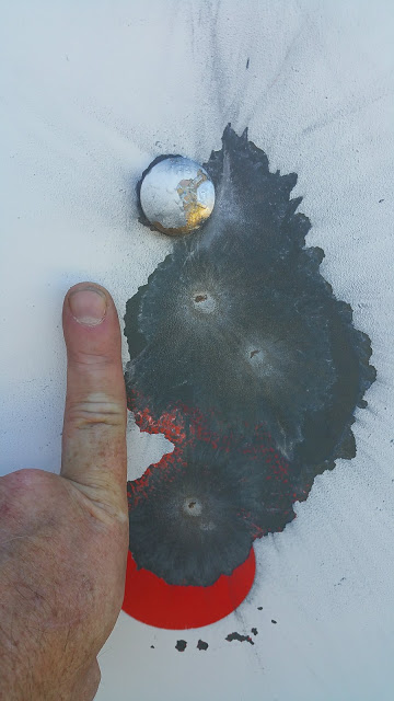

Yes, those are some the best groups of my three favorite rigs. You asked for one-hole groups, there ya go. Sorry for being a dick.
Ditto, not really any substance to anything I said or anything that would help anyone. On the other hand you put some good info out there. And posted some nice groups. Sorry.
