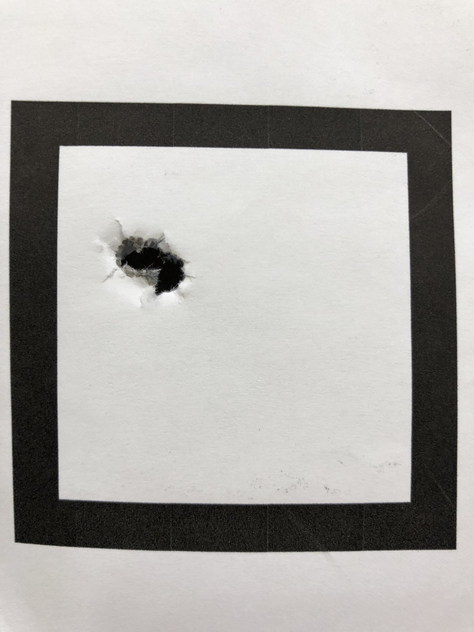

    I chambered up a 6 creedmoor this week. One round on steel from a bore sight. Here are rounds 2,3,and 4. Just shoot it.

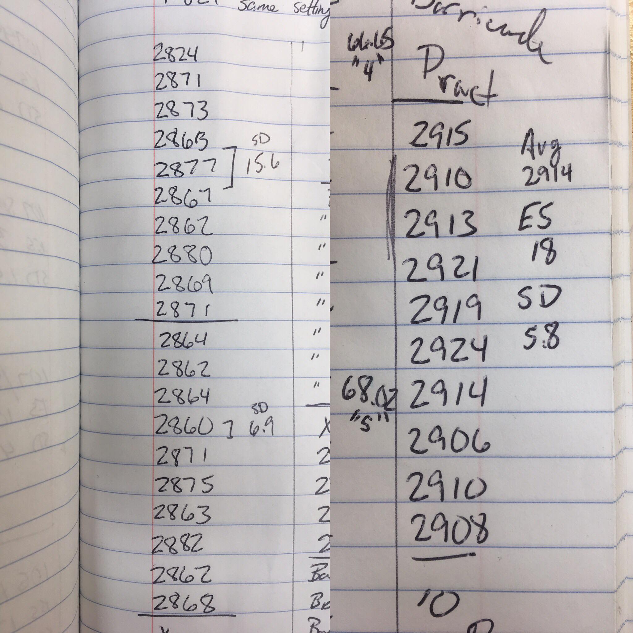

    FWIW... here is what I'm talking about with velocity. Granted there is some cleaning involved, but you can see that it still sped up and leveled off and got way more consistent. I clocked the first 20, and the last 10, of 144 rounds of a thrown together load in virgin brass.
    Don't worry about break in, worry about getting 100 to 150 rounds down the barrel so it has sped up and settled for velocity.
    Sucks to go to a match and all of a sudden half way through they day you're missing high on everything because your barrel is now shooting 75fps faster and all that dope you gathered is wrong. Seen it happen to a lot of guys.
